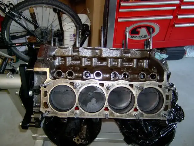

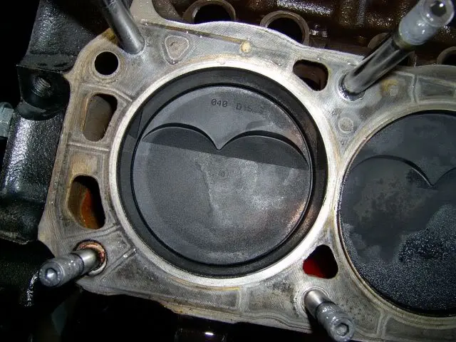

My engine is officially toast, take a look..lots of pics
I finally got the balancer off, and the timing cover and timing chain have been removed. I'll have more pics up tomorrow. I'm gonna be buying new lifters, but re-using my rockers / pushrods. Do I still need to keep them organized, or can I just box them up?

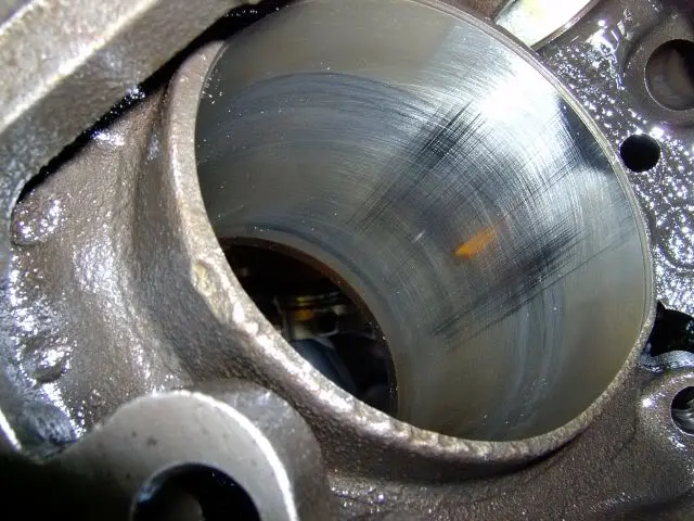

Cam bearings look OK

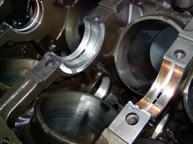

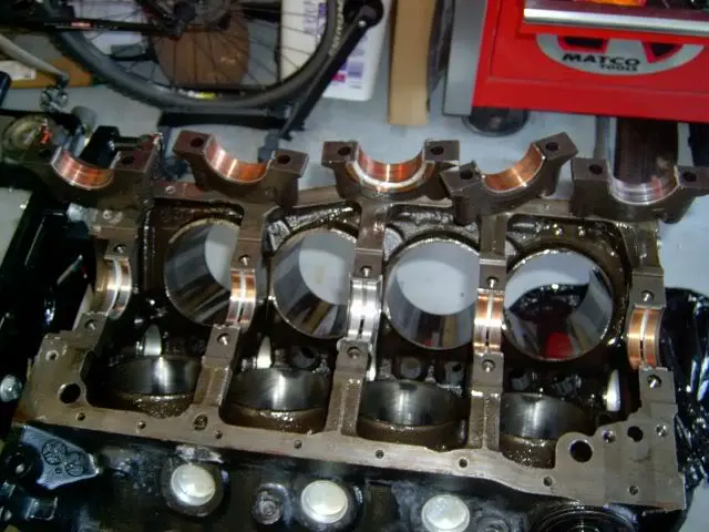

Upper thrust bearing looks fine, but the lower is completly gone. Also the upper rod bearings wer showing some copper, but not the lowers
Brown spot is a reflection

It looks that way. When I pulled out the bearings they are marked u-020 on the bottom.
Any opinion on what may have caused this? Is it unusual to only have one have of the bearing worn and the other half be OK?
Hey Rick, when using a main support, does the block have to be line-honed with the support bolted in place prior to assembly? I installed mine after the fact. Could this have led to this problem?
