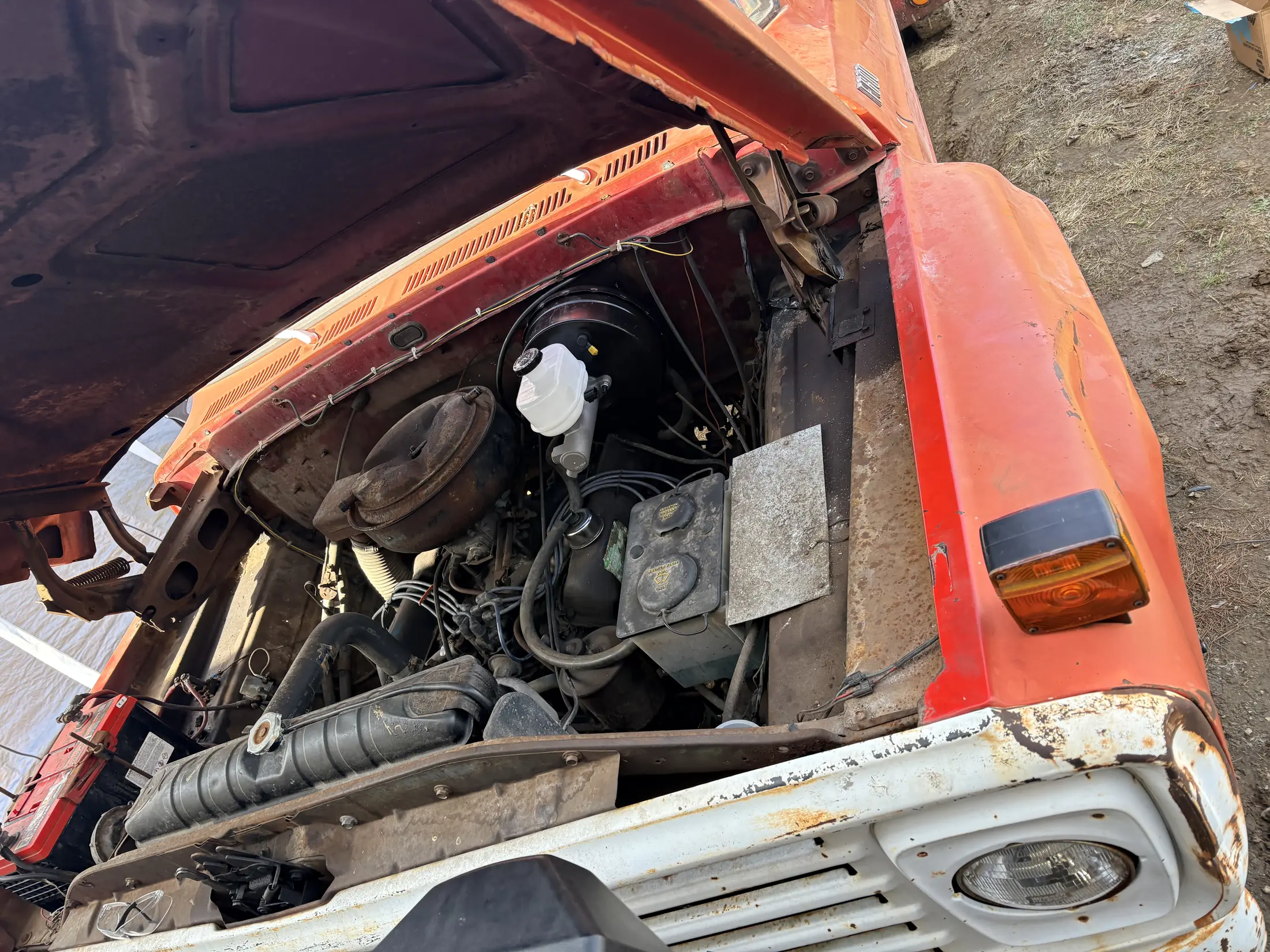

The Bad- it got parked because it needs the frame mount vacuum brake booster replaced-and it’s basically unobtainium at present
The 2150 Carb needs gone through and the old fuel drained out, but hopefully I’ll have it home in the next week or so
I know nothing about those boosters, but is this it?
It at least looks similar. :shrug:

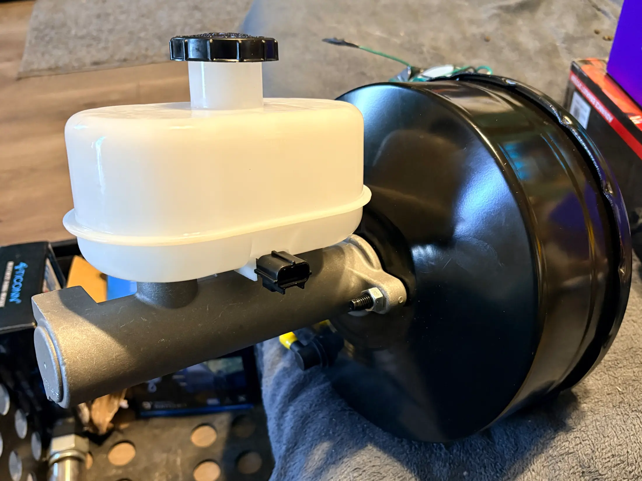

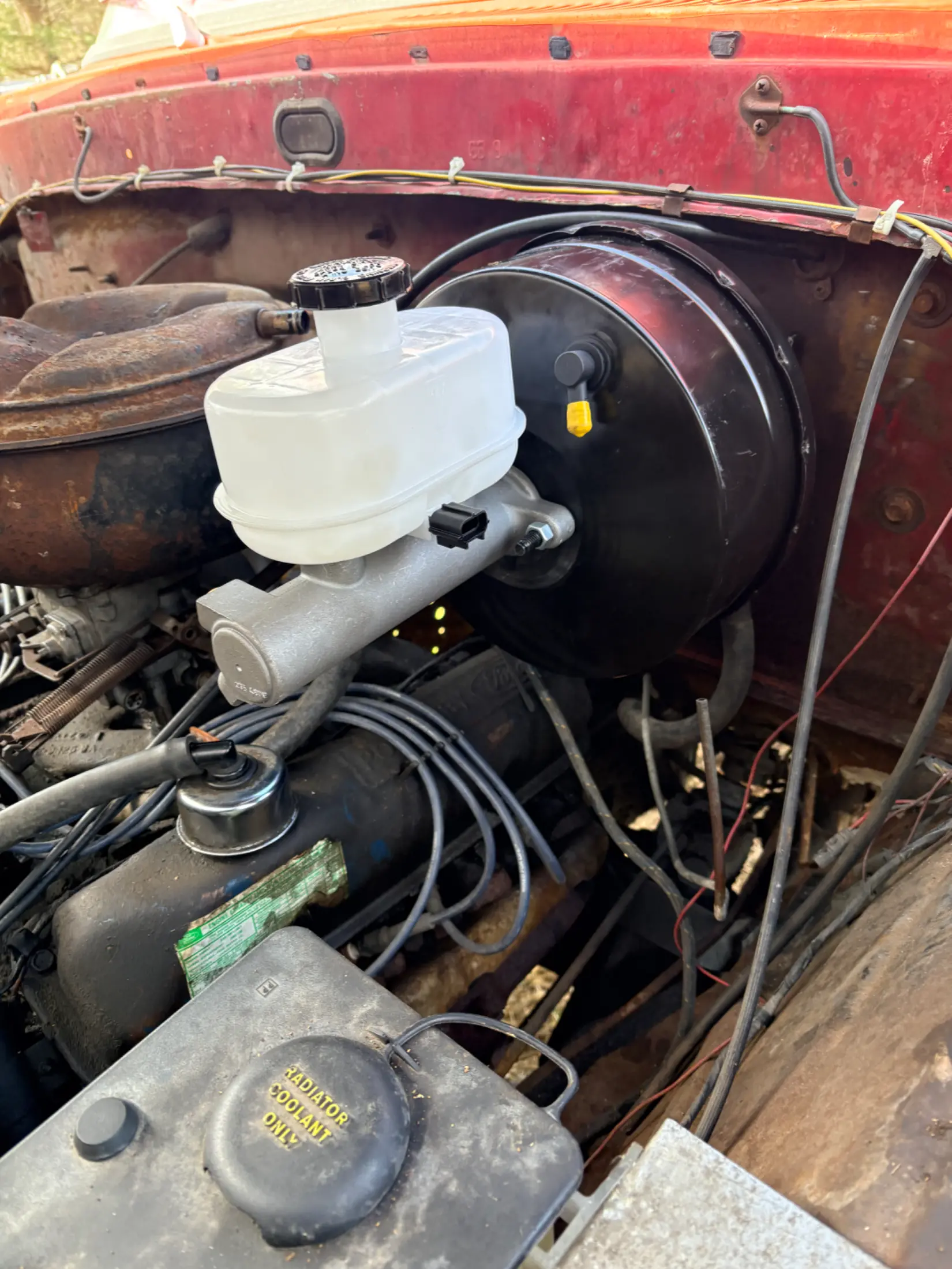

Update: After the used booster turned out bad-I bypassed it. Manual brakes on this truck is pretty stupid,so I barely used it last year.

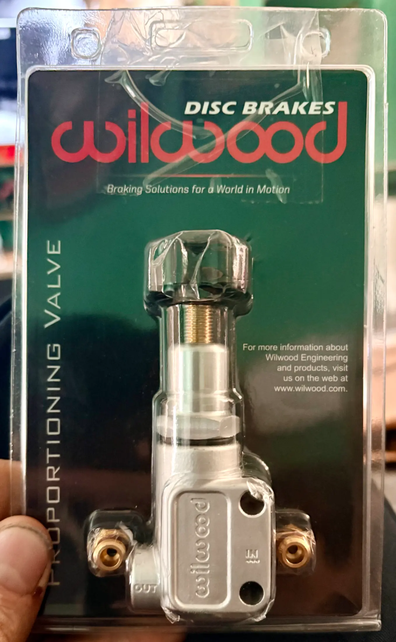

Found a company that makes an upgrade kit-decided to not pay what they charge for the kit and bought the modern Booster and master cylinder- combo valve etc. when the weather permits. I’ll have power brakes again
