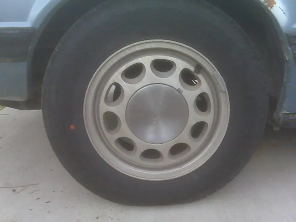

just taking 1 of your pics, again this is a pretty decent project..
if you look at the lower leg of the quater where it meets the rocker you have a decent amount of rust right in the seam, and a heavy amount of rust at the rear corner of teh rocker and the lip of the wheel opening facing towards the door side. The wheel opening is a double panel..inner wheel well and outer quater spot welded together. this area is going to a little tough for a do it yourselfer with little experience but if not done right it is going to come back for sure. just try and lay out the best plan you can, do some research on doing body work and only do what you feel comfortable with doing.
