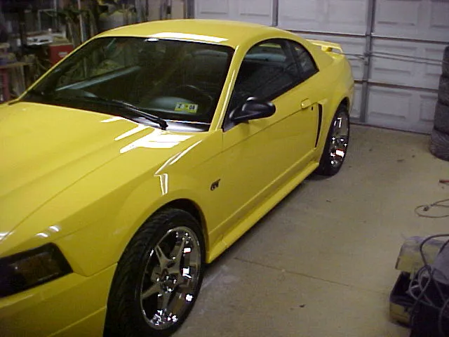

Looking good man....get that thing color sanded and buffed out now. Nothing like a good color sanded and buffed out paint job. Here's a pic of mine I did in my garage.
