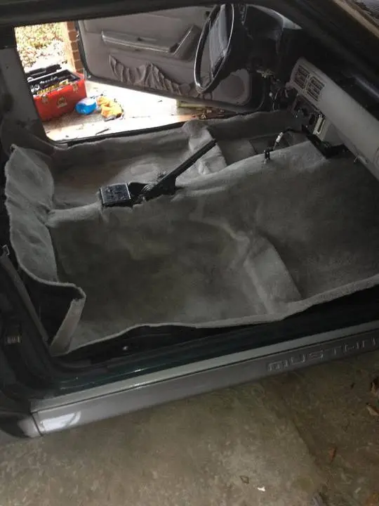

Update. I got behind on this project because I had to abruptly move, that took up most of my time off in November. Fortunately I wound up in a better AND cheaper place! This time with a roof over the stangs head. I recently managed to get the first layer of sound killing on.

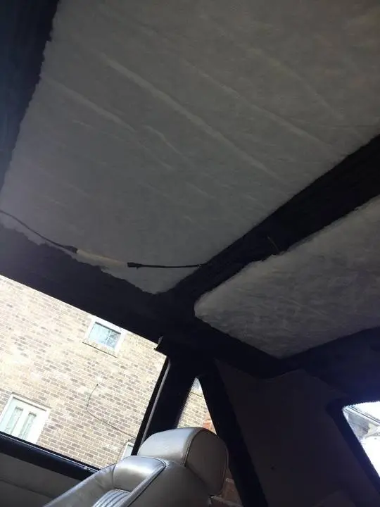

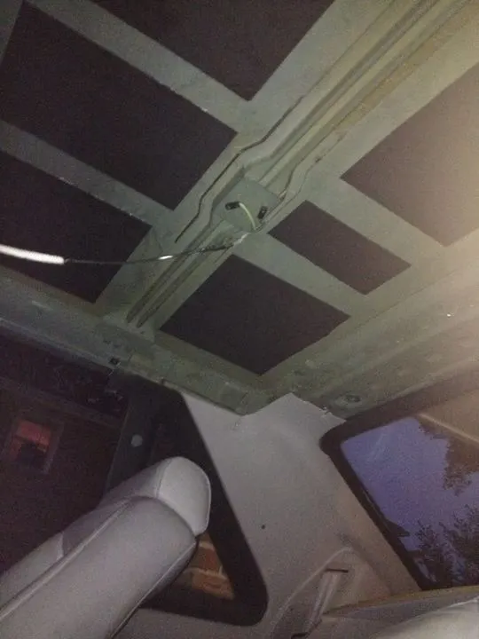

I would put some dynomat or similar on the roof before you install the headliner. It will make a noticeable difference in sound level and help keep the car cooler/warmer in the respective seasons.
This is the 3m thinsulate stuff. DONT have gloves on when installing because when you slide your hand across it will shred it. Also use fabric scissors for trimming. I got lucky and the scrap off the front cut fit well enough in the back. I have enough left over to do another roof. I will probably use it somewhere on the car. I have this and plenty of damplifier left over so it will spread through the car.
This stuff is used in high end convertibles to keep sound levels very close to their hard top models.

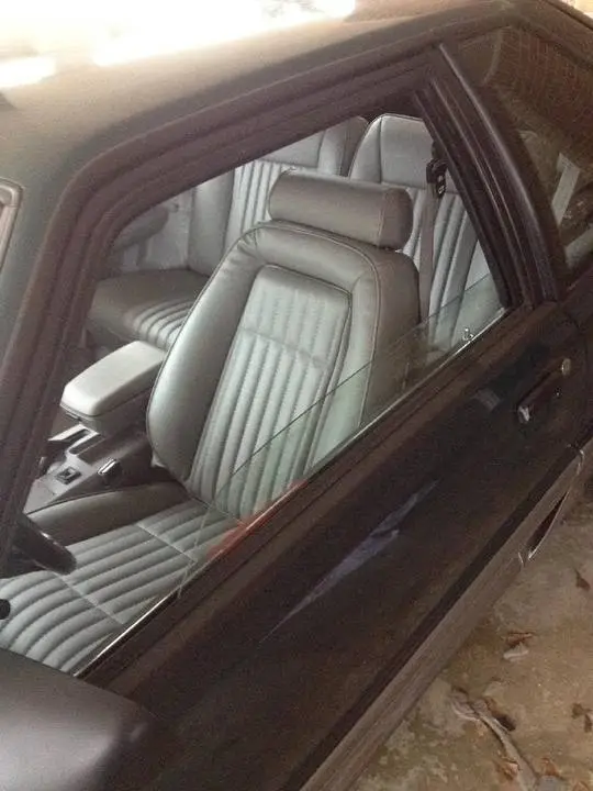

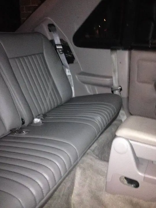

Still not complete but I am headed there. I'll have it at the Flag City Mustang show in Macon on March 29th so I've been pouring my time in this. It looks like I rushed some paint! (The door panels haven't been touched yet) There is a color difference between the ARMREST plastic and the CONSOLE itself. It looks terrible in that backseat pic...

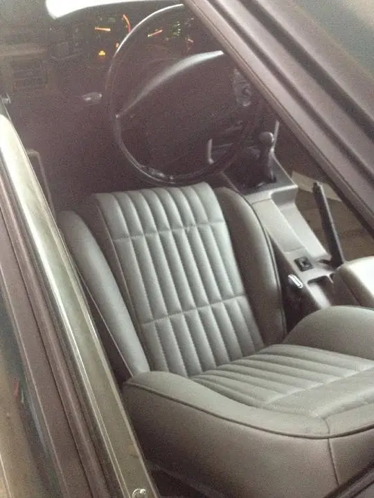

I used new foam in the driver seat and I have actually lost some comfort, it's almost too big now. My head hits the headliner and is hard to find the best adjustment setting. The upholstery shop may have made an error on install, I didn't like their overall work anyway.
It smells new though.
