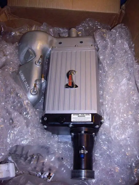

My new blower showed up!

Looks good. Do we know if its going to clear your stock hood yet?
Supposedly it will. There are 5 other KB Marks ive looked over and all of them cleared on the Gen2 versions. One guys didnt but I think that was cause he used the stock throttle bracket instead of making one to fit the car. There is some minor cutting of the rear brace on the hood but thats it. :shrug:
Didn't you say this was a custom 2.2L compressor set up though? The bolt on Cobra kit that the other Mark VIII use, utilizes physically smaller 1.7L or 2.1L. Think you're going to have issue with the taller compressor. I know when the 2.2L came out for the 2V, it wouldn't clear the stock hood line like the 1.7L would? :shrug:
KB said the case height is the same.
Height, yes. Length, no.
The 1.7L that the kit originally comes with is 257mm long. The 2.2L is 304mm long. From what I recall, there were a few who had issues with one or both of the front corners of the case making contact with the hood reinforcement straps. You may be able to trim some of the area away, or remove it altogether (compromising hood rigidity), but don't be surprised if it makes contact.
