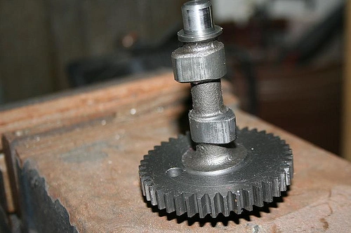

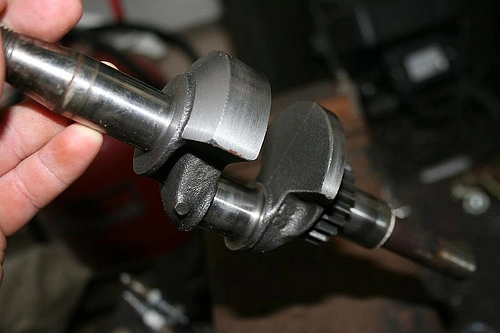

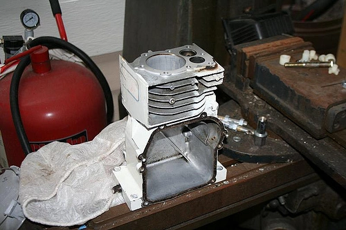

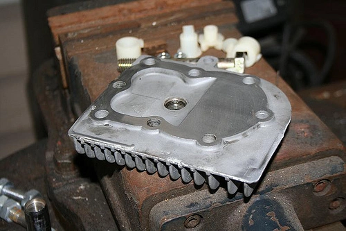

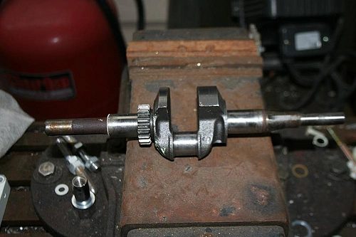

Well me and Putnam88 picked up one of those pockets bikes from a kid we know. We decided to do an extended swing arm and put a different motor in it. We extended the swing arm 12" and remounted the rear suspension on it. For the new motor, I had a old 2 HP Briggs motor laying around. We decked the head .050 and Decked the block .010. We lightened the crank by turning .250 off the counterweights and also knife edged them a bit. For the cam we are going to check the piston to valve clearance and see how much we can increase the lift on the lobes. We also can grind on the side of the lobes to make the ramp rate higher. Should be a nasty little 2HP motor. We have it all done except the Cam work and the new motor mounting plate. Well here are some pictures of the creation.
