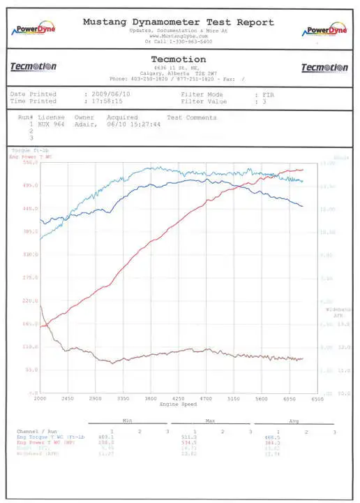

Custom Tuned by Matthew at Tecmotion on Mustang Chassis Dyno
HP: 535 RWHP

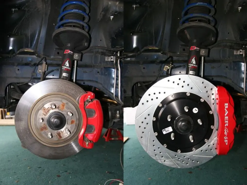

Baer Pro-Plus front brakes - 14" two-piece rotors with red 6-piston calipers
HP: 535 RWHP
Torque: 511 ft-lbs
