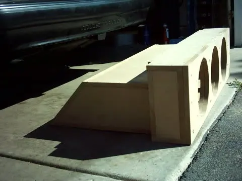

lol, looks good! My sub enclosure BARELY fits under the factory torsion bars...might have to look into those struts one day!

thats nice, i built my box around the bars
