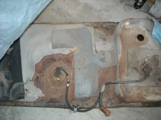

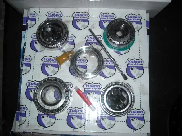

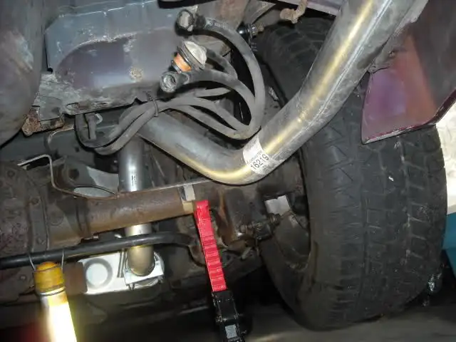

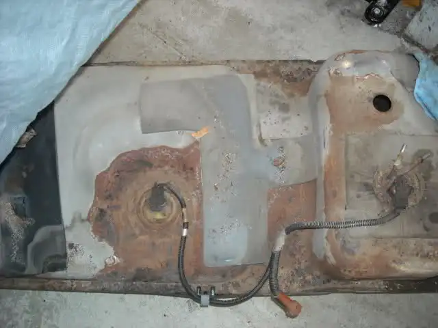

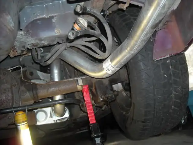

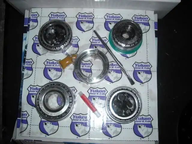

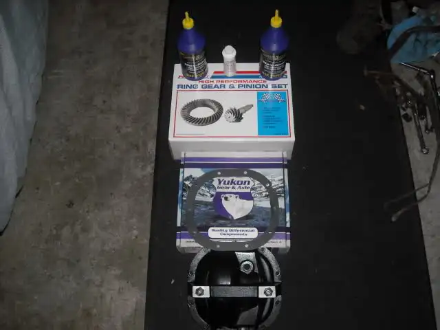

Well everyone car is in storage and im starting to tear stuff out to replace. Today i started with the gas tank. I will be also pulling the rear end to clean up under the car and paint everything...Also got 3.73 gears goin in the rearend... not many pics but heres a couple to start.
more to come stay tuned ladies and gents :D

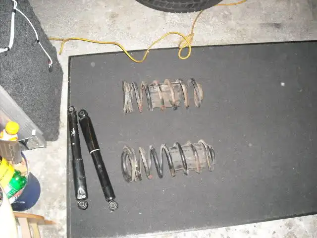

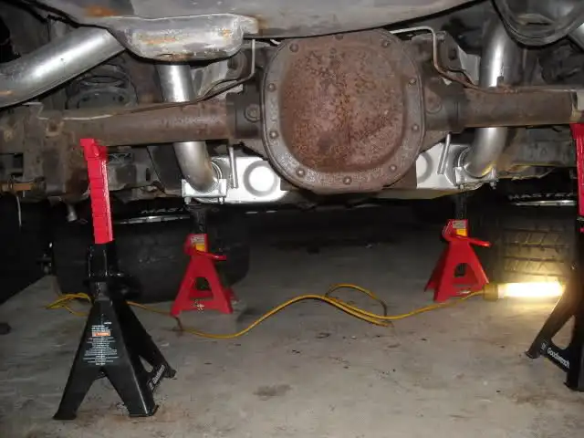

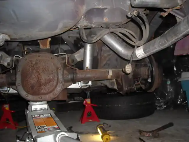

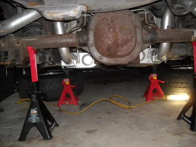

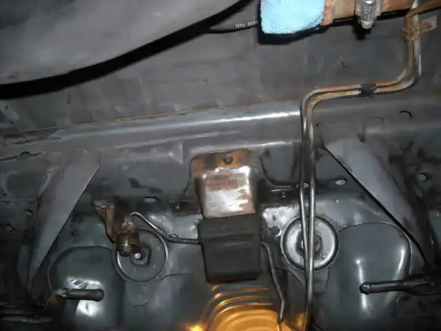

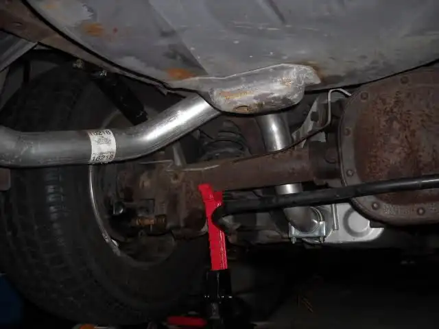

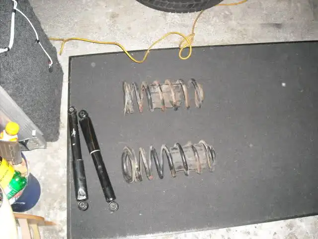

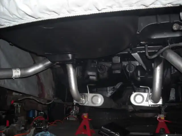

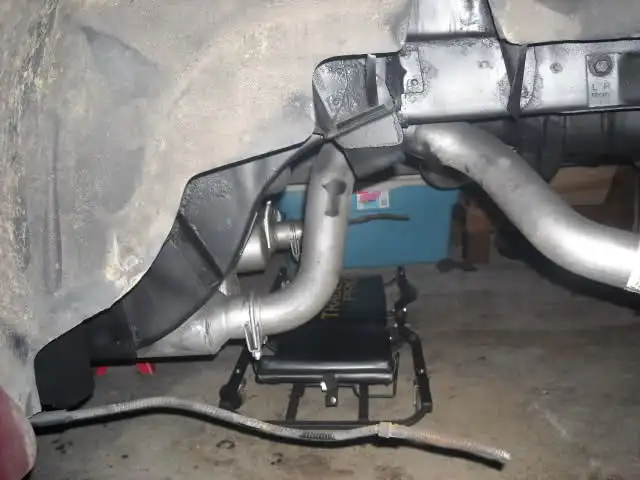

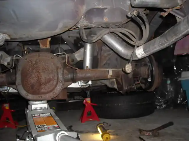

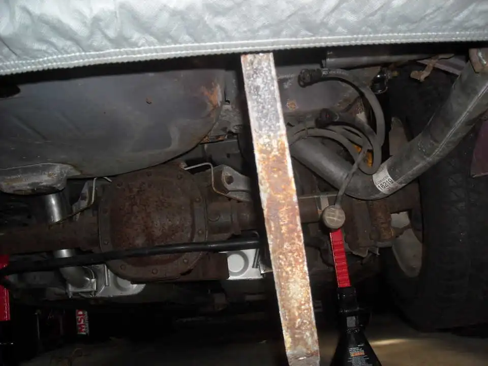

Did some more work today.....Shocks,Springs,Sway bar,quad shocks..are all out..im gonna work on gettin the damn control arm bolts next week....Stay tuned everyone
Its gettin there..:D

the control arm bolts can be a PITA. do yourself a favor. do the lower controlling arm bolts first. and still be prepared the beat them out of there. SOAK them in PB blaster. i can almost bet yours will be the same as mine were and the selve rusted to the bolt. ( heat helps )

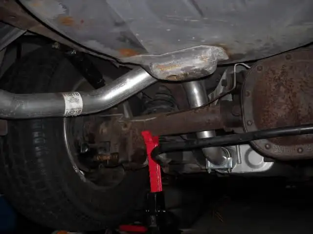

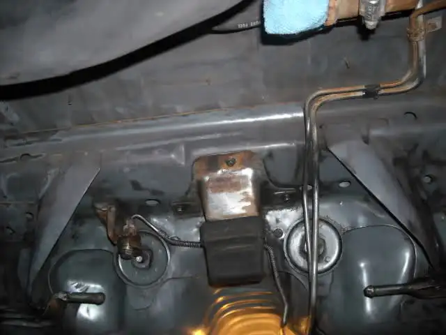

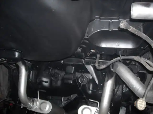

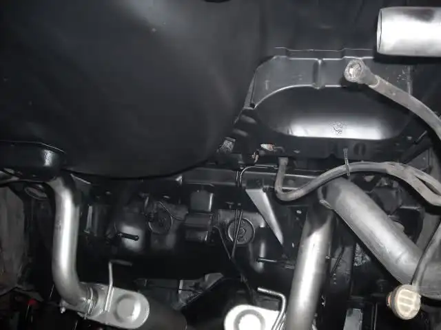

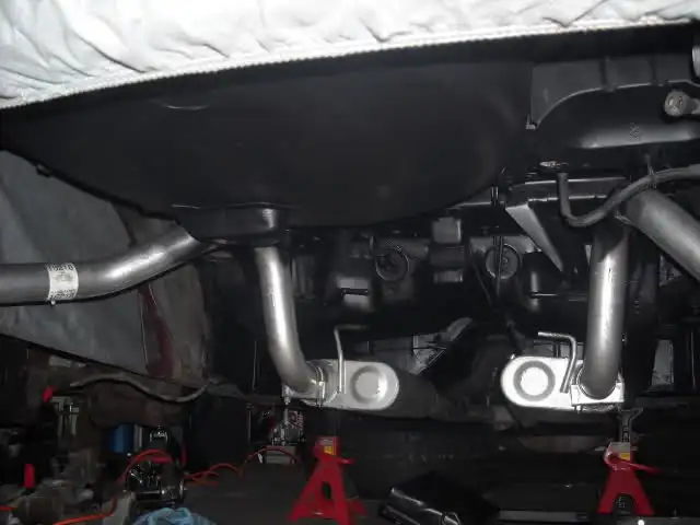

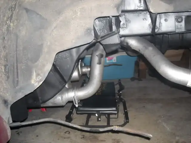

Well i been workin on cleaning the chassis heres some progress pics for ya
After 1 coat of primer and one coat of flat black paint....2 more coats of paint tomorow.
Should i paint the exhaust black too??? what do u think?

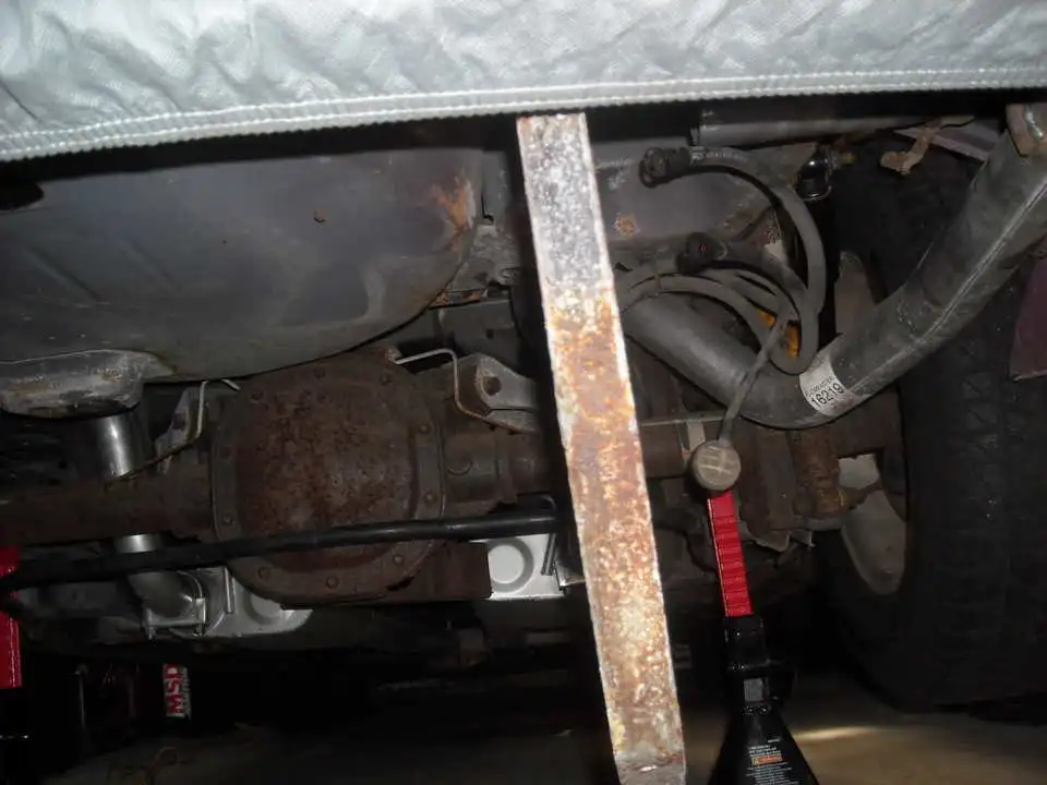

And i got the upper bushings out...what a pain those were

Wow!!! That looks a million times better... U are making great progress bro...Keep up the good work.:nice:
I can see that Mass is pretty rough on cars, yours is a clean example though....
Thanxs man i been bustin my ass on my back..Almost done..yeah mass is pretty bad..i dont drive it in the winter...im doin it just to clean it up and make it look good...plus it gives me something to do.
I was gonn say....don't lay on the bare ground. I usually lay a double peice of carboard and a nice blanket. Once, I did an H-pipe on my back and the bare cement....ah man...the next day my shoulder blades were sore as all hell.

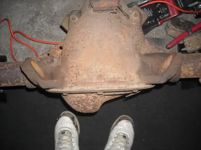

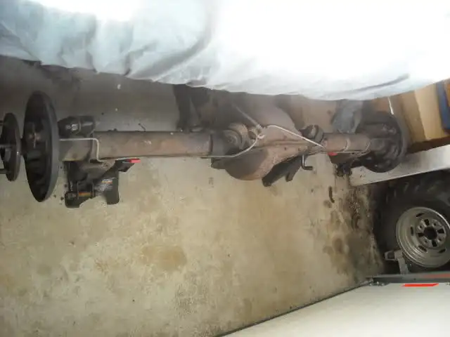

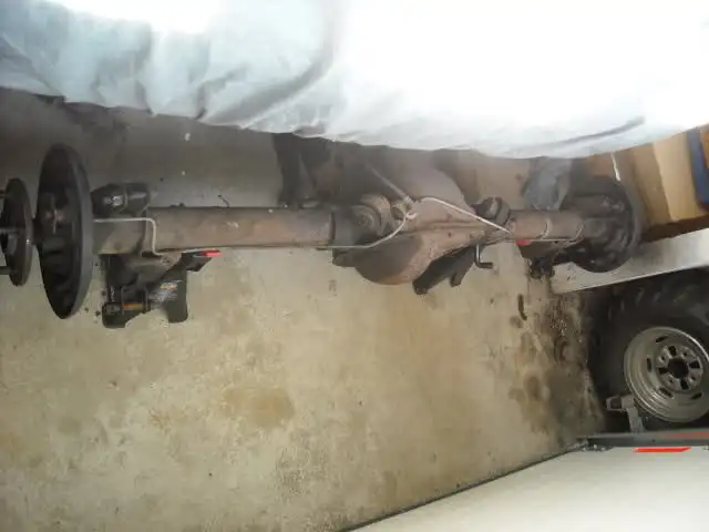

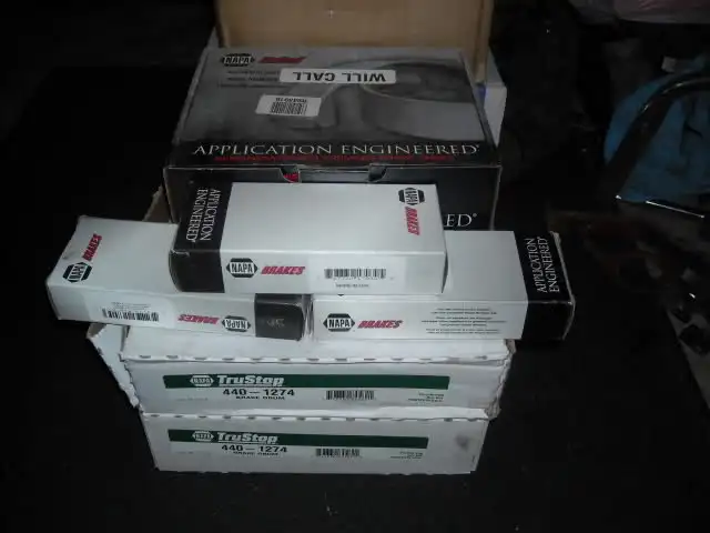

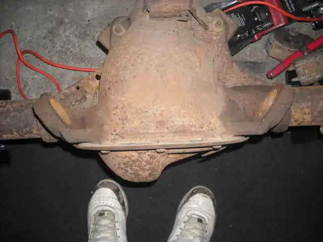

Im going to drop the rearend off at my mechanic tonight..just an update and a few pics
I know i shouldve gone disk...but i cant afford it right now...down the line ill swap swap it over
