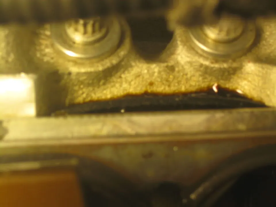

Take the cap and rotor off. Is there a pile of tiny metal filings sitting in the bottom of the diz base?
Like this?
I took a video of it breaking up awhile ago but for some reason its not on my youtube or my photobucket. I'll down load it again and post it up.

Its gotta be your diz. Mine looked kinda like that when I changed it out. Not necessarily a legit pile of shavings, but scattered metal shavings throughout the base, which is what your pic looks like. Get a remanufactured diz and see what happens. Guarantee that is the problem.
