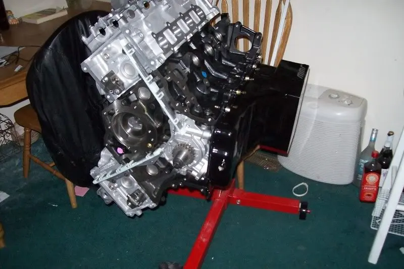

need a little help guys
i dont want to sell it but i will if i cant see an end to all the money i am dropping in this thing
anyways i got the mmr900 shortblock in the car .
the guy that put the motor in said he was having trouble getting the clutch to engaged after he reconnected the tranny and the motor..
since he was a friend of my brother and dropped the motor in for me for 300 bucks i was like what every i will just have the transmisson shop check that out maybe a pilot bearing or some thing simple
will now they are saying they have the same problem the clutch is not engaging and maybe the flywheel is to large or the tranny is not made for the motor...:eek:
so looks like i will be paying for some kind of labor and a still not fixed car... this is really pissing me off
i called mmr and they said the motor should connect up like stock only difference is a 8-bolt flywheel instead of 6-bolt...
i really dont want a new car with car payments and i have put some money into this thing (mmr900 shortblock 3800,sq-trim vortech 3900,k-member.a-arms 650,ect).....
any help would well needed.....
