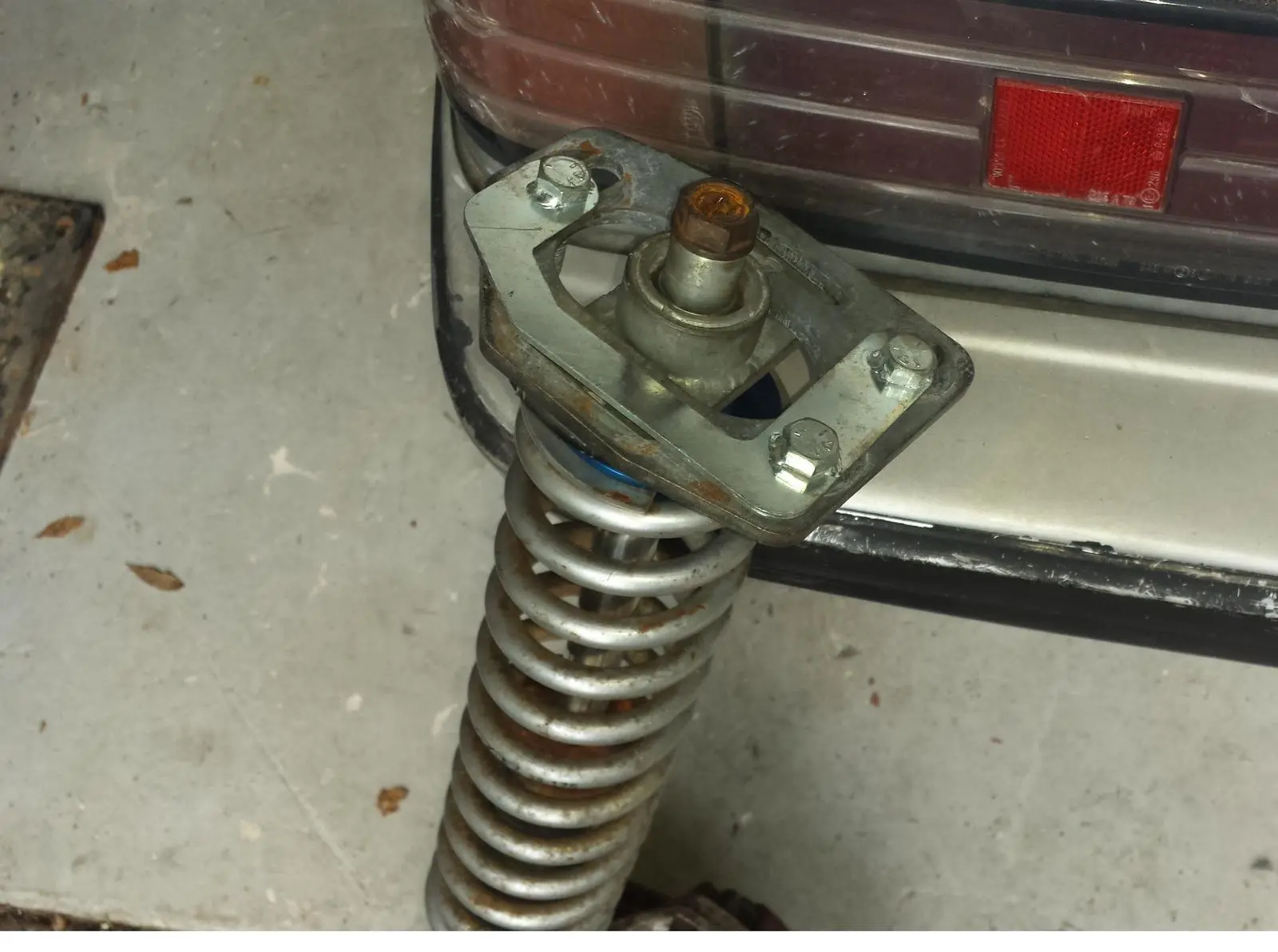

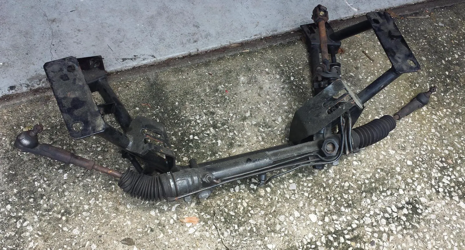

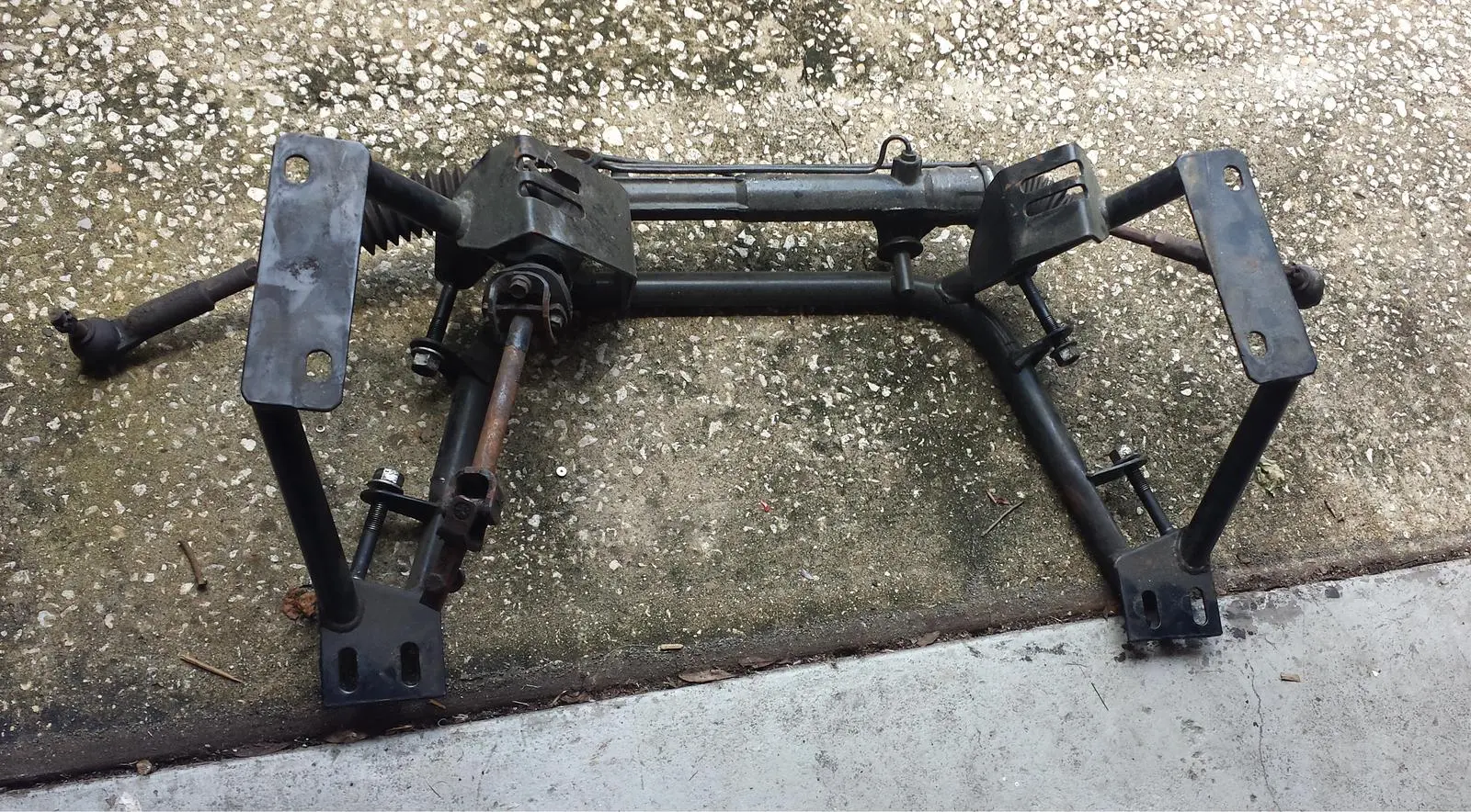

I know that the pictures are bad, but can anyone here identify if it is in fact a Steeda K-member?

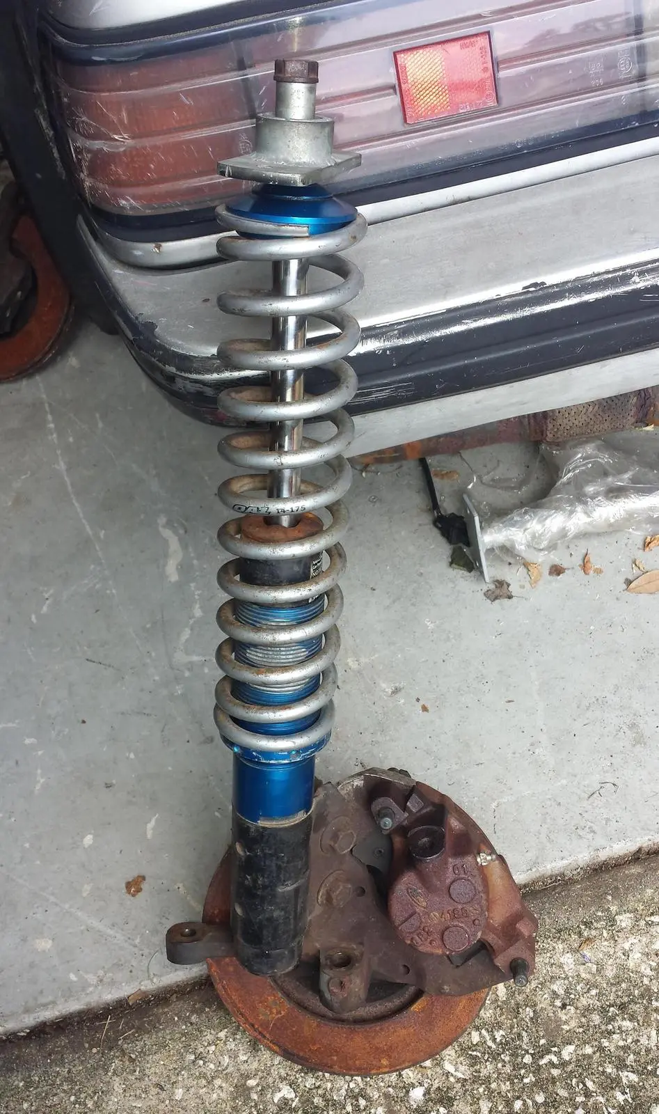

Also, can anyone Identify which coilovers these are?
Last question, the tubular A-arms are 94-95 UPR. Will these fit without any major camber problems?
It all came with caster / camber plates. But I just want to be sure everything is going to bolt up without any issues. I need to be prepared because this is my daily driver.

After looking at the coilovers, they look like sleeves over factory style shocks. But they are QA1 springs.

I'm not certain but my $.02, that's a QA1 Kmember. Most coil over kits are sleeves that slide over oem style struts. They tend to rattle unless a kit comes with padding between sleeve and strut and torrington bearings for the coil at the top.
