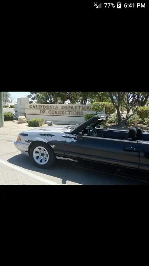

sup everyone I have a problem with my 93' lx automatic v8. it shut off on me while I was driving and I've been told its the computer there's power it turns over but it will only turn on with the starter spray then it'll shut off?
