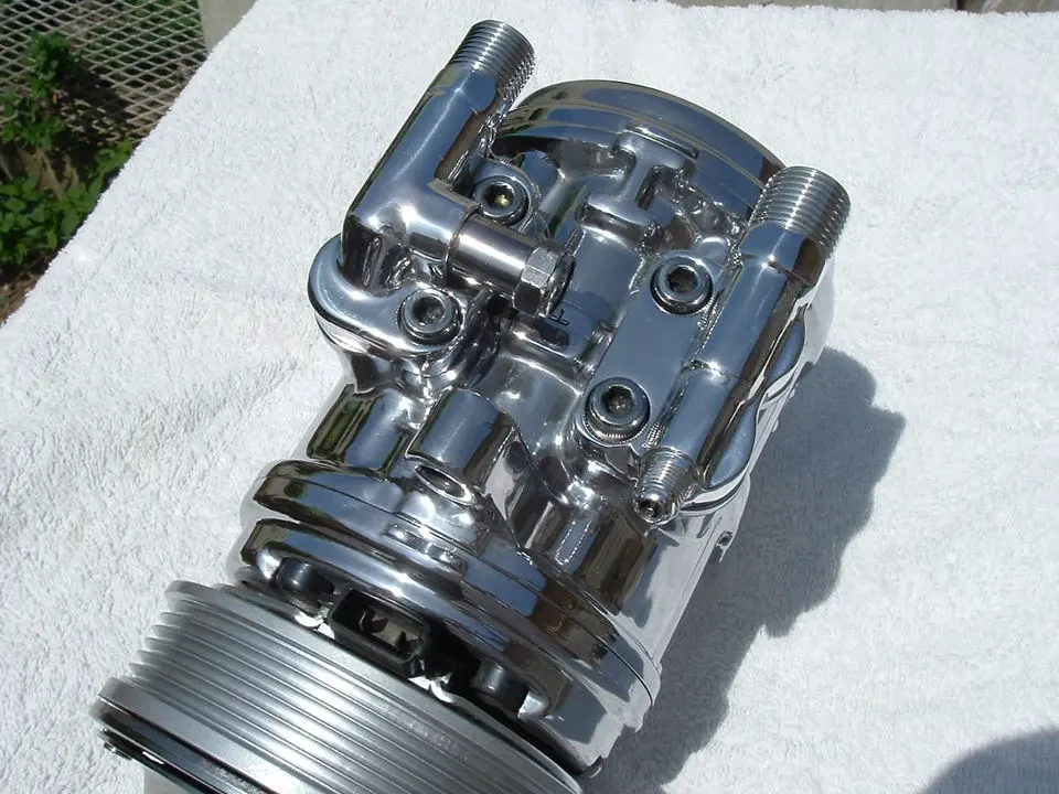

I'm going to be pulling my engine and want to get some parts chrome plated and i'm curious as if they would plate some sensor parts. Keeping the polished parts clean and shiny is just a pain in the butt!
Who polished or chromed this? Who's is it? How much do you want for it? LOL. This is my very next mod. Dayummmm...That is one nice piece!
DMAN302
My mom says thanks for the pearl necklace.
Nov 8, 2003
2,120
59
windsor, Canada
Apr 13, 2007
#34
  • Apr 13, 2007
  • #34
Beyond well done..I must have it!!!
