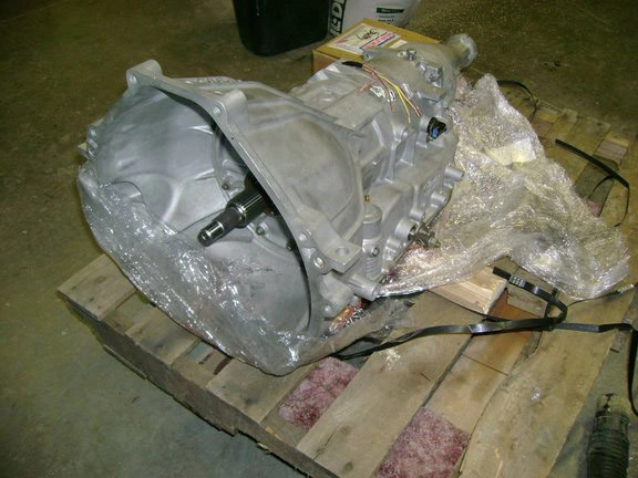

Here's some of the install. I drove it today, btw However there is still one more bug to work out, and I am teetering on the edge of going ****ING INSANE!!!!!!!!
New 4R70W:
See those wires? Yea...had to not only add on completely foreign sensors but also create harnesses for them.
See the shifter lever arm on the right? The little bone-shaped thing? Two overnights from Ford, 2 days lost, and my
friend ended up CNCing one to actually *FIT MY APPLICATION!!!!* Unreal.

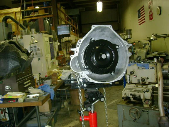

New converter

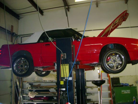

the Cherry's home for the past 5 days
Since I had a lot of free time in between waiting for parts and researching to create friggin' harnesses and levers, etc., I degreased the undercarriage. Yes, I was nearly halfway out the door with my exhaust to be high temp coated, along with some lower suspension parts. But I didn't expect we'd be so heldup wtih this install. If I did, I WOULD have taken some parts to be done
