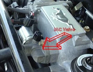

IAC --Idle air control.. Its a solenoid that allows air into intake so the car will idle. Its attached to the upper intake plenum and very easy to change. If it is stuck shut your car wont run unless you give it the gas.. They are about 40-50 bucks at a dealer or NAPA also carries them.

The IAC is a pretty common problem...What you are describing sound like it is going bad. You can remove it and try cleaning it with carb cleaner to see if it helps. THis is just a temp fix but it could let you know if this is the problem.
Thanks guys i'll change it tonight if I get a chance. From reading the other post I believe this is it. Mabey this will help the lunge when you put it in gear. Sometimes it will drop RPM's and then rev up without touching the gas and with an auto it is real noticeable :D
Sounds like an IAC to me too. You can try to clean it. Sometimes that works.

definetly the IAC. Mine was doing the exact same thing when i had to replace the IAC.
