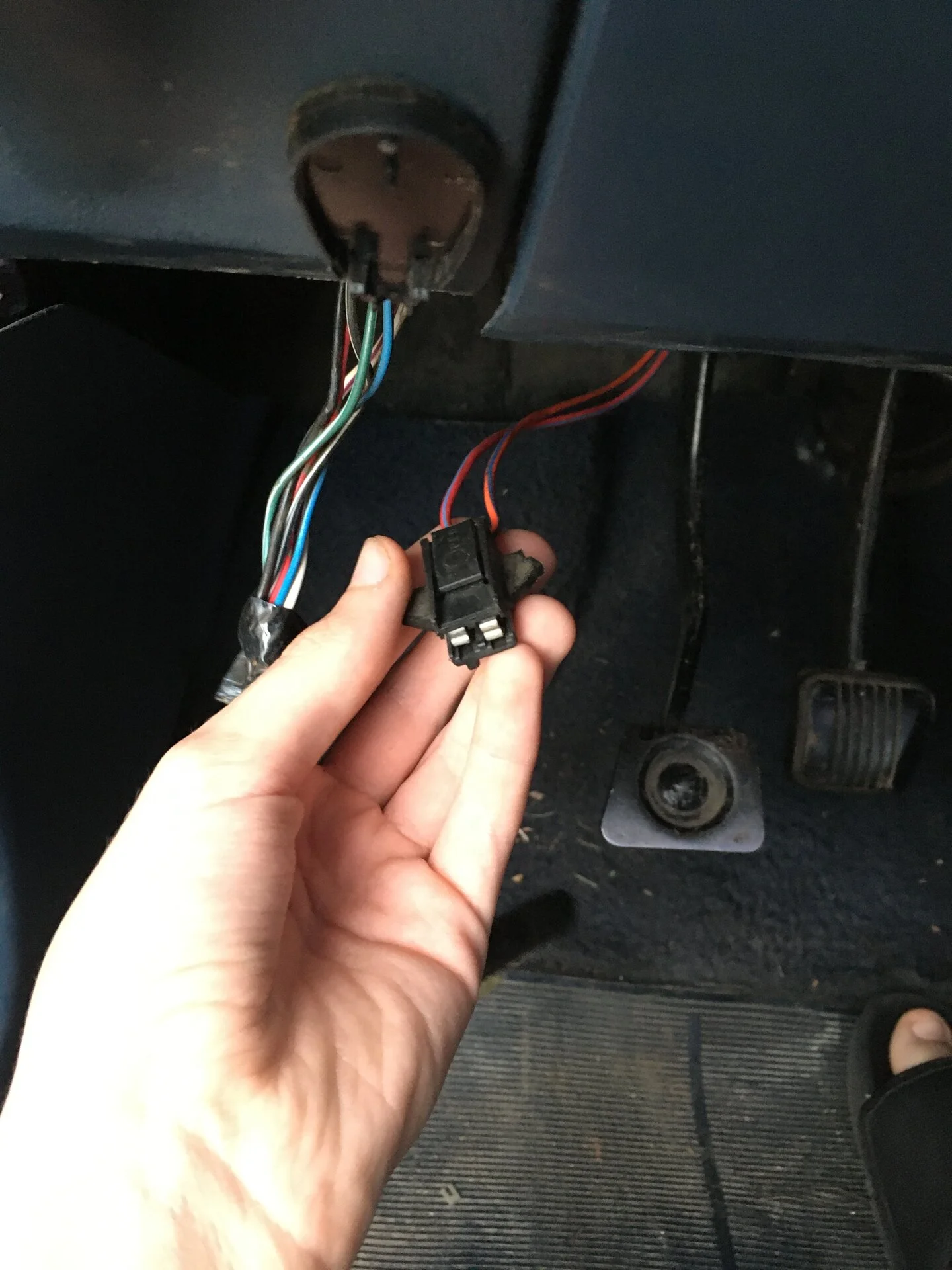

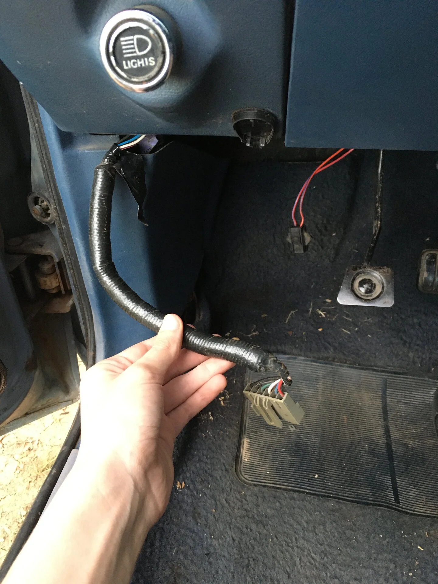

Need an ID on these 2 plugs I tried replacing the lights in my cluster following a video by house of DULA and still no light :( these I found under the dash unplugged do they need to be plugged in??

Not sure about the one on the right. The one on the left should be plugged in. It is there so the dash can be unplugged from the chassis harness to remove it. It's soulmate should be behind that left kick panel coming up from the floor.
