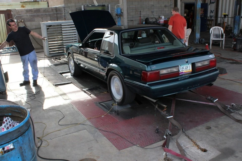

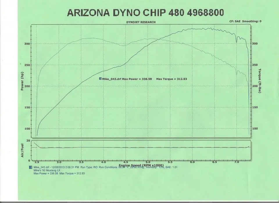

Car was ran at operating temps, on ethanol winter blend 91 pump gas, drag radials at 28psi, full accessory belt ect., etc., aka, no dyno "tricks". The dyno sheet clearly shows the conditions and correction factor of 1%. The uncorrected numbers are 333.69/310.24
I don't know what the dip in the tq curve is. I don't like it, but for the next while I'm going to enjoy the car and not fret over it.

I would hazard to guess that the injector slope is too high. What's your AFR meter saying when it happens and what size injectors are you using?
AFR is flat as a pancake as logged and shown on the bottom graph of the dyno sheet attached in this thread.
sits at 12.7-12.8 straight across. We did notice some oddities with the vacuum gauge and fuel pressure, but we had no time for tuning as it was a club dyno day.
