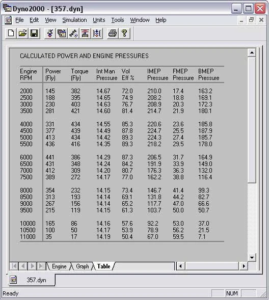

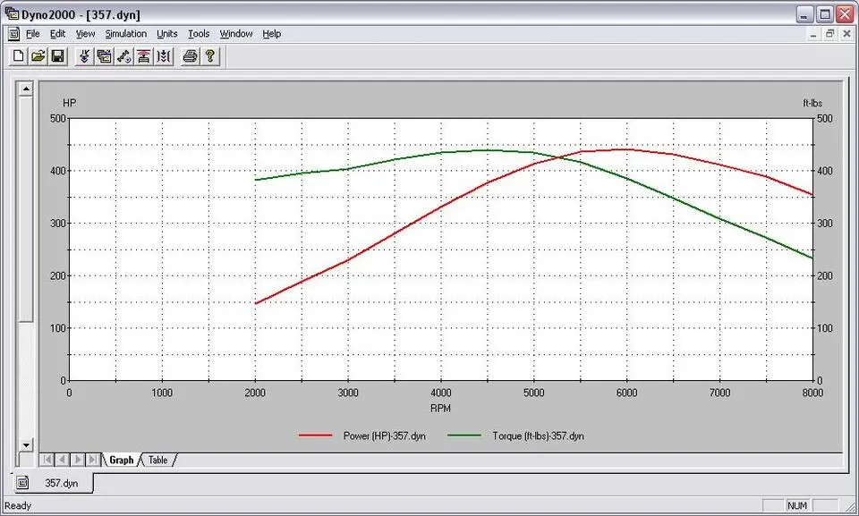

My approach to choosing a cam would be to first identify how you intend to use the car. For me it is a weekend cruiser, that i can drive to work once a month on a nice day. Something that can chit-it-and-git-it when I ask it to (low 12s was a must for me) but still get decent mileage with a light foot. Something that has enough vacuum for power brakes, run on pump gas, and can cruise the freeway below 2,500RPM. So I built a motor around the torque curve not hte peak hp numbers. My engine should have ~375 ft/lbs at 2,000RPM. it should be over 400 when the converter locks up, and remain at or above 400 ft/lbs all the way to redline. I had DSS Racing build/balance/blueprint my shortblock. I splurged on rods/studs/caps/girdle, my builder said the bottom end was good to 7,500RPM. Then I put a mild cam on it that will fall off at about 6,250, then I put a 6,000RPM limiter into the MSD box...LOL...basically I wont have to worry about my block until I supercharge it or run NOS :D
