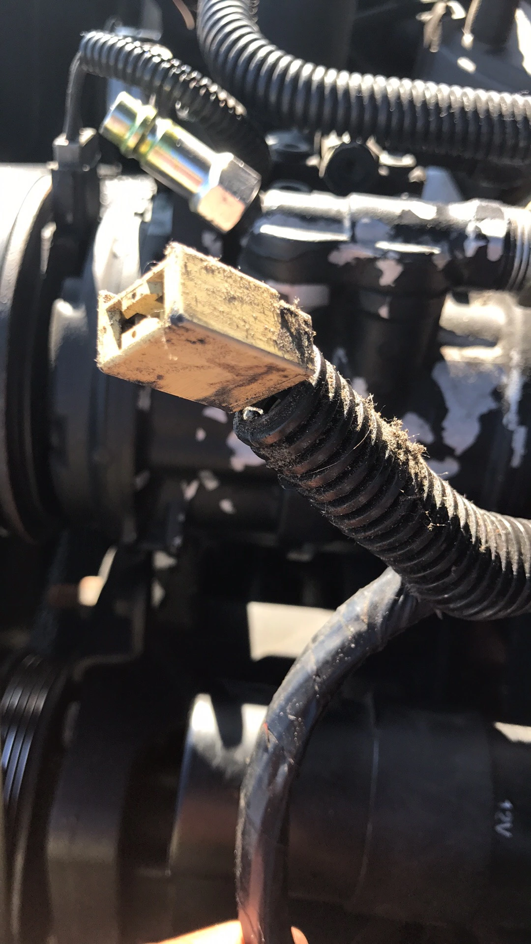

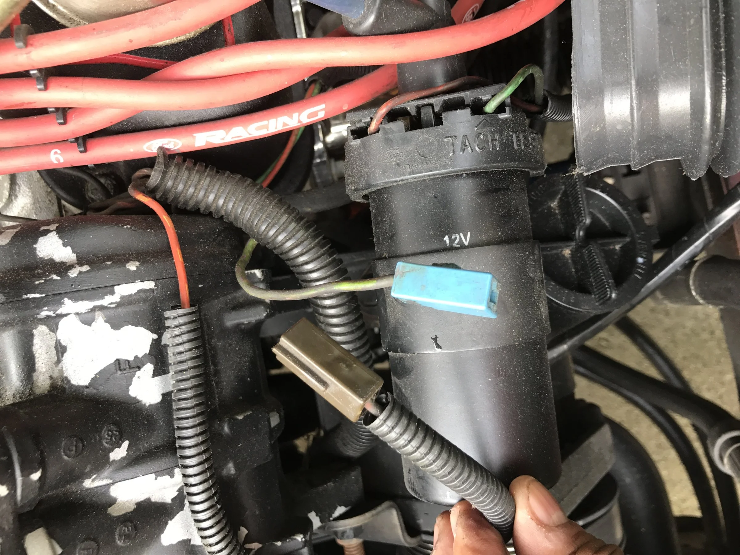

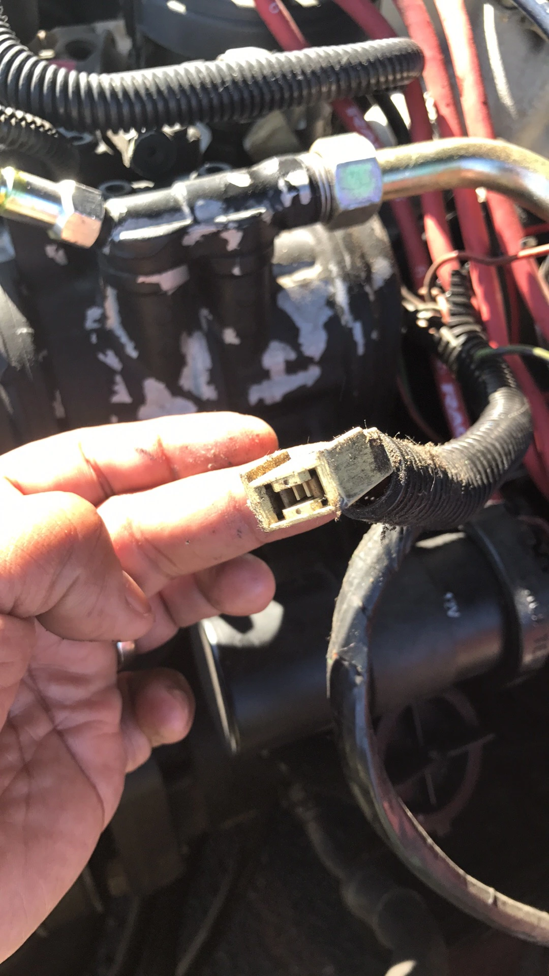

Please help! I have a 1982 mustang Gt with factory air. When the a/c is engaged, the compressor won't kick on. If I use a jumper wire from the battrey to the compressor it kicks on and blows super cold air. I have a new low pressure switch. When I tried to jump the terminal on the low pressure switch it should kick on the compressor,but has no power. I checked the inside switch......when put in the a/c position it does energize the a/c idle solenoid. Refrigerant is not low. I do have some wires not connected to anything.

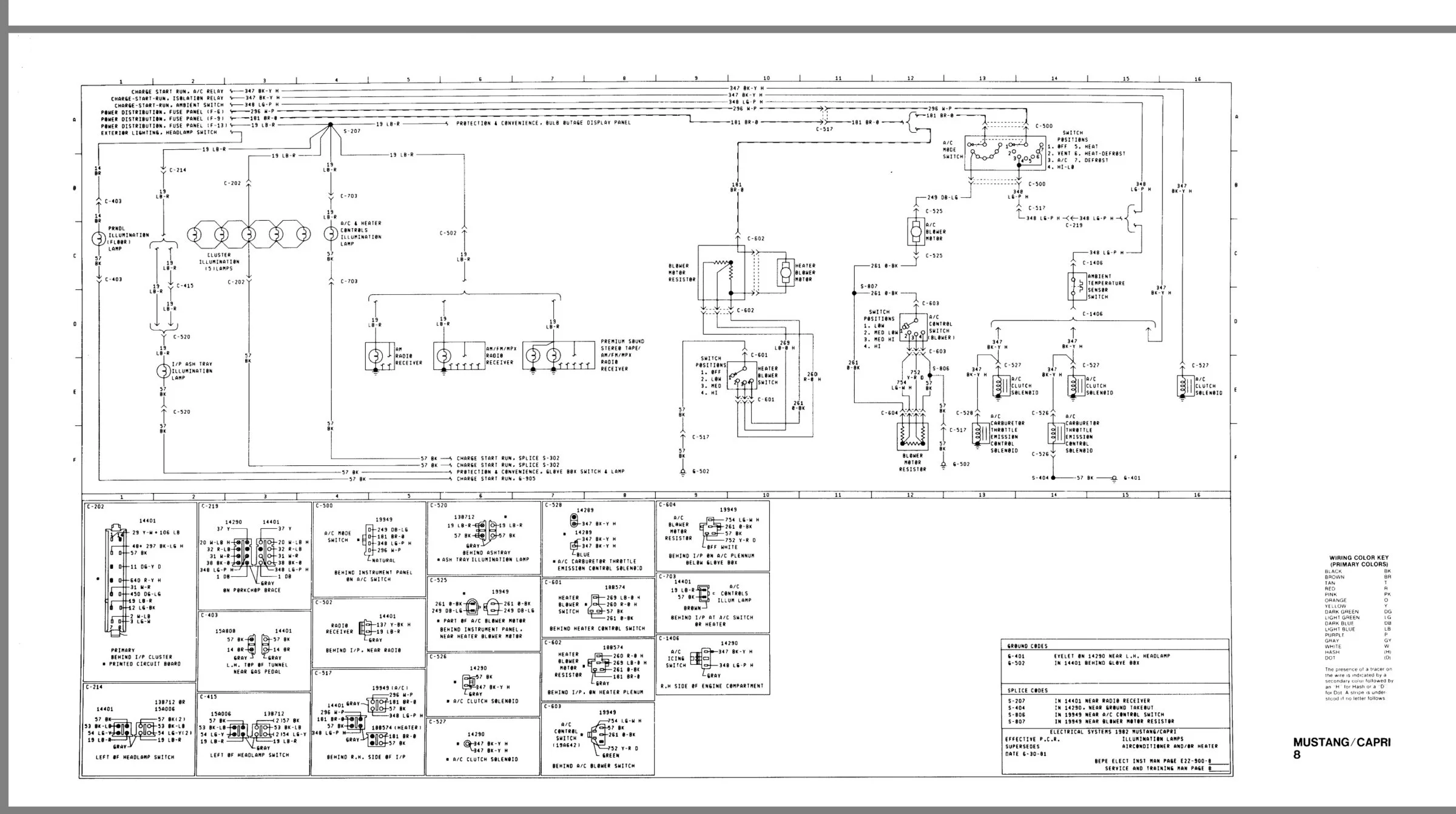

Does a 1982 4 speed manual have a WOT relay? I found this diagram that shows a/c relay.....I just can't find its location
The relay is probably on a page before the one you posted.
The Ford diagrams usually give you a letter row and number column when a circuit goes from one page to the next. The number column is useful in finding the page, since the columns are numbered sequentially. Unfortunately your doesn't seem to look like that.
