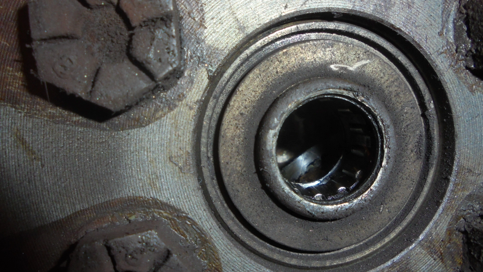

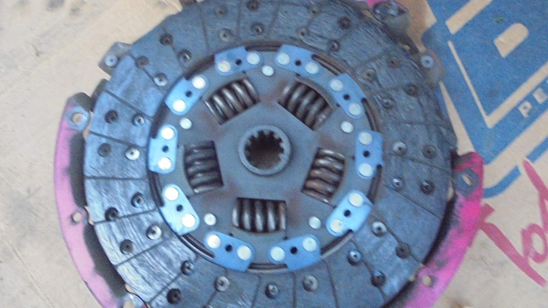

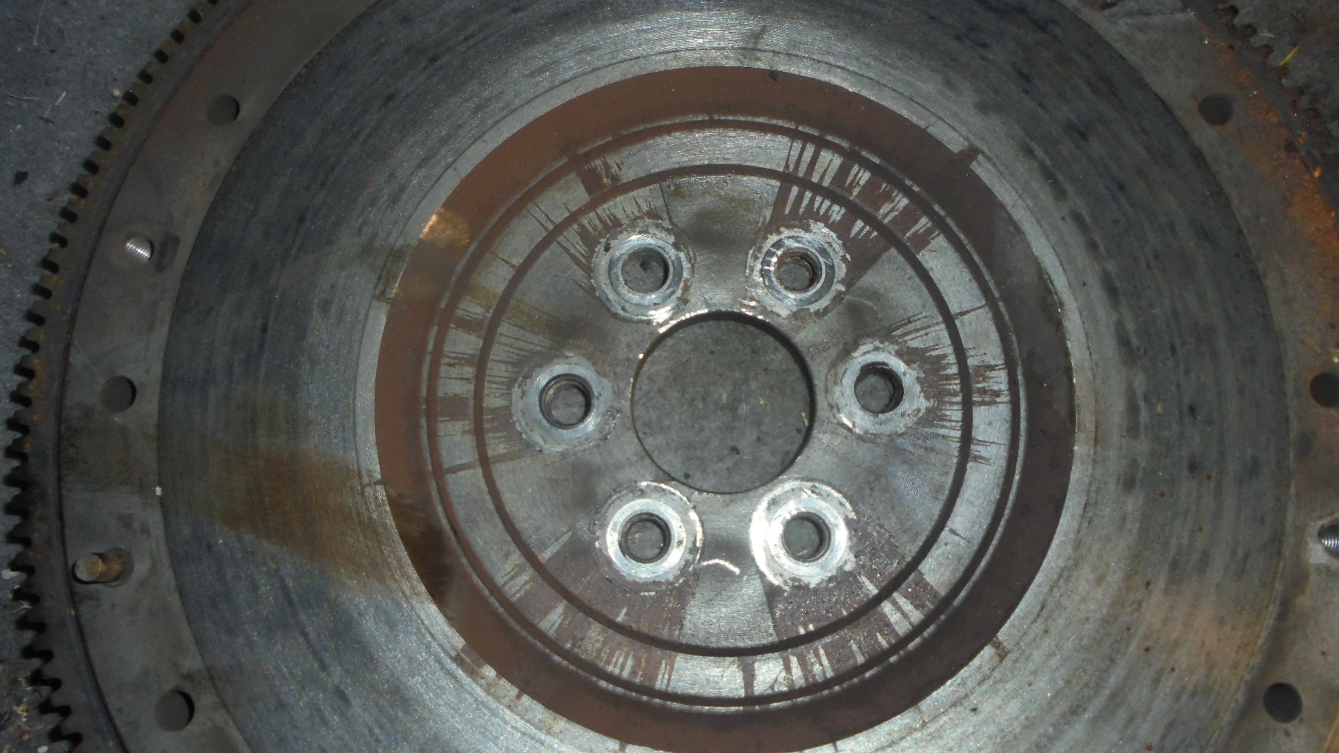

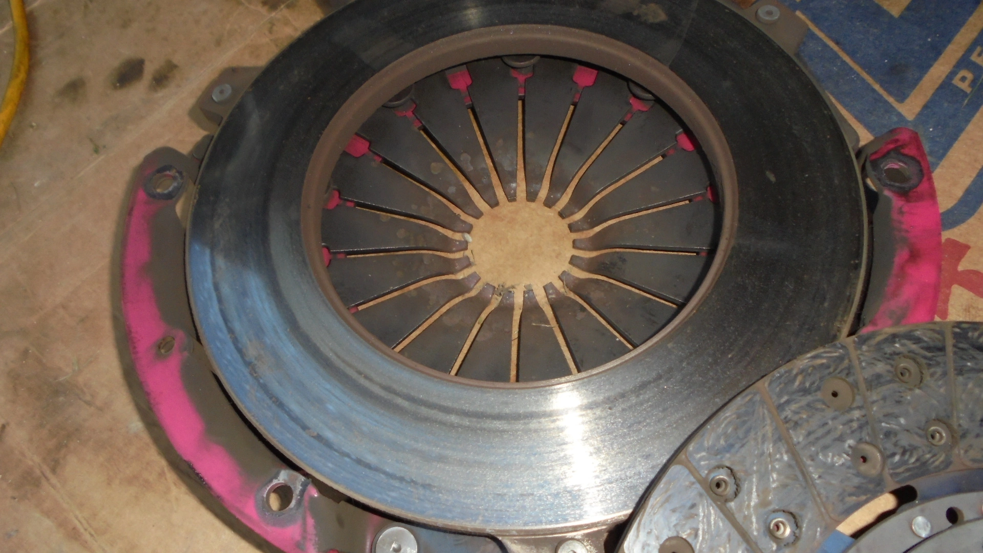

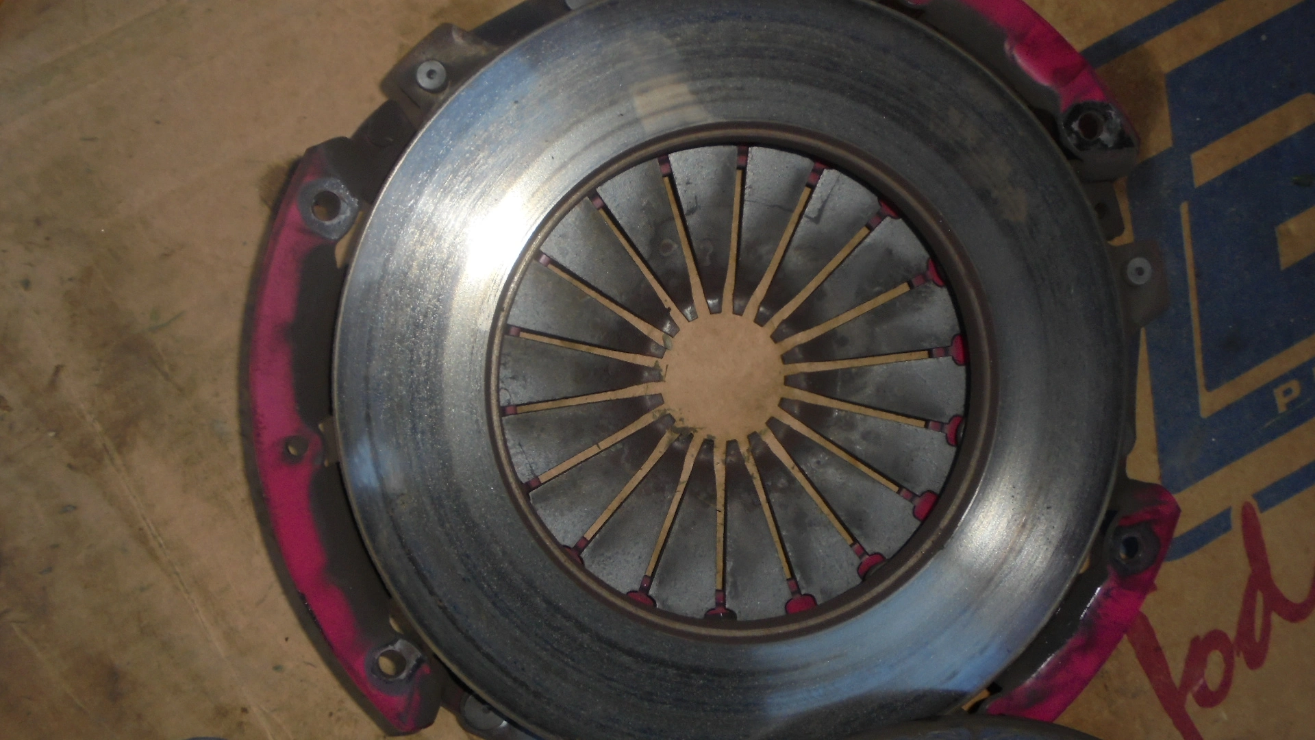

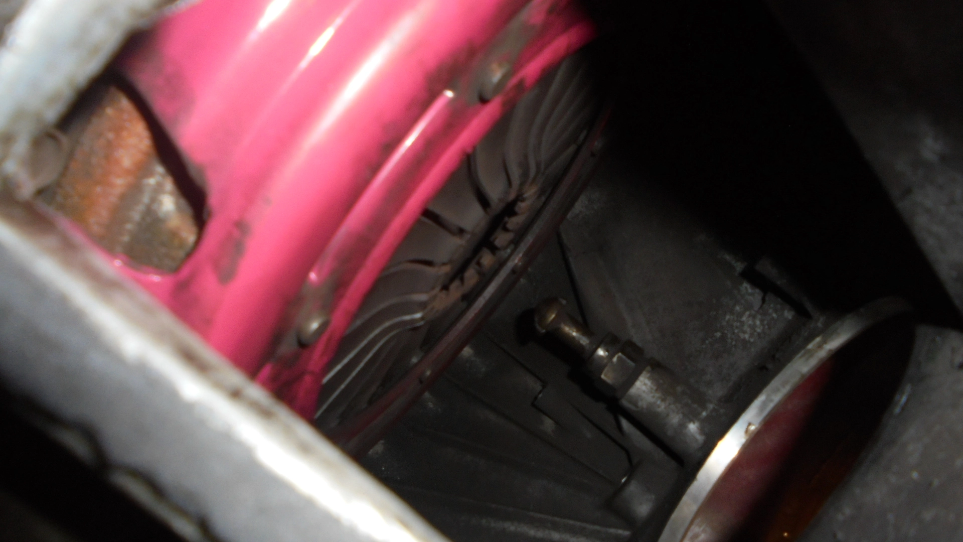

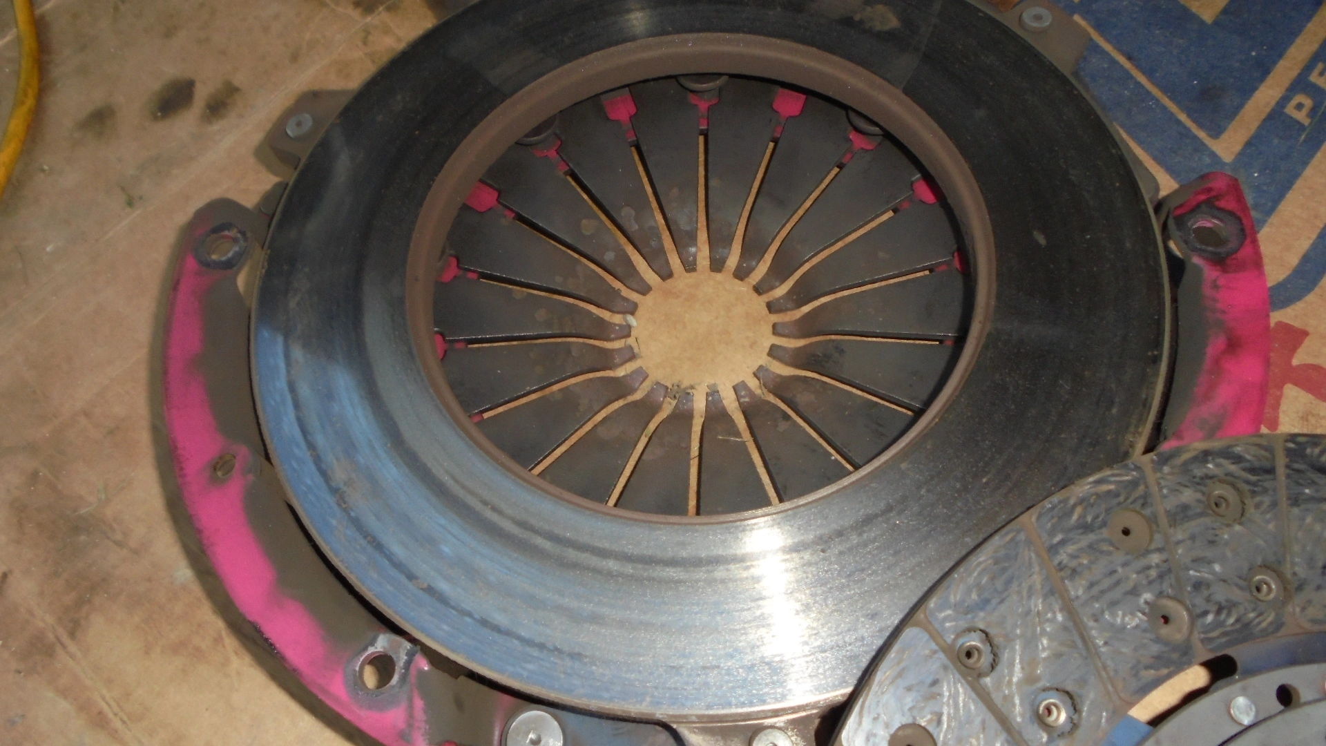

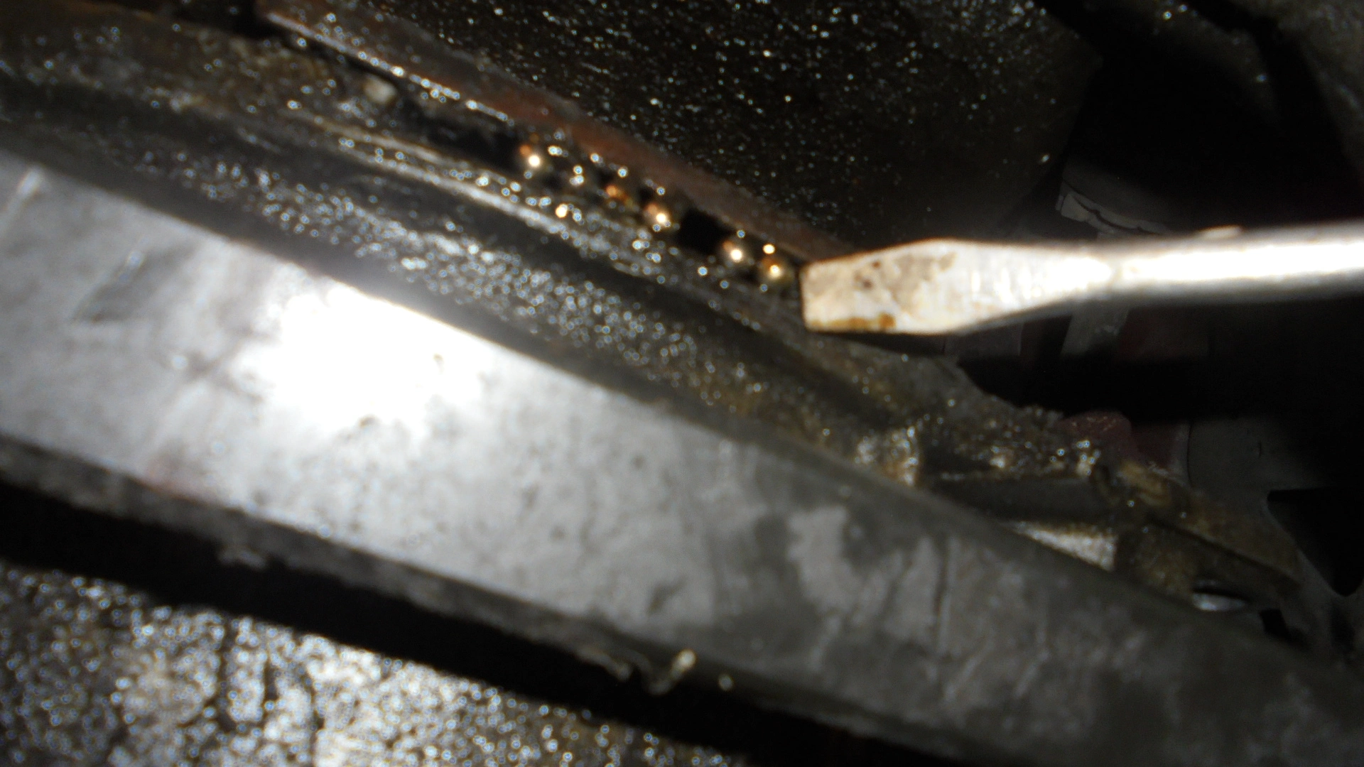

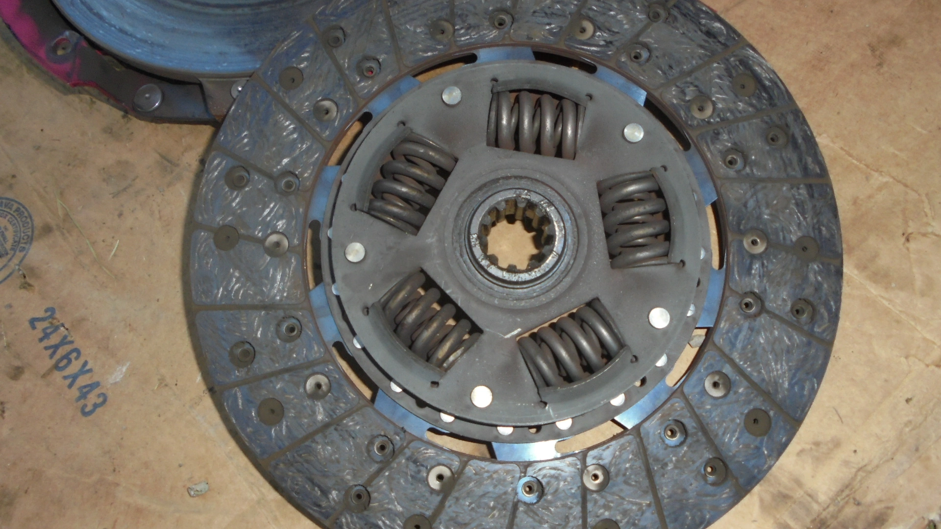

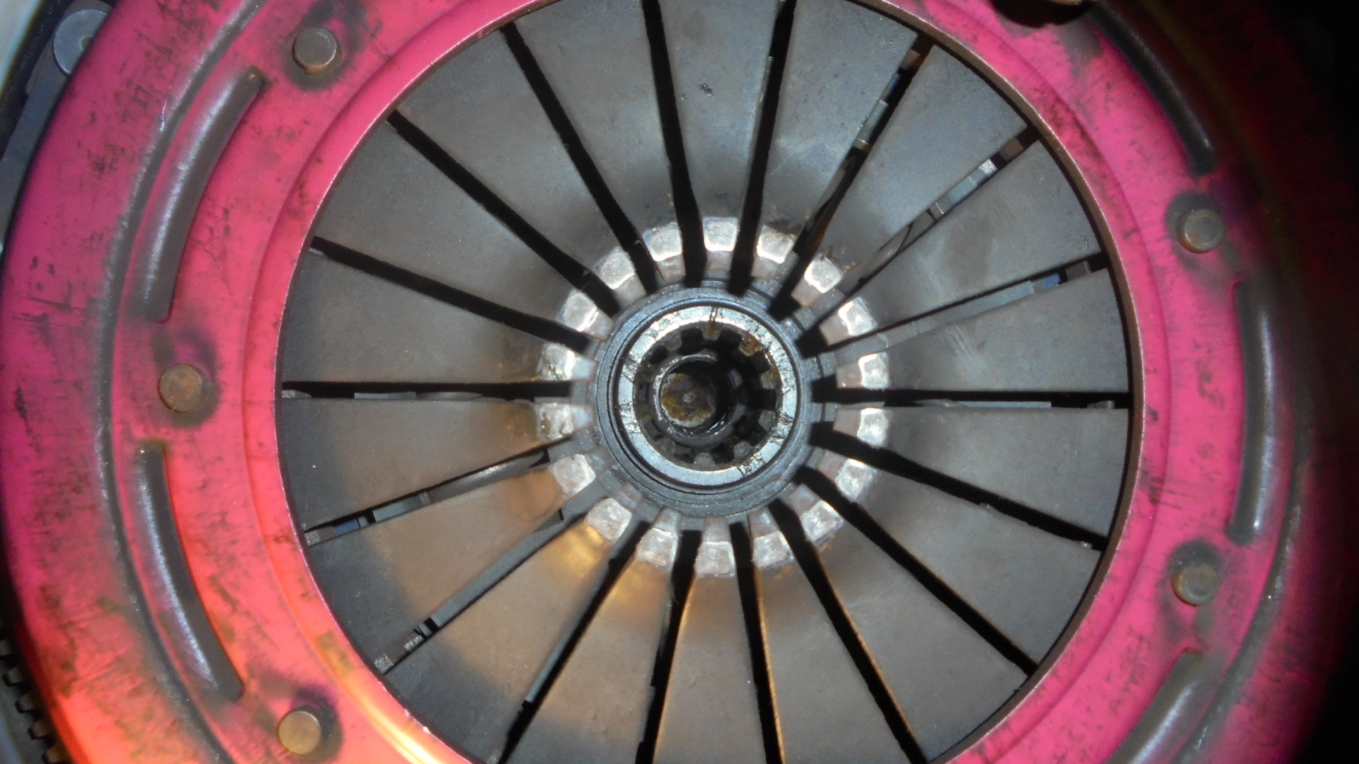

DSC00764.webp DSC00765.webp DSC00766.webp DSC00767.webp DSC00770.webp Ok well I finally got the new clutch kit delivered and did the teardown of the old parts. I have looked over the old parts and don't really see too much going on here at the outset..I am posting pics of the parts in hopes you guys will chime in with opinions. You will notice a couple of shots that I took of the remnants of a ripped apart TOB that were lodged in between the steel spacer and the trans. Also notice the pilot bearing is all torn up as well. Dont know if I damaged that during the disassembly.. Looks like there is a piece of a race and a needle bearing came out out of it, I took a shot of that and another ball bearing from the old TOB..The old clutch disk looks like I could probably re-use? but I wont obviously. I am going to call around to see who if anyone can machine the flywheel or I'll order one from AZ for 60.00..The teardown went smooth with the exception of getting all my tools lined up in the back of my explorer (garage lol) and plugging in my air compressor to an outlet that wouldn't trip a breaker in this old house lol. You guys with garages should be thankful AF you have one lol!

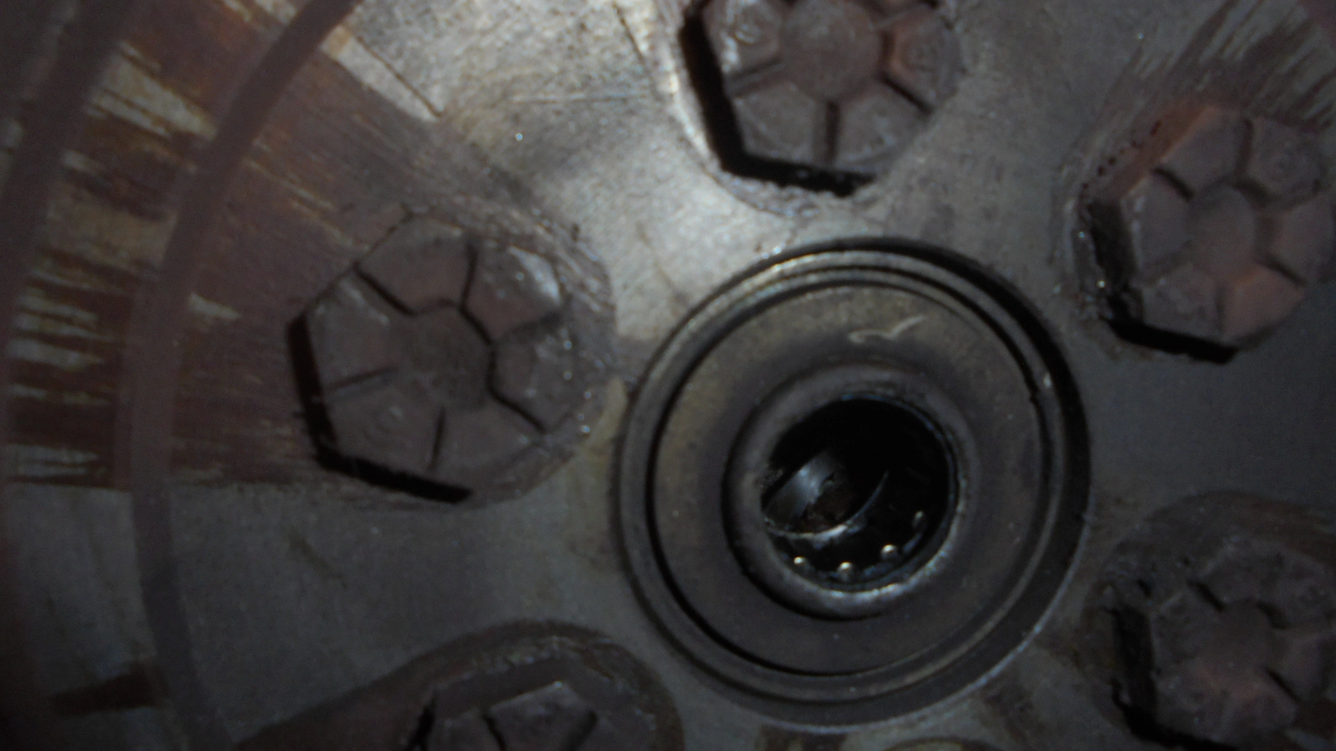

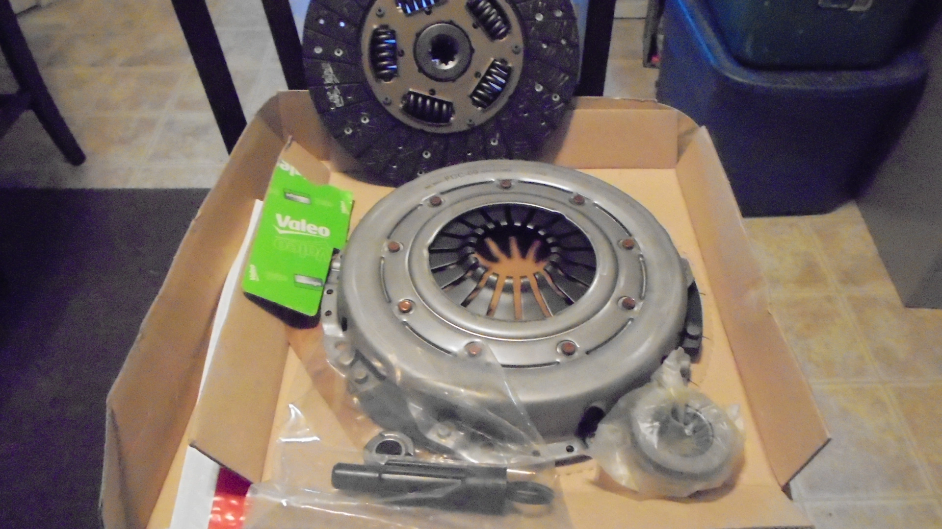

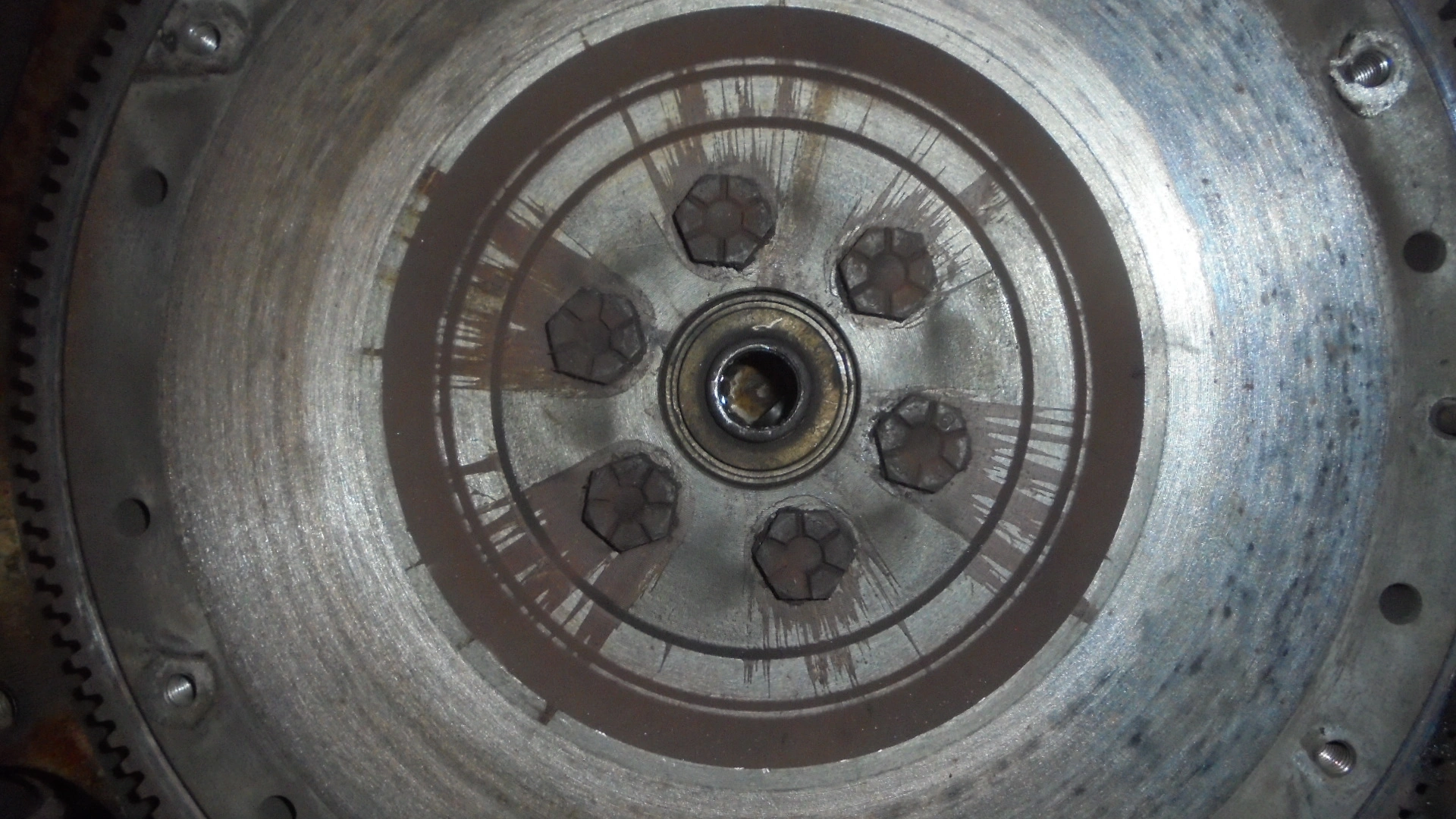

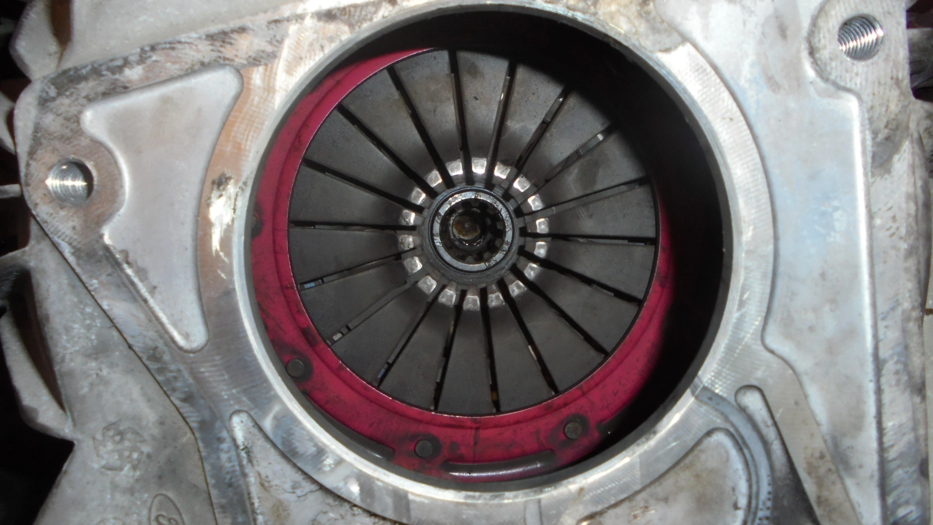

A few more pics..I don't know what brand the old stuff is, I'll jot down the part#s and snoop on that later..I've decided to just go ahead and install a new flywheel for peace of mind...The TOB retainer looks ok..Questions...would it be wise to rub it down with some real fine 1000 grit sand paper? Should I put a dab of antisieze or wheel bearing grease on the input splines and input shaft nub (that goes inside the pilot bearing)? Do you guys think the pilot bearing is what caused the clutch to NOT disengage? DSC00776.webp DSC00788.webp DSC00790.webp DSC00793.webp DSC00798.webp

My earlier theory ^ was that a problem with the pilot bearing could keep the input shaft locked to the flywheel and rotating, and give you the similar inability to get it into gear when running as a dragging clutch. It looks like there's quite a bit of reason to suspect that may have been the case, or at least part of it (a warped disk or pressure plate problems could give similar symptoms and after that TOB went ballistic who knows what was damaged). I usually put a dab of grease on the pilot myself - but just a little. I use the rest of the provided-with-the-clutch-kit-pack-of-grease primarily on the fork pivot and the bearing retainer where the TOB rides. Not much use for it on the splines as the splines are locked to the clutch disk which doesn't move all that much on them. You also risk fouling the clutch material as the grease slings off of the rotating input shaft.
You're replacing everything so there's every reason to be hopeful you won't have any more problems. I agree with the new flywheel purchase, I do that too if one is available. At $60 you get a fresh ring gear, full thickness of metal, and no waiting on the machine shop (which will cost close to as much $ anyways).
I don't think a pilot would be easy to wreck while disassembling by the way. Much more likely the trans was forced together (bolt tightening used to pull things together) while slightly out-of-alignment at re-assembly, at some point in its past. Or it just fell apart over time. Either way, you found something clearly broken, so the work you're doing has been fully justified. :) You'll like the KC clutch by the way, if you haven't owned one before. More clamping with a lighter spring feel, and holds a good amount of HP while being as streetable as the stock one.

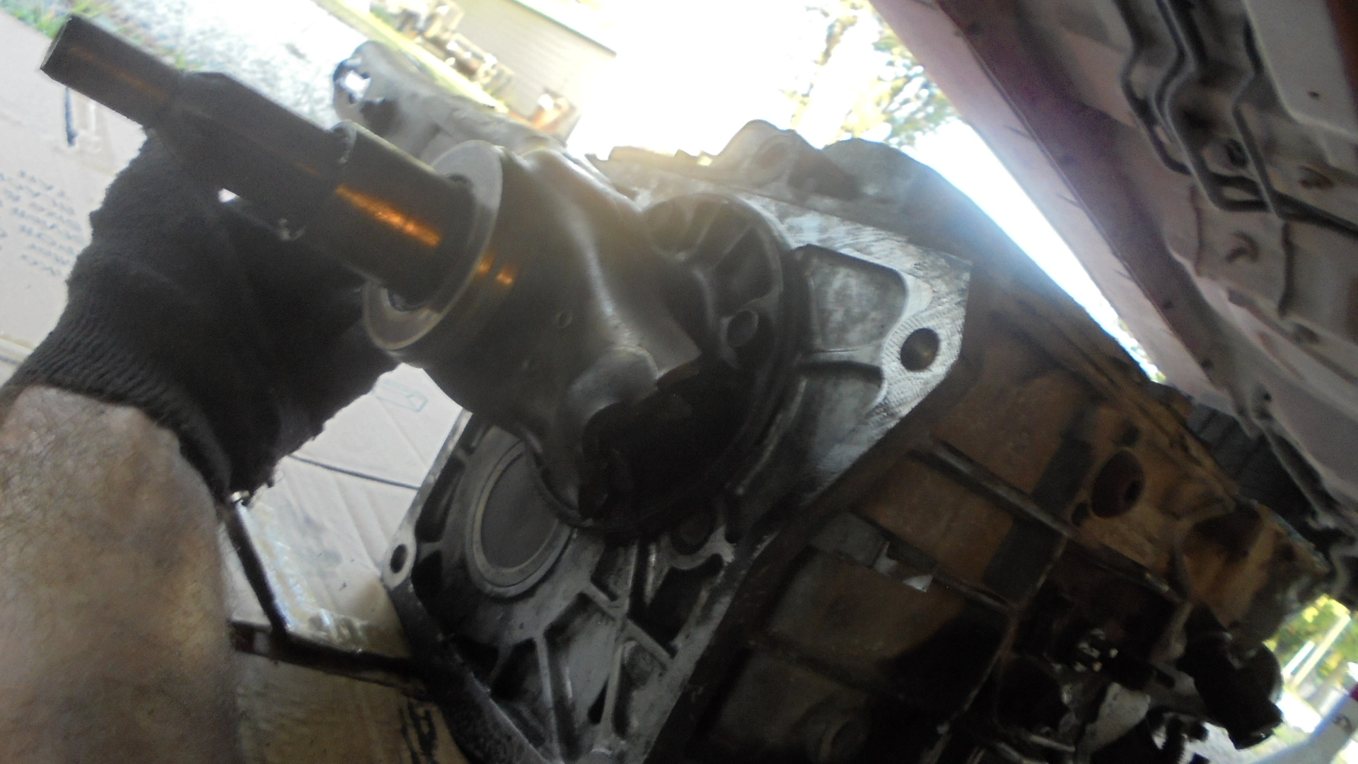

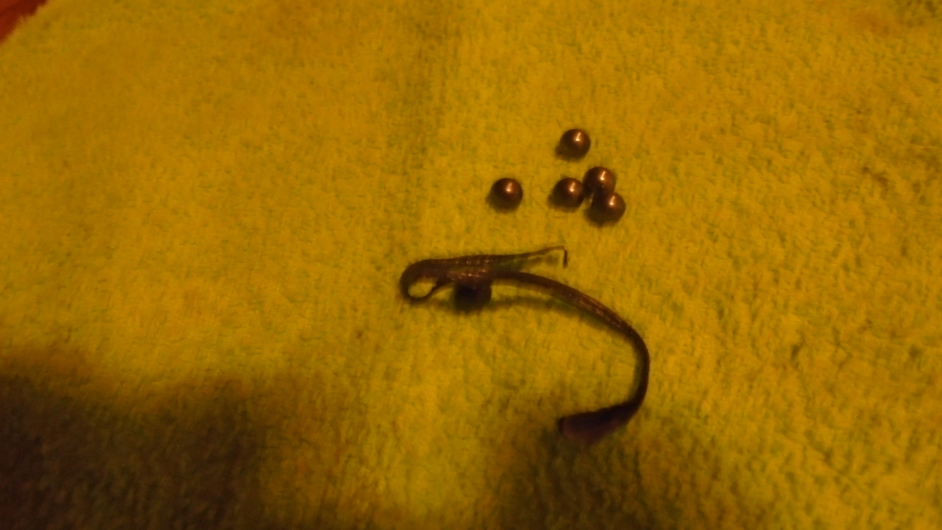

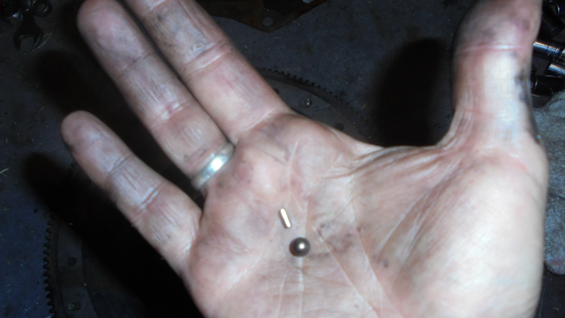

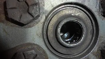

DSC00754.webp Yes indeed you seemed to have been correct on that, once I saw that I was like wow a little 20.00 piece held the car hostage and caused all this work smh..But oh well, I did buy the car to "tinker" with..just not too much ..I'll be back at it today..sorta took a break yesterday and picked up the flywheel..and yeah the cost of removing it then machining vs removing and new no brainer imo..I had KC clutch in my 94 coupe..it had the Tremec 3550 in it..had it 7 years without any problems whatsoever..It handled HCI 373s. many passes down the 1320..You mentioned maybe the pilot was possibly damaged on re-assembly..I did RR this trans last time to change the old grenaded TOB..but that was like 8-9 months ago..I would think if I fubared it then she may have given up the ghost sooner?..IDK, but I'll be extra careful with re-assembly fo cure..Oh yeah I must remember to remove the AIR tube @ back of heads and get the plugs.no better time to access them like now!

It is the PERFECT time to remove those tubes and plug the heads! :-) If the pilot was ok when you removed it, and you took reasonable care re-installing, I'm sure it wasn't you who damaged it. They sometimes just go all on their own from wear. No need to be super-careful, if it slides together with just a little wiggling and twisting then it's fine. If you have to tighten the trans-to-bell bolts to force it together then it's probably a bad thing. I usually base my comments on the fact that many of our cars had previous owners, often young people with more enthusiasm than ability or cash. :-)
I never removed the pilot the last time, just the trans..even left the bellhousing on last time when I changed out the TOB..I should of just went the whole way and inspected everything..but assumed new clutch so it wasnt necessary, plus we know the stories of the TOB and folks having to change them out..so I let it slide hoping all would be fine..big mistake obviously..Today I removed the old pilot bearing it was completely frozen..wouldn't budge even a little..I removed it without a puller/tool..I used 2 pieces of sandwich bread lol..
