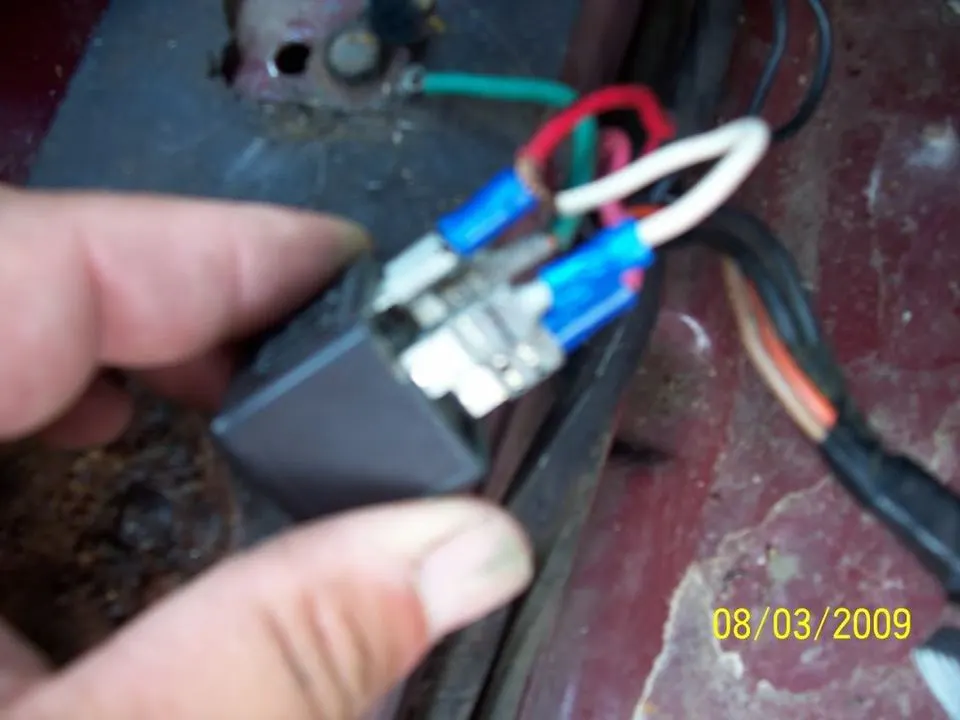

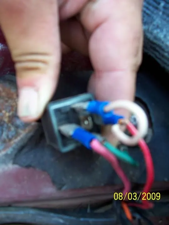

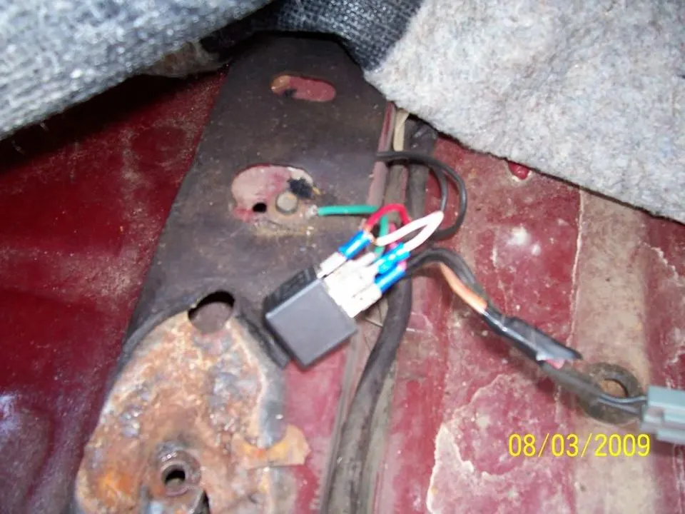

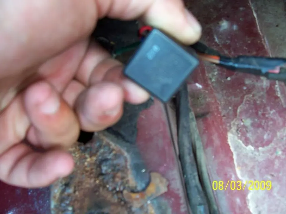

keiser blade
Jul 29, 2009
35
Aug 3, 2009
#11
  • Aug 3, 2009
  • #11
http://i268.photobucket.com/albums/jj32/95neonon18s/100_0955.jpg
http://i268.photobucket.com/albums/jj32/95neonon18s/100_0956.jpg
http://i268.photobucket.com/albums/jj32/95neonon18s/100_0957.jpg
http://i268.photobucket.com/albums/jj32/95neonon18s/100_0958.jpg

look a lil wacked anyone got any pics of the factory one thanks Brandon

keiser blade said:
Looks like someone grounded the negative relay-coil wire (which should come from the EEC), as was discussed earlier. If so, the EEC cannot shut off the pump after the prime-out. This would have the pump run anytime the key is on.

i got it hooked up right, with that relay, the wires were there i got them hooked to right place on the relay, it runs for 2-3 sec when the key is on, and works normal when the car is runnin
thanks everyone
