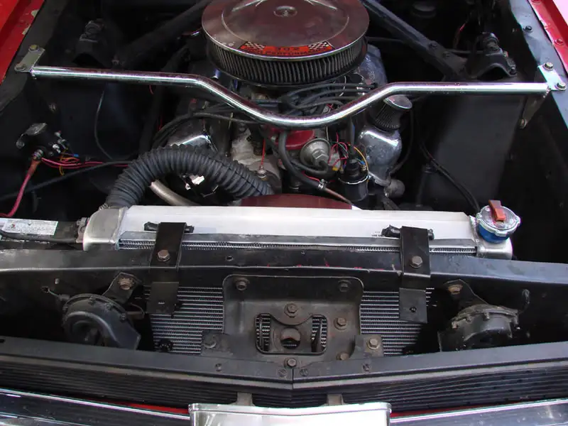

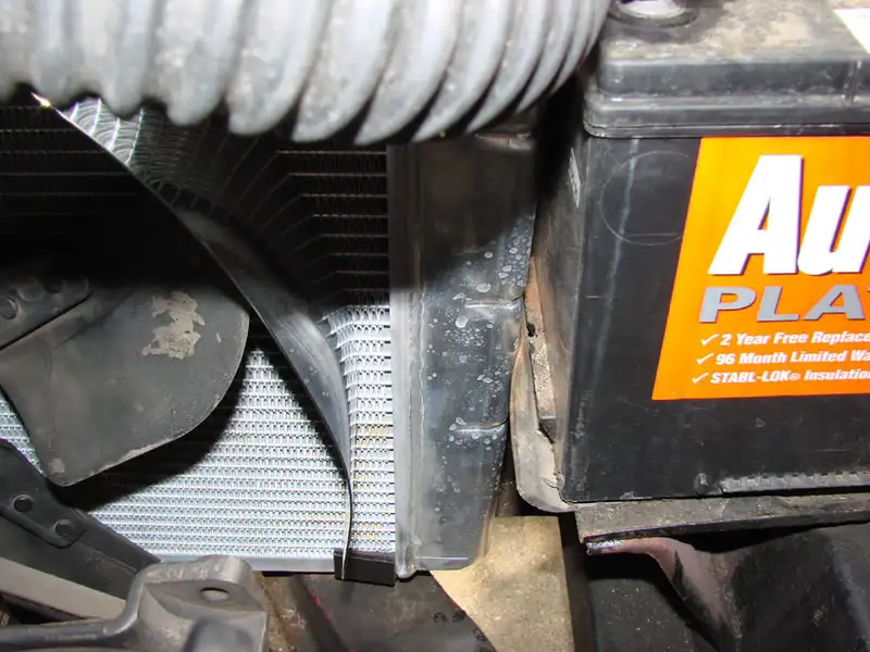

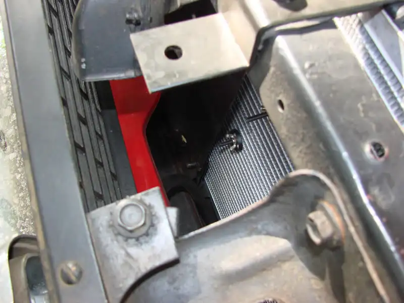

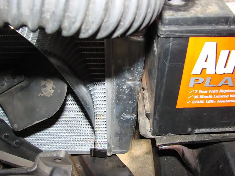

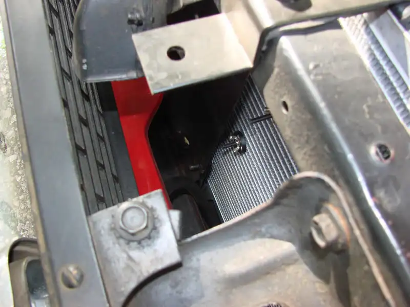

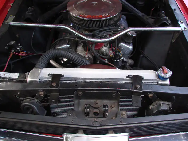

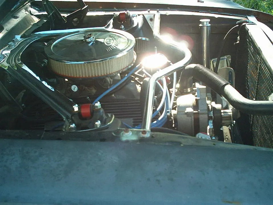

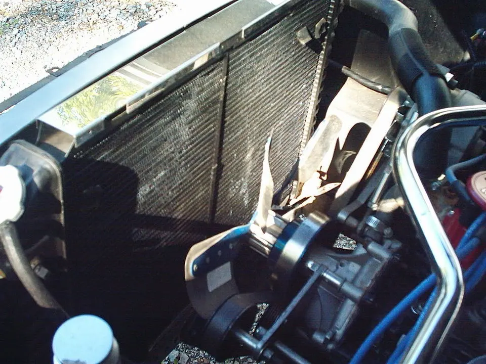

People say it can't be done, but ---------(I forgot to mention that my battery is in the trunk, not sure if the radiator would fit with the battery tray in place)

Yeah I have to have the battery in the engine compartment. And that is where I am having fitment issues. And yes I have the correct water pump, it is reverse-flow.
Nice job on your installation of the 351W. It looks great!
I am using a radiator made by Northern. It is a generic version so you will have to fab up some mounts for it. Not too difficult. I am running a serp belt and Had to adjust the angle of the upper radiator hose. That only cost me about $20 to do.

I have my battery in the trunk, but I think it woulda fit if I turned it sideways. I cut the radiator support opening for more airflow and room to mount it foward for theTaurus fan.
The radiator is a Summit (made by Northern) 26" with two 1" rows - $170:

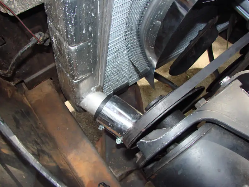

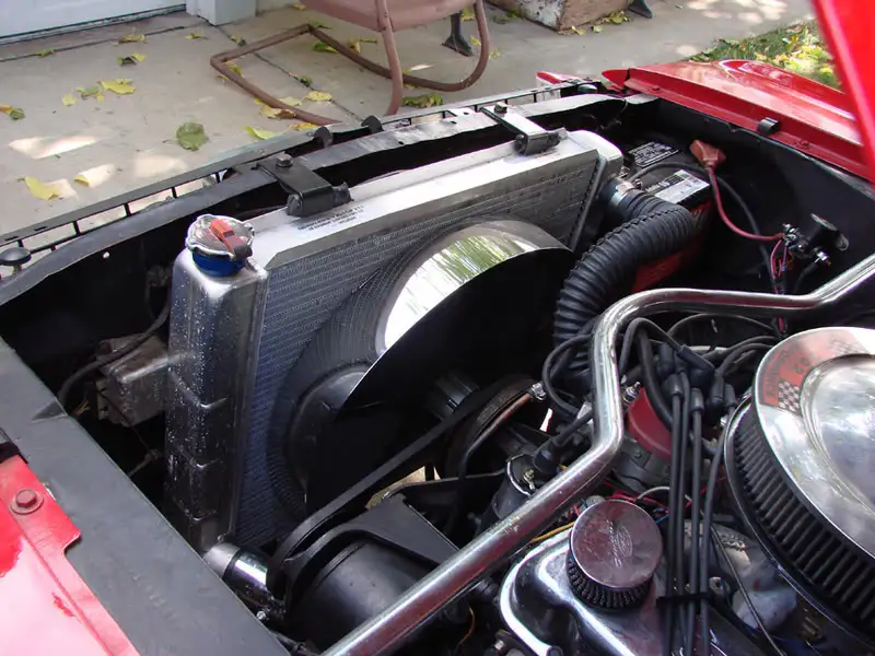

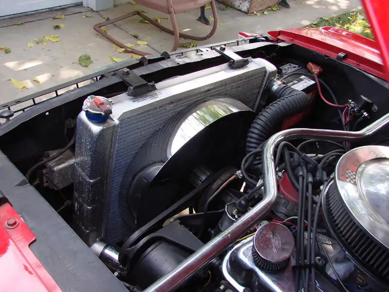

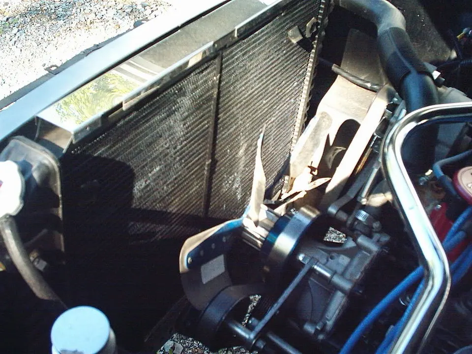

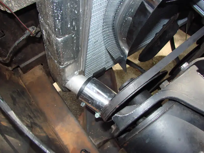

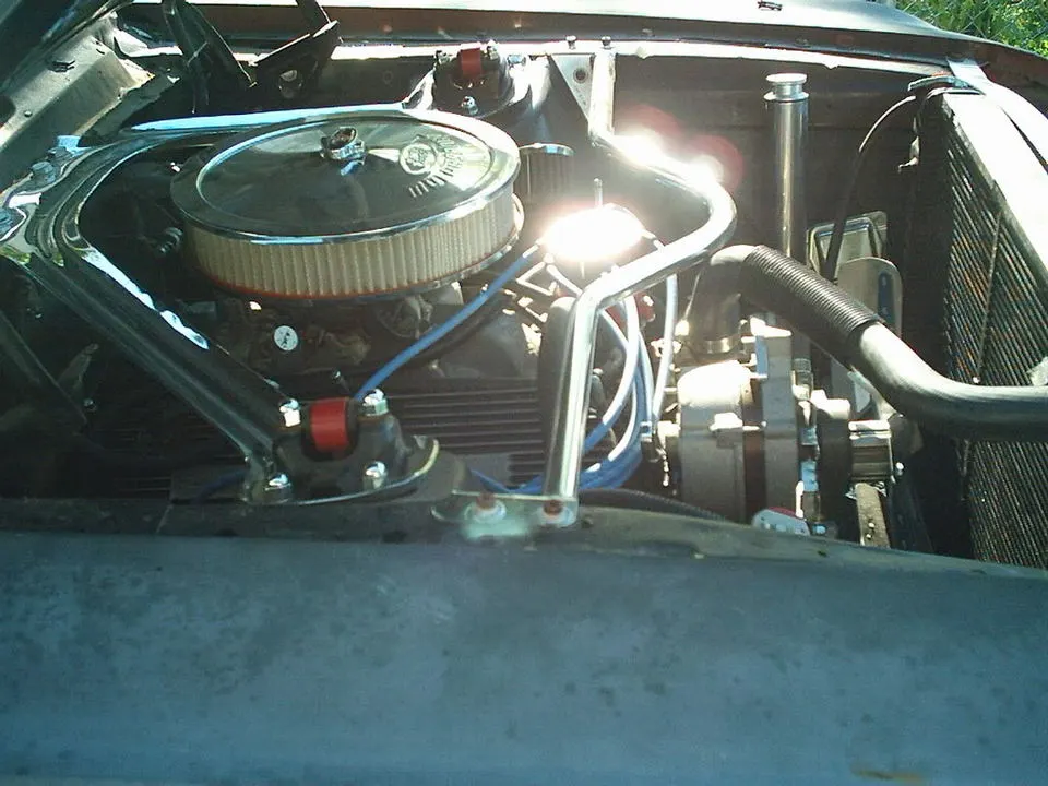

i, too, bought the summit-brand radiator.
25" about. had to cut about 3/4" off the battery tray to make it fit, but man, it's nice.
i also bought their universal radiator brackets for $15. took a bit of creative work to get the top ones to fit, but i didn't have any steel to fab up my own way of mounting it.
the shroud is one of the 1/2 shrouds on summit for $35. i needed a quick, easy, cheap, and effective radiator for my daily driver.
p.s. the hoses are an 18" flex hose on top, and a 30" chrome flex hose for the bottom. i had to route it underneath the balancer to work on the stock water pump.
