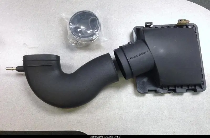

Need Feedback On Saleen 98mm Airbox W/ Hard Plastic Upgrade Tube
Guys ! I happen to be running a Saleen series VI S/C on my 2006 GT which was installed with a C&L racer inlet tube and pipeline 101mm MAF..
The car was already installed with both the S/C and C&L intake when I purchased it, but since I've owned it, I've noticed a few clearance issues with the intake tube rubbing on both the top of the alternator and inner hood..
I was looking into replacing the C&L intake setup for the JLT series 3 which is supposedly designed to fit with a Saleen S/C and the stock hood, however after speaking with several other 05 and 06 owners, they provided some negative feedback concerning hood clearance issues they encountered with the JLT intake..
So after talking with several local tuners, I was recommended to look into running either the Steeda 90mm cold air intake with the stock Saleen rubber inlet tube or find a stock Saleen airbox lid which has a 98mm MAF housing built in along with their upgraded hard plastic inlet tube..
So my question is this.. If I decide to go with the Saleen airbox setup that I just described, will I notice any substantial power and airflow loss due to running an enclosed airbox which is considered as being restrictive when compared to running a cold air intake such as the Steeda 90mm CAI ?
If I do decide to go with the Saleen setup ? Bear in mind that I will be cutting out the bottom section of the stock airbox in order to increase airflow which hopefully will reduce the restrictions of running an enclosed airbox..
In addition, I'll most definitely be getting my car custom tuned regardless of which setup I decide to go with..
In the meantime, I'd be really grateful for any feedback and support in addressing my concerns..

It has been my experience with CAI's that the enclosed box is not what restricts air, its the diameter of inlet tube combined with the CFM rating of the filter itself. I have even gained from using a modified stock box with the larger maf/inlet to provide good flow with more heat protection which = the Cold part of CAI... just my $.02
Would you mind sharing as to which steps you took in modifying your stock airbox in order to retrofit a larger MAF/Inlet ?
The only solution I can think of.. Is by cutting the bottom section out of the stock airbox and then replace the stock airbox lid with the larger Saleen 98mm MAF lid along with their larger diameter plastic inlet tube..
If you wouldn't feel comfortable in sharing which steps you took in this thread ? You can always feel free to send a PM instead..
