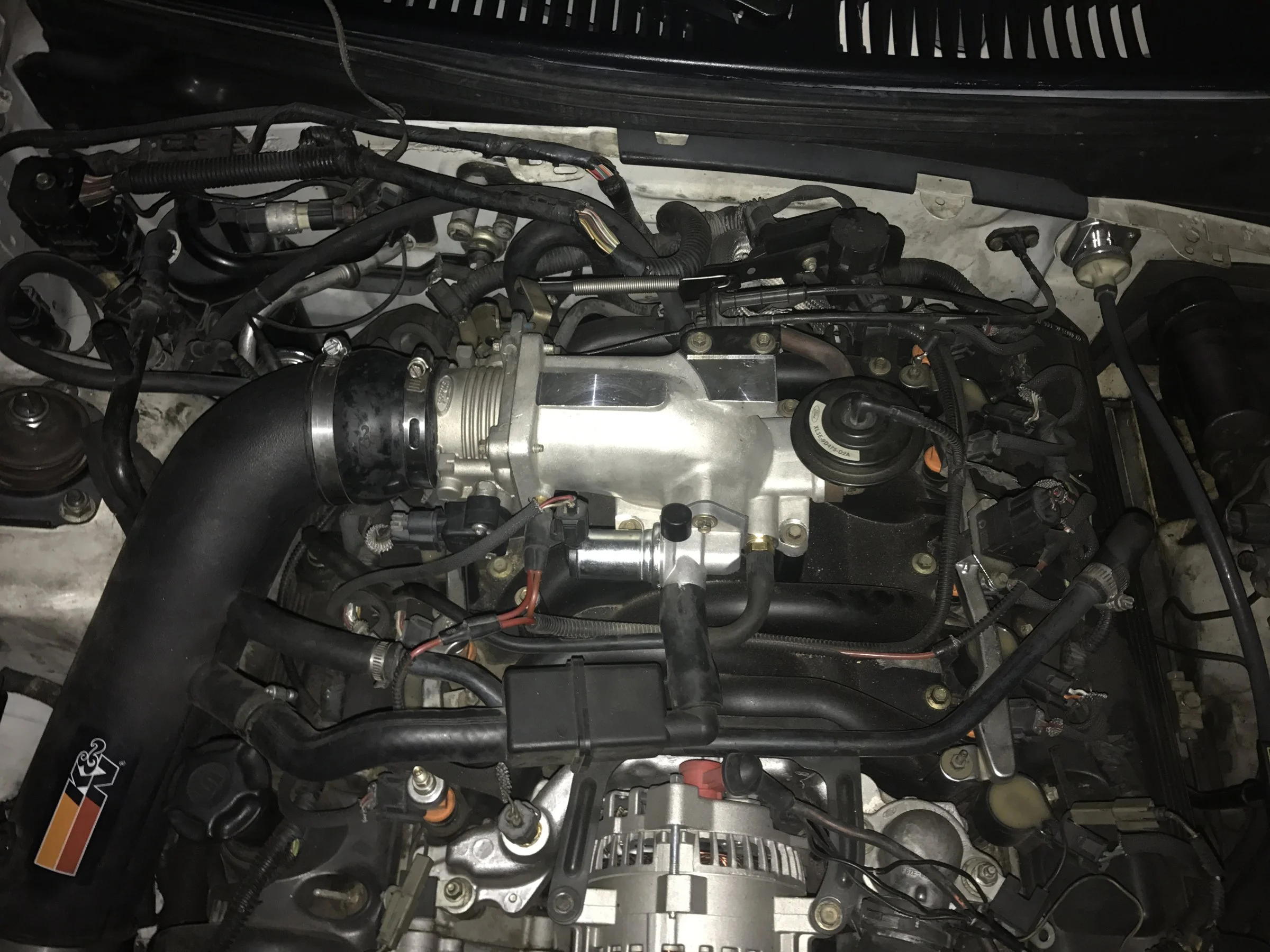

I have a 2000 mustang GT with a Windsor engine about 2 weeks ago it started making a knocking noise coming from the bottom end. I replaced the clutch and flywheel thinking the noise would go away also clutch was making a noise too so had to replace it. But anyways put on new flywheel and new clutch with new pilot bearing new throw out bearing and fork. And still mad a knocking noise. The knocking noise is between 2500-3200 RPMs. I've been looking around YouTube videos and they all point out to be a spun bearing. What would be the cheapest way to fix this? Should I just replace the motor with a 4.6 from a crown Vic non PI or replace the bearings? If I do replace the bearings how much would it be an estimate? Thanks guys!!
