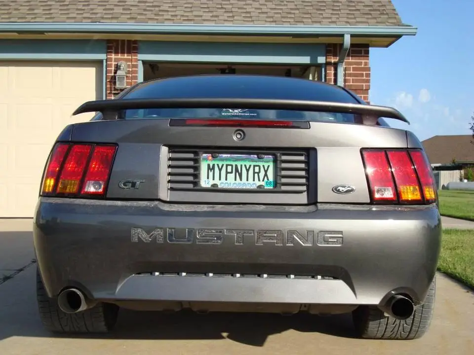

Ok got it all figured out... For future searches sake...
All you need are 99-01 Cobra Tails, the Light assembly/harness (should come as a set with the housings), a 99-01 Cobra flasher relay, and then some extra electrical wire. After that just follow the instructions for the most part provided at mustangworld.
I'm definately not happy with them. I'm gonna missed my smoked GT lights until I get these smoked. But at least these will easily pass the lighting inspection when the car gets to the UK soon.
