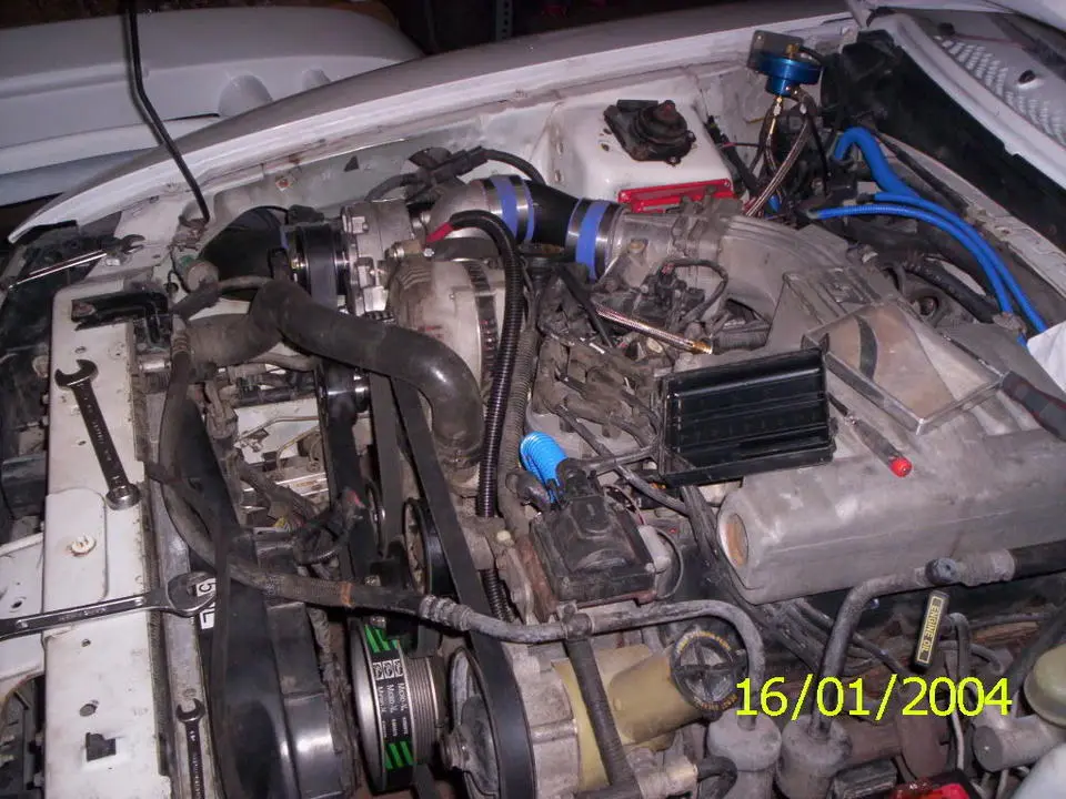

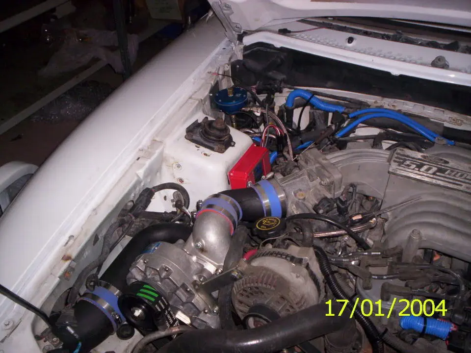

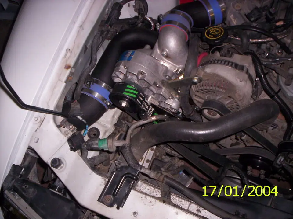

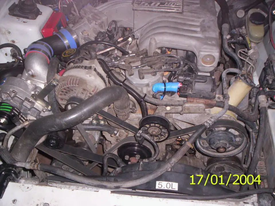

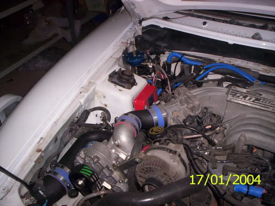

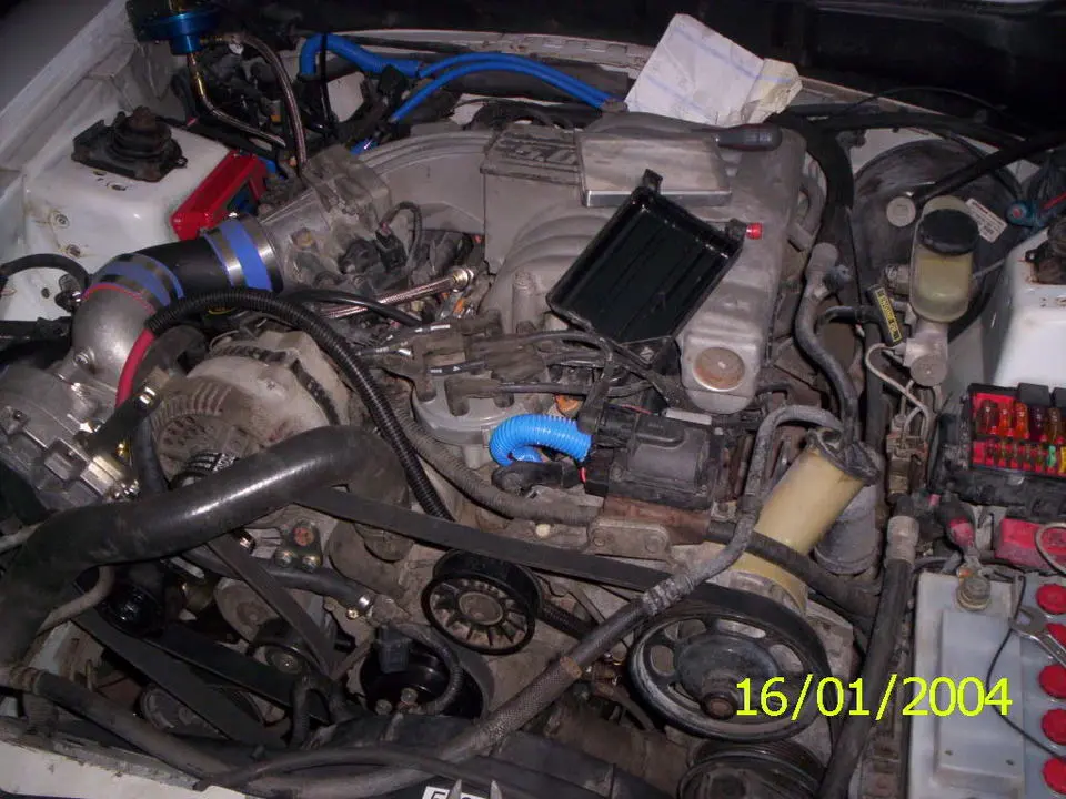

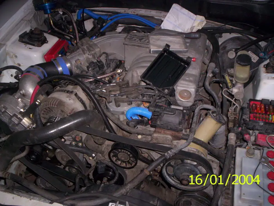

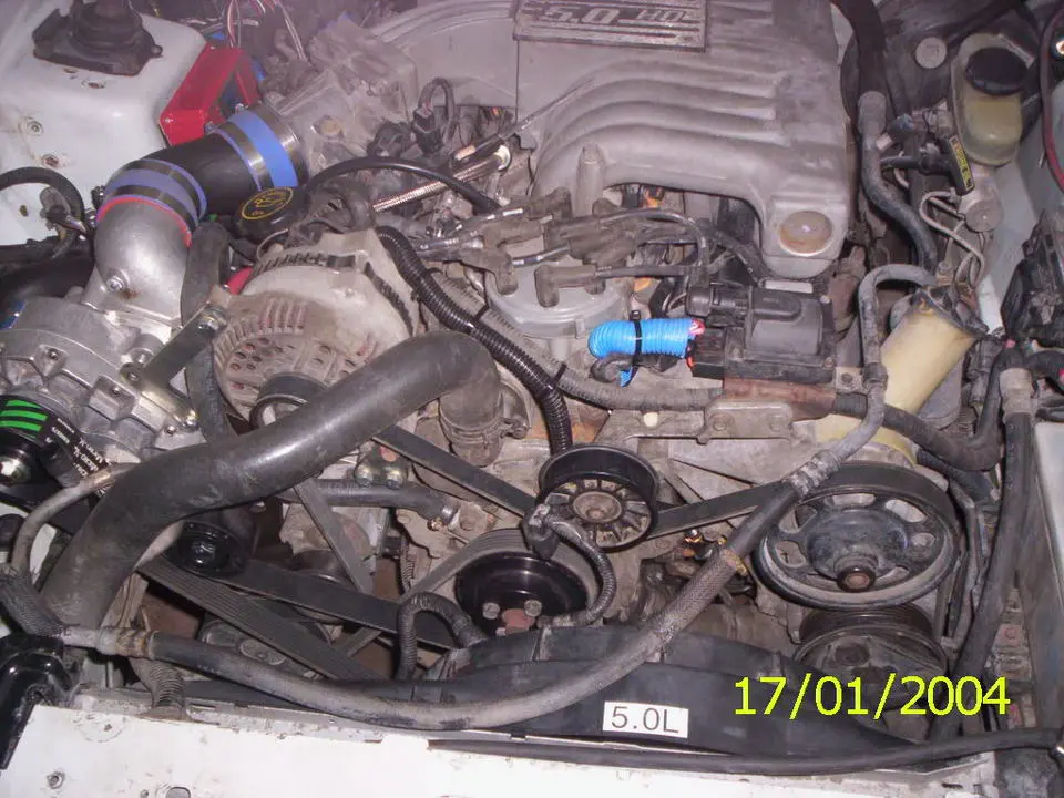

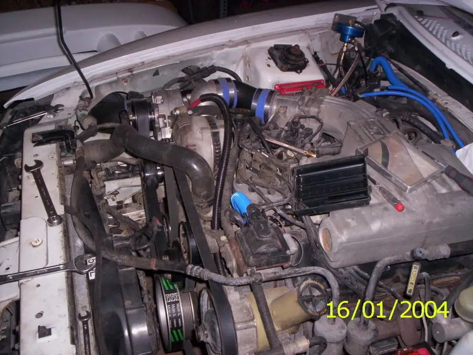

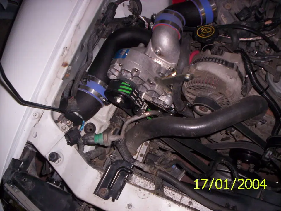

yeah I know it is dirty

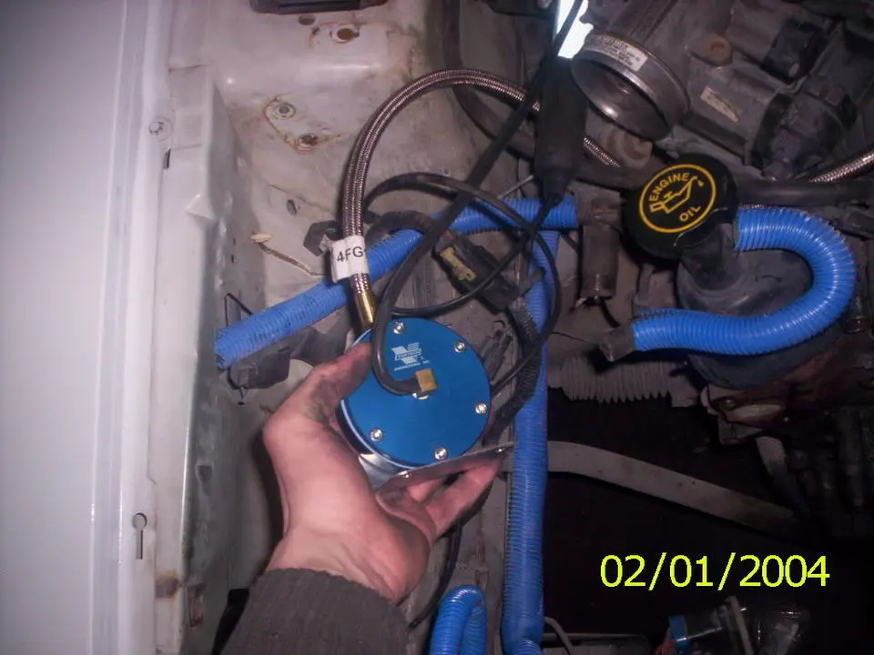

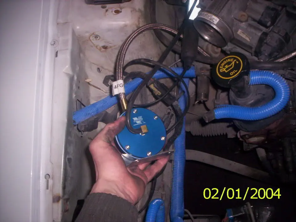

this is the one

No that a fuel managment unit. Read this and see it it helps http://www.stangnet.com/tech/injectors/fmu.html

ok I got this kit with the FMU. Shoud I swap it and put the one in the one I got with the FMU in? what is the diff?
