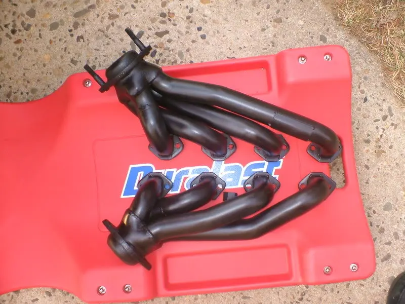

my bbk shorty's bolted straight up. they have the egr tube for the r/h header. the replacement egr tube was too short so i had to modify the origional one. got them from summit in mcdonough. if you have the dough DON'T get the chrome bbk shorty's. i did notice a SOTP improvement. the header you choose really depends on your budget as with the rest of the exhaust. just do your research and you'll be ok. if you want shoot me a PM and i'll give you more info on the phone

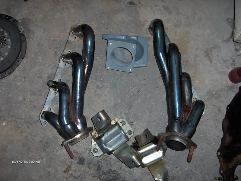

I dont recommend the MAC headers, there is no solid flange where they meet the block, and it has caused me many blown header gaskets and headaches over the past few years.

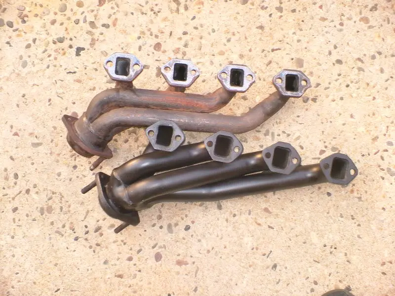

And if you buy them used they are always warped to ****.... my macs kinda sucked... my bbks had better fitment
