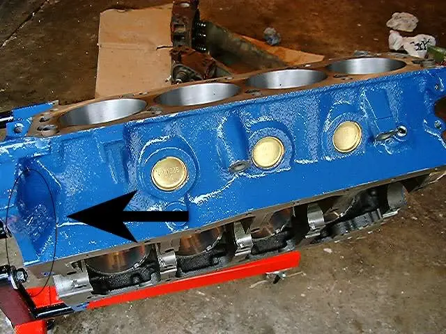

need help finding a vin number on block
ok i need help finding a vin on the block on a small block ford anyone know where it might be it is either a 289 or 302 it is an older motor but i need to find it so i can learn some more about my motor before i build it but i cant do it if i dont even know the year of the motor so help if you can

here you go. this should do it.

ford did stamp the vins on the block for a short time. I know this because my 68 block has the vin stamped on it at the rear of the intake manifold and that vin matches the vin of my car. I don't know which plants did this or for how long but in my case they did. another thing about my block is that the motor is actually a 289 but in a 302 block. In 68 when they made the switch they had a shortage of 289 blocks so they continued to install the 289s just in 302 blocks, maybe that had something to do with the vin stamping. Otherwise your just left with date codes.
