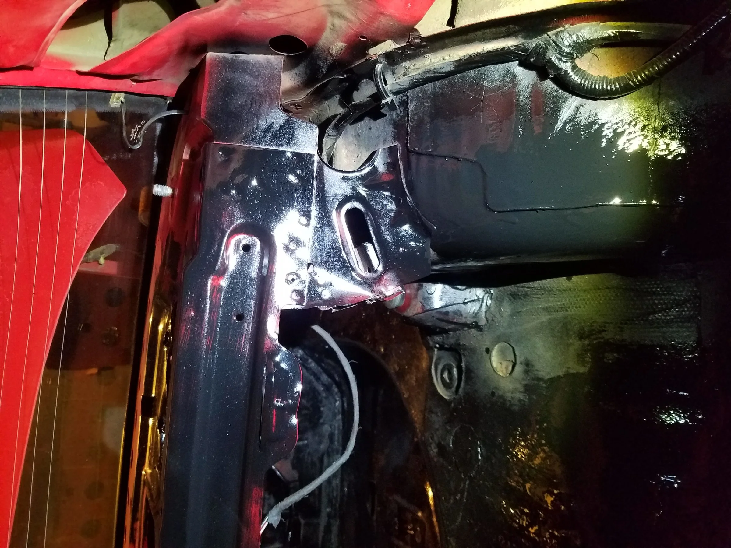

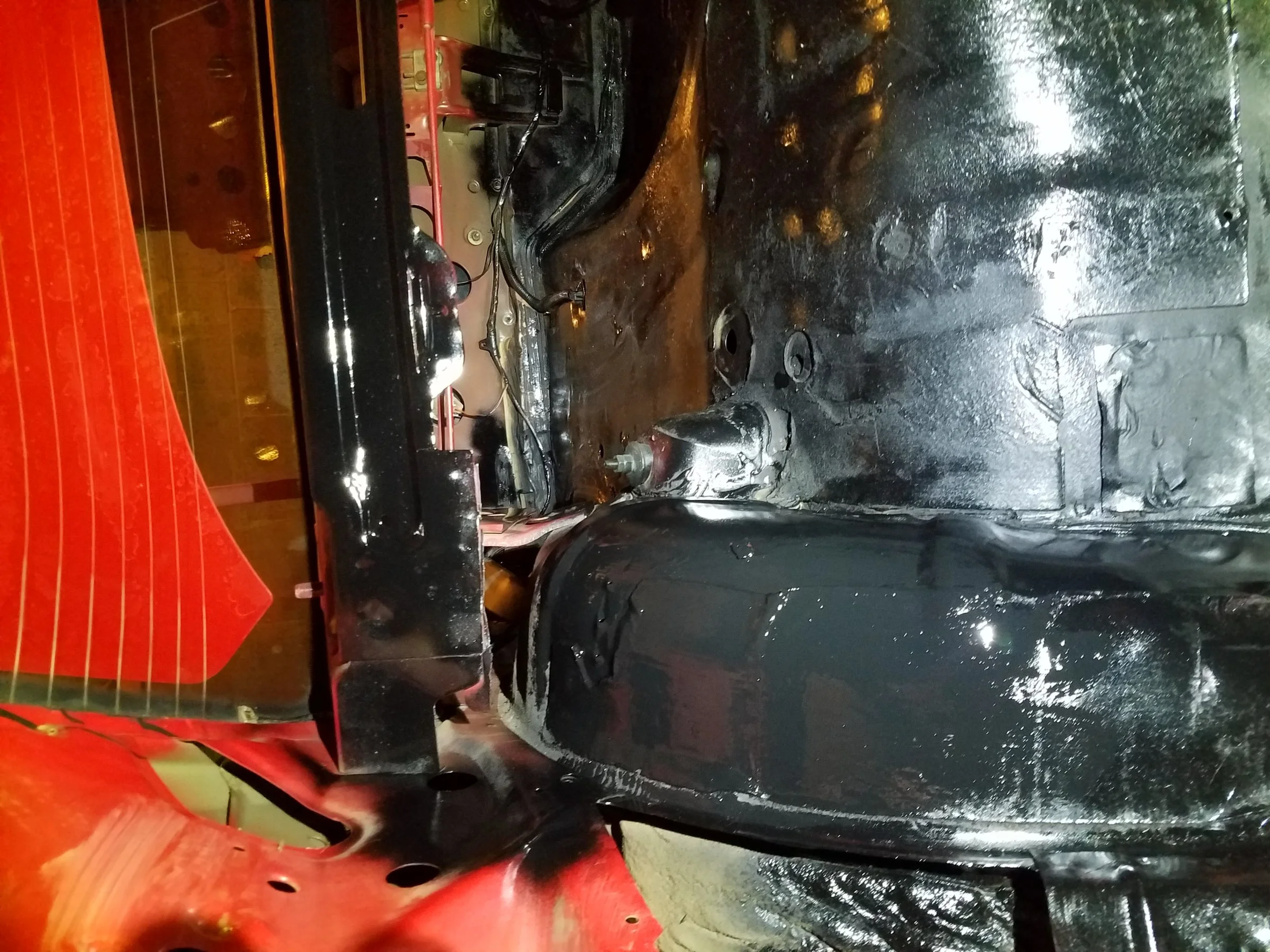

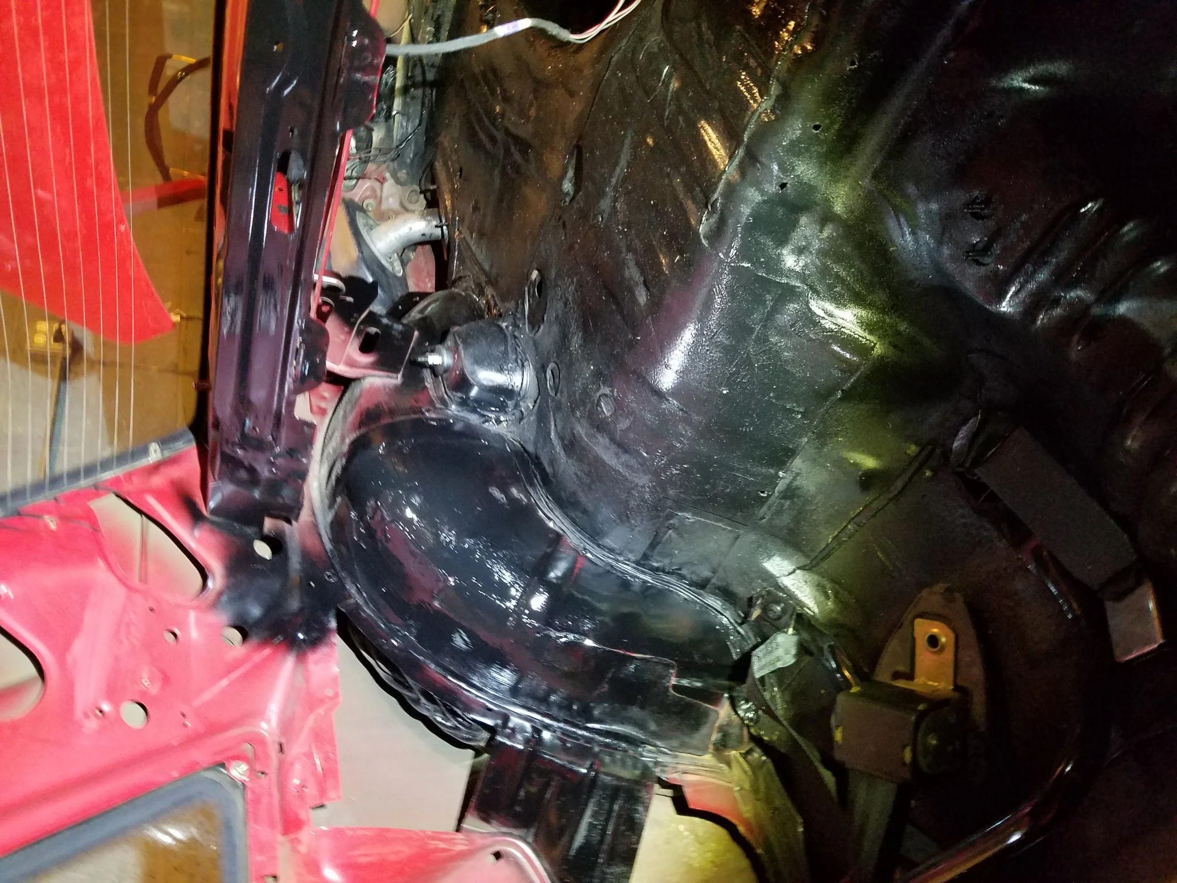

Recently bought a 93 foxbody notchback. I took everything out so I could paint the floor pans and also just to check over things. I noticed in the back over what I think is the wheel well there is a piece of metal that looks like a bracket above the right side but not on the left (refer to pics below). just want to know if I need to put a piece back on the left side and why would someone take it off anyway? Thanks for your help

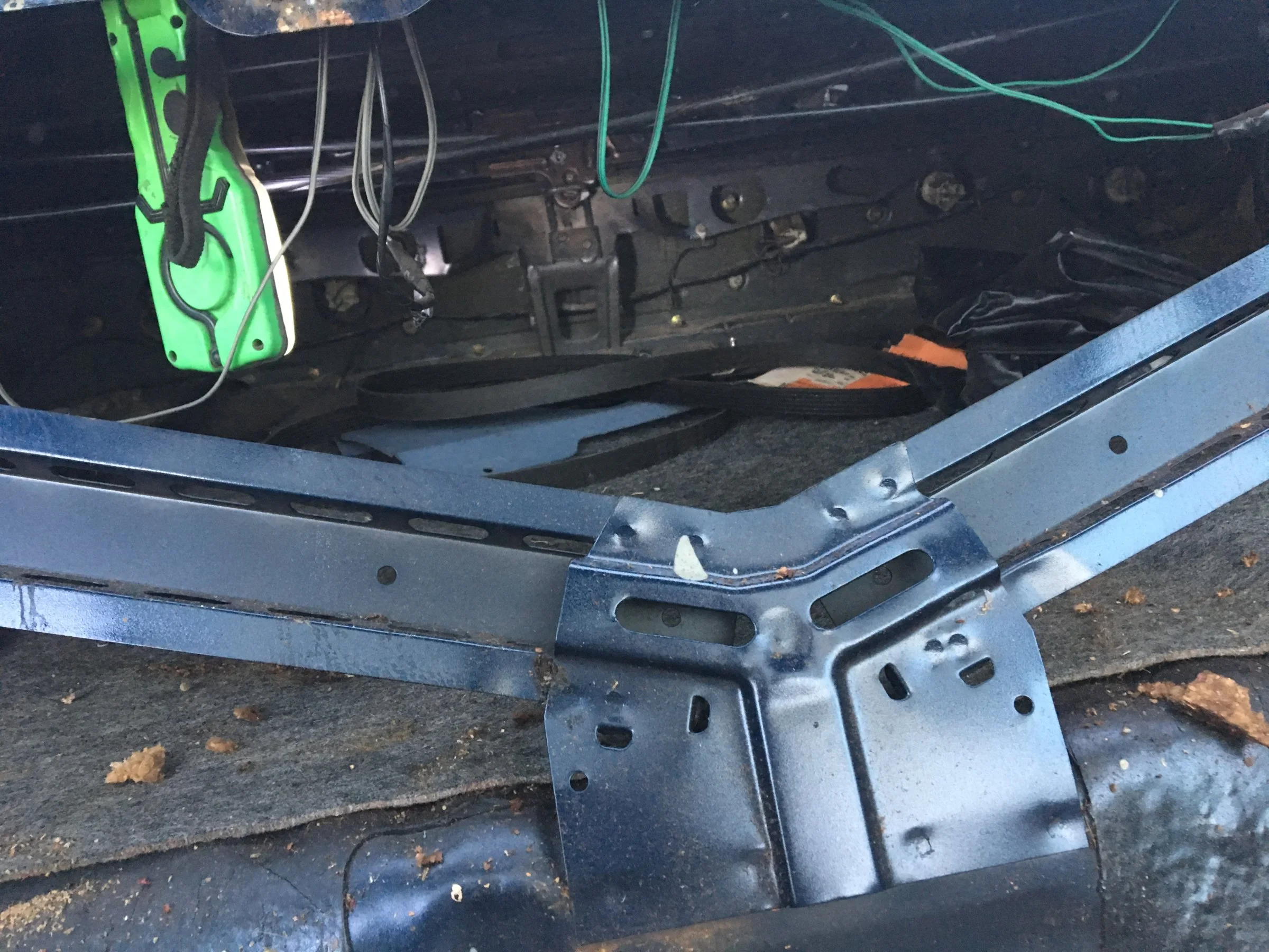

Here's my '83 coupe though, maybe someone else with a newer model could chime in. @TOOLOW91 ?
the best picture i have of that area is the center part of the crossbrace. It kind of looks like someone cut yours out for some reason?:scratch:

It helps brace the car's quarterpanels/sail panels and roof from sideways movement, integral unitbody structure, like when your on an extremely bumpy road all the panels work together in unison, also helps in side impact to rear quarters.
