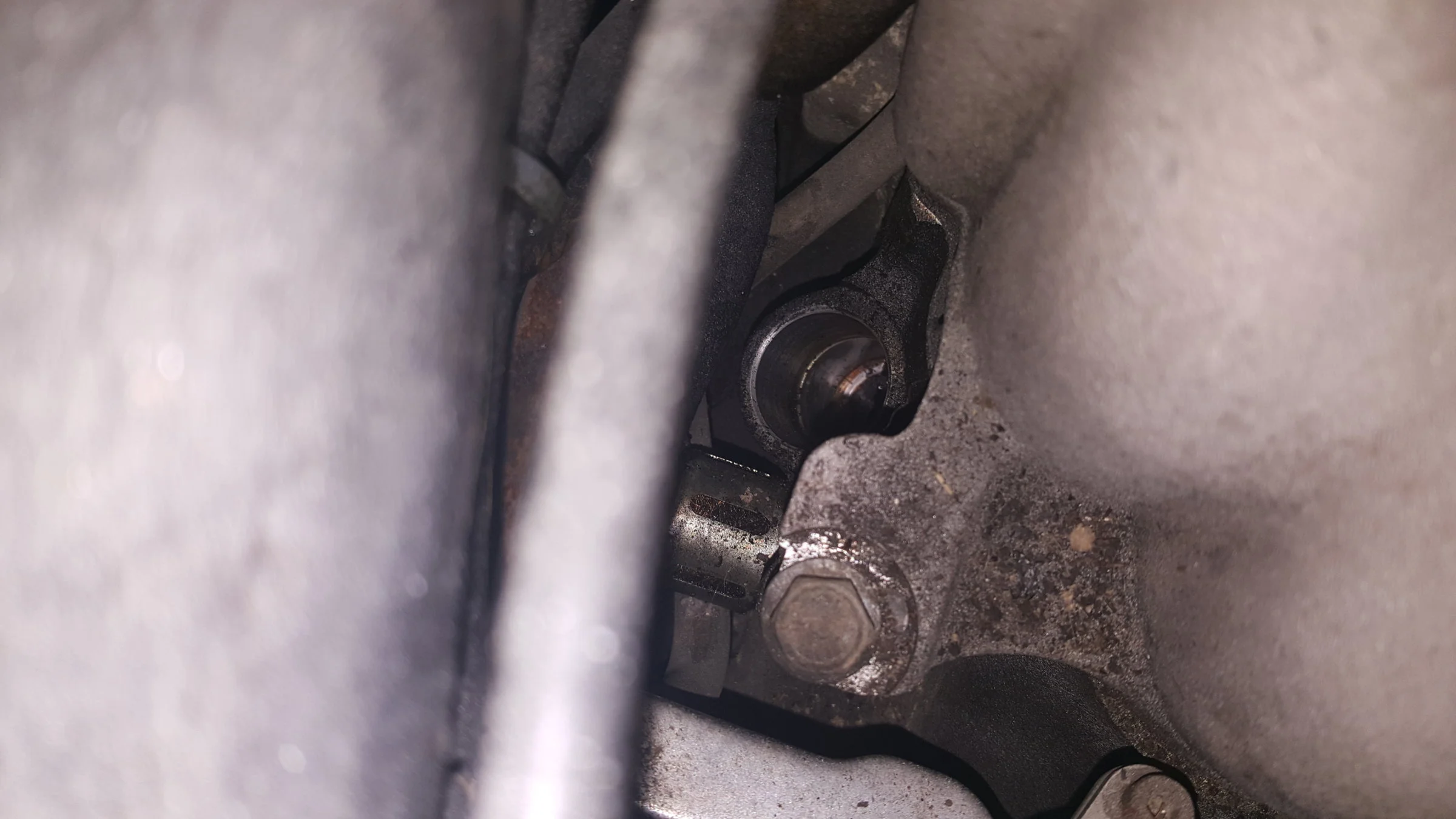

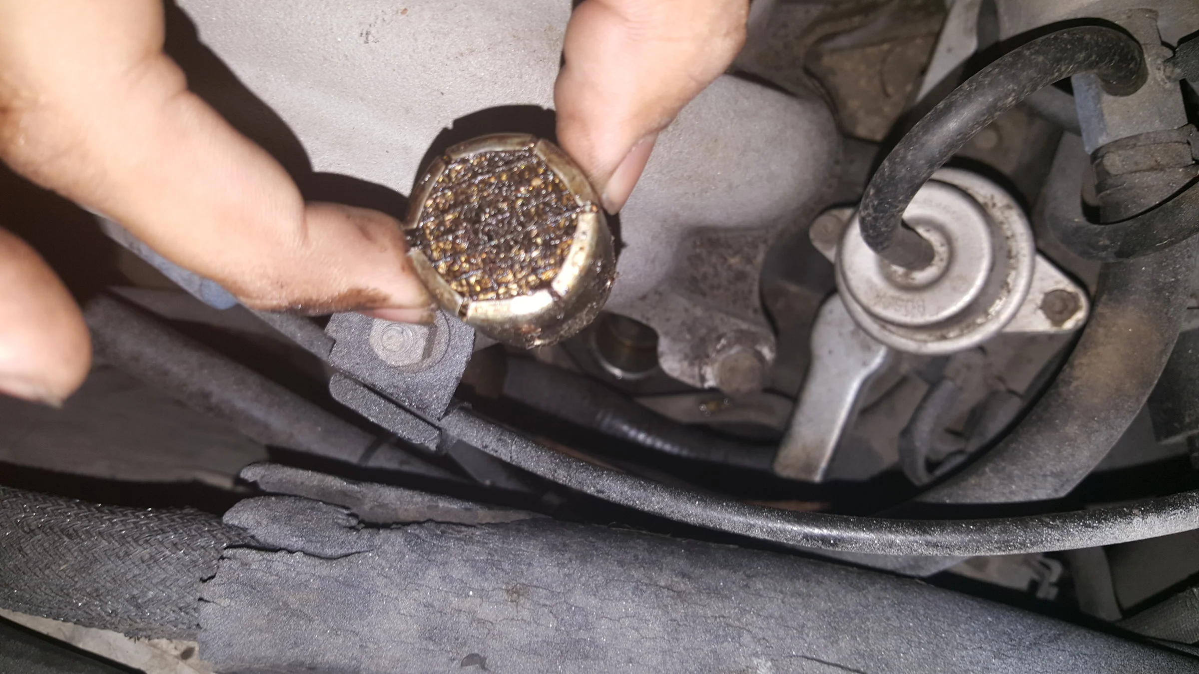

Hey guys earlier today I pulled my cobra from storage and started it and noticed their was thin smoke coming from behind the intake. So when I took a look I seen this.
Any idea what supposed to be there?
Any help is appreciated.

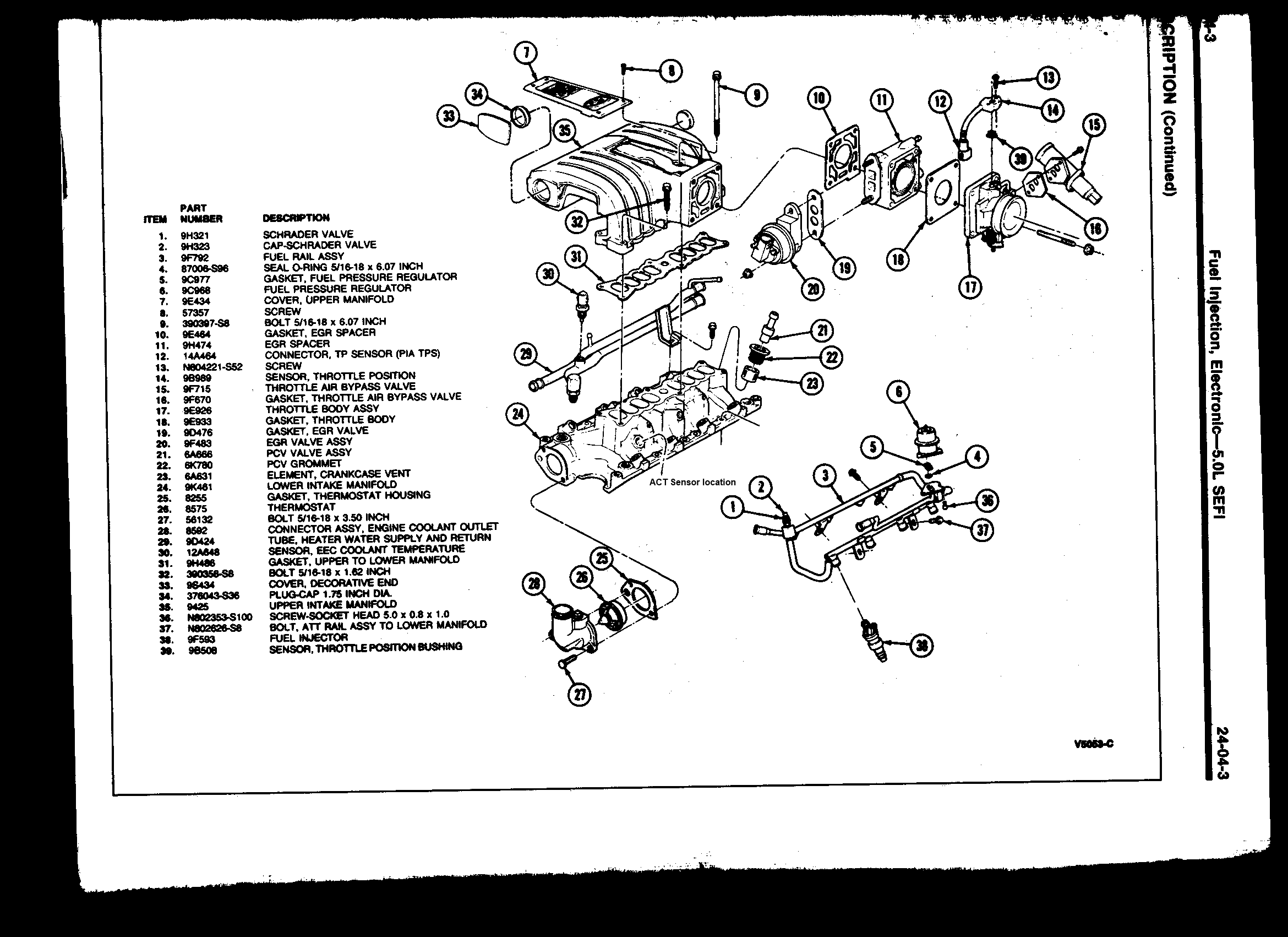

PCV valve & rubber grommet is missing...
The second item is the oil separator for the PCV valve.
