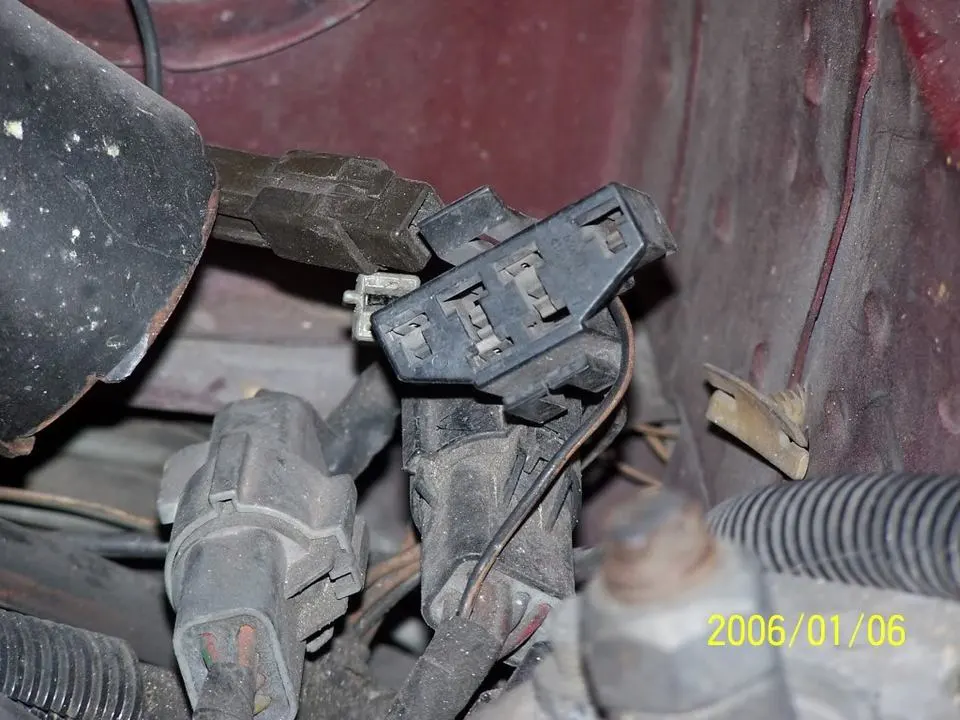

attachment.php
The STI has a gray connector shell and a white/red wire. It comes from the same bundle of wires as the self test connector.

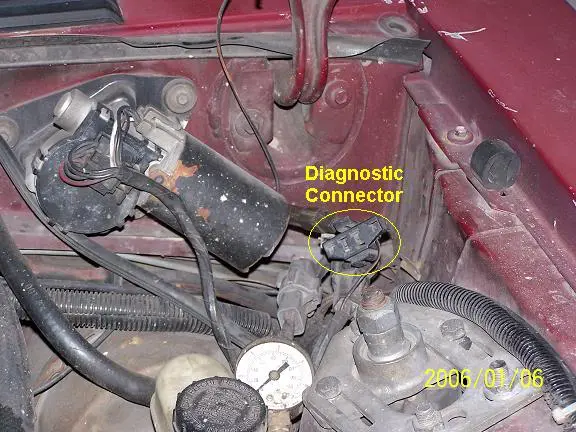

attachment.php
WARNING!!! There is a single dark brown connector with a black/orange wire. It is the 12 volt power to the under the hood light. Do not jumper it to the computer test connector. If you do, you will damage the computer.
