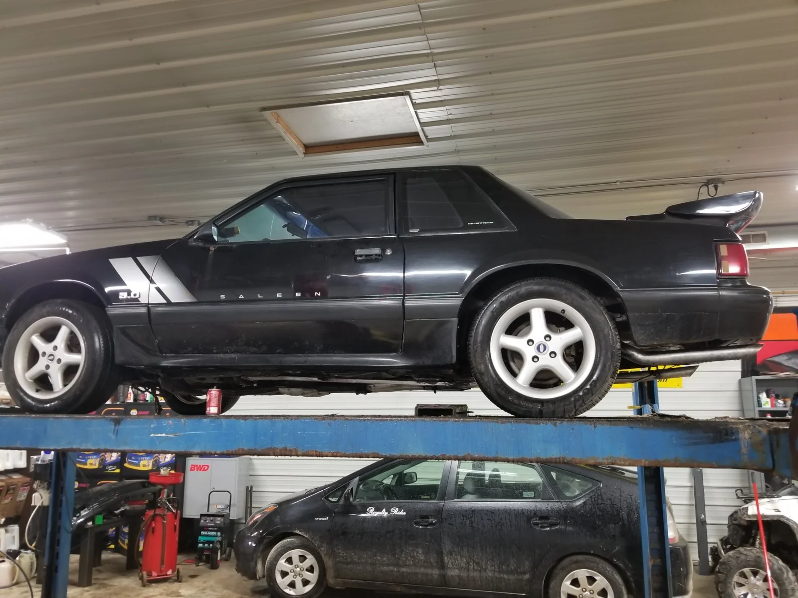

I've got an 89 notch and having some issues. 2 days ago I installed a megasquirt pnp computer. Was able to get it to connect to my laptop and everything was working great. Now I installed a new coil and spark plugs. I got in and the computer will no longer connect with the laptop. Even worse, I can hear the fuel pump run and shut off as it should but it will not crank with the key. Please help! It will crank if i jump the solenoid, but get nothing with the key. Thanks in advance!

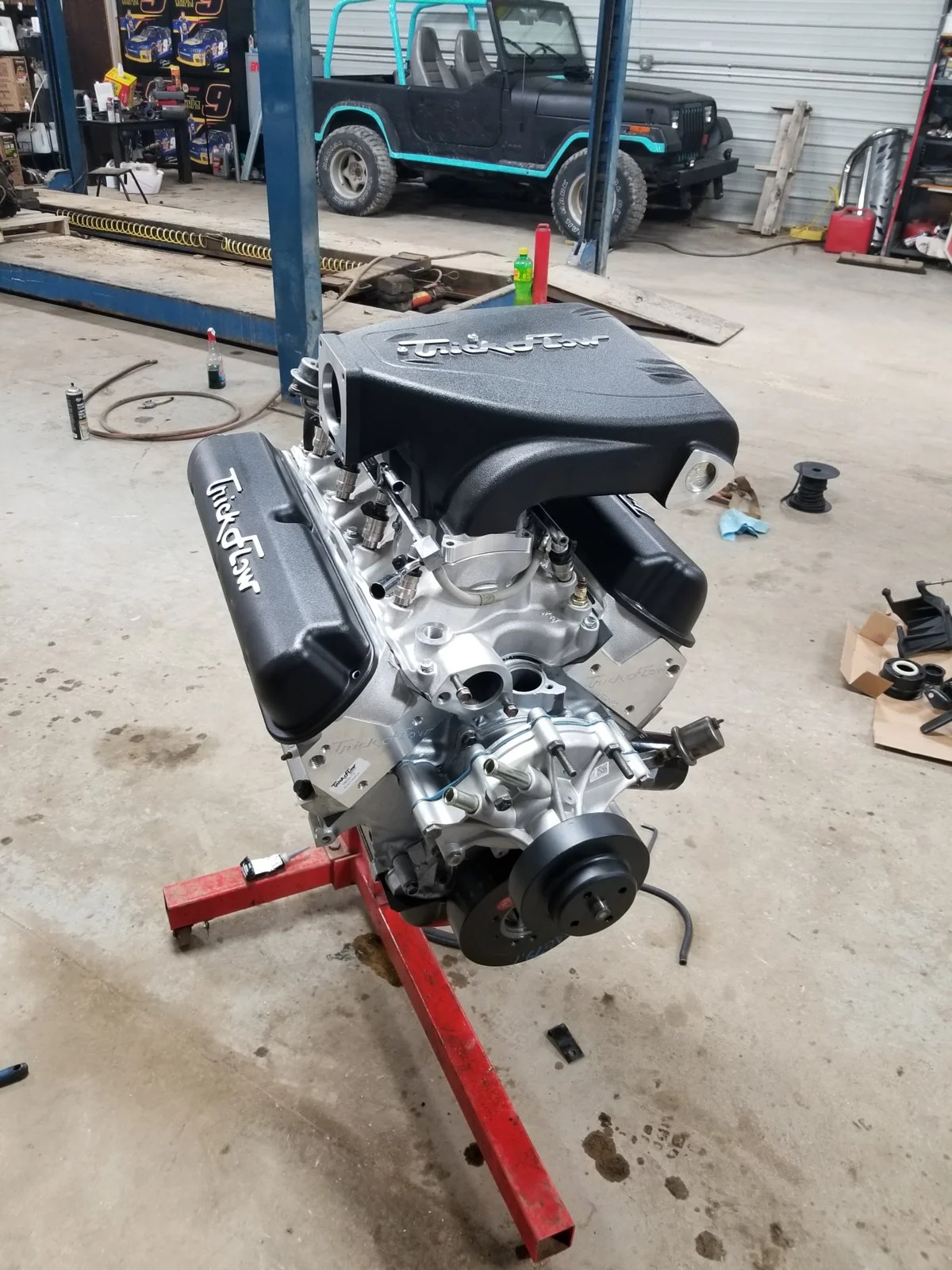

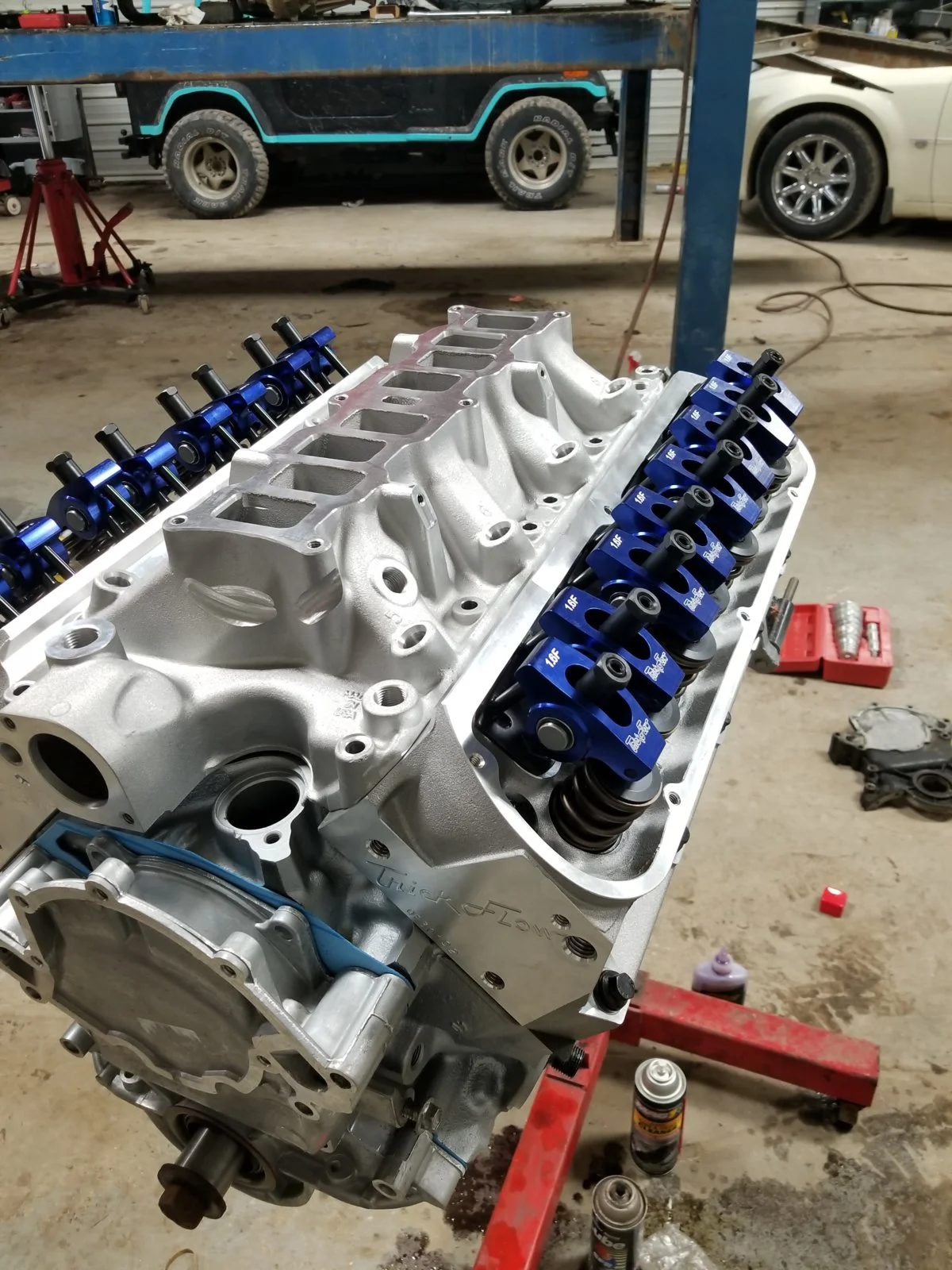

Wow! Thank you for the reply! A little more background on the car. I bought it in high school, drove it for a few years. Then I was shipped overseas right after 9/11 and parked it in a barn. Ended up with a wife and kids so with the other responsibilities I never got it back out. Well, here we are 17 years later and i finally have the means to fix it up. It's been a complete rebuild. 347 striker bottom end with a Trick Flow top end. BBK 75mm throttle body, 255lph fuel pump, 36# injectors. Amongst other things. Initially tried to start the car with factory computer and it would just flood out the car. Got the megasquirt computer a few days ago and the car cranked good. It also connected with the laptop as it should. Now I changed the coil and plugs and I get nothing. The computer wont connect with the laptop. The fuel pump primes the system as it should but nothing happens when I turn the key. Almost like the computer isn't getting power. Hooked up the old computer again and same thing. Wont crank. Going to buy an ignition switch this morning and see if that helps.
