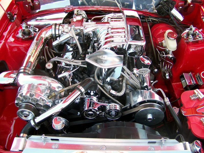

I have similarly-drilled valve covers on my car. Pass. side is covered (capped hole in faces the firewall) and the driver's side has the breather. I take the breather out and fill with oil using a funnel whenever I change it.
Pic:
If you put the 1" spacer on the intake, that'll raise the throttle body & linkage so I don't think that's going to be a problem.

ok what did you use to cap it with or what oil cap works?so one side is capped and the other is breather i assume that is just push in and not screw in right? i find caps with screw in style and breather...i feel mighty stupid for such an easy topic..i feel like im going to mess something up big time..i dont know what to search for since this a retorfit or whatever you want to call it

As far as the breather goes, well, I have a supercharger on my car. I don't see that you do based on your signature, so you might want to mimmick the stock setup as best as you can right? You could get that vent you posted from the Ranger or whatever it came from, and replicate the PCV valve from the stock application (you know, the tube that goes up to the top of the throttle body).
Or if you've eliminated that for some reason, then just cap 'em both and be done with it :)
Regarding length of the new bolts, I have no clue, but if you pull a stock one and add an inch to it...ta-da!
