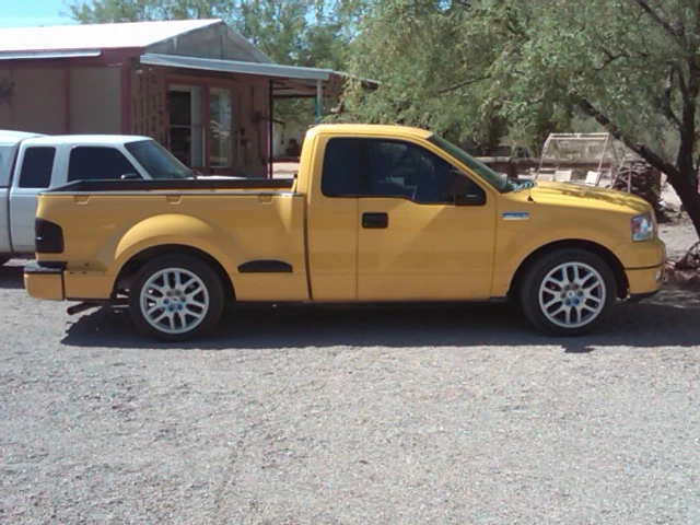

So if this posts again im sorry. I think i deleted the first one because it didnt post, i dont know if they need approval first by admin or not. Any way I have the 2004 F-150 with a 4.6(w) v2 that im trying to make in to a daily driver sport truck demon. however i dont have deep pockets to build up this 4.6 all at once or switch the block out. First I'm confused as to performance part for this motor. Is my motor the same as the 4.6 in the 99-04 mustang gt? im thinking if it is i want to install a centrifugal type blower since idk if they make a on the top of the intake type blower that will fit my truck. so since I have the heads off i can get to the pistons easy to build up the bottom end to support the blower, would this be a good time and would it matter if i run the block naturly asperated for awhile. thats if pistons are needed. also ive never done a cam switch so im wondering do the heads need to be out to replace them? So i guess im asking, If you can only remove the heads with the block out (pain in the ass by the way), and we all know the motor needs to be out to do pistons what would you do? like i said my pockets arent deep so this has to be done in stages and keeping the block out to do a build up isnt an option. If you have any more questions please ask, other wise thank you for your input

You should seriously consider taking your truck (which, by the way, looks great) to a reputable speed shop that works on, Fords, Mustangs in particular, and, specifically, has a lot of experience with the mod motor. If they have experience with the mod motor in trucks, that's a plus, but not really required since, as Nightfire indicated, the engines are pretty much the same. Your post gave me the impression that you've never built an engine, or, at least not the mod motor, and there is no shame in that, but it's not an engine that is simple and certainly not forgiving. The tolerances are very tight and it's ultra critical that they are accurate.
