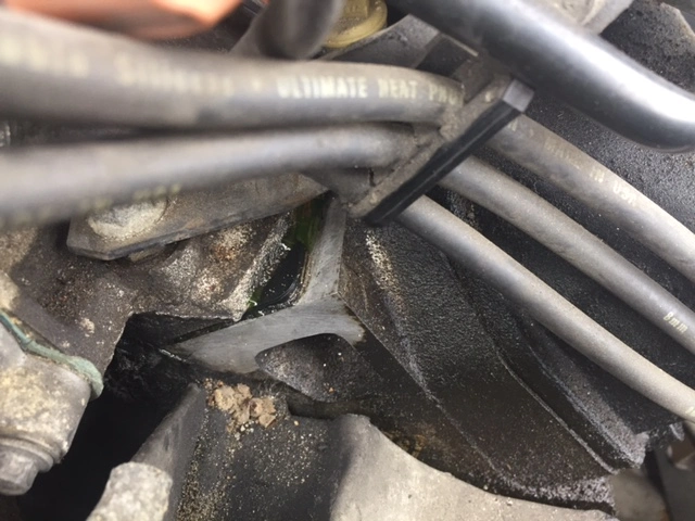

Thanks for the feedback. I finally got a chance to do some looking around today and I think I found the problem. I started off cleaning the MAF and I checked for vacuum leaks using the soapy water method. I sprayed around all the hoses, but didn't get any bubbles. There were one or two hoses that didn't look good so I'll probably replace them anyway. As I was looking around I noticed coolant where I think the lower intake manifold meets the cylinder head. I don't have any evidence that the coolant is mixing with the oil (no milkshake look and the oil doesn't smell like coolant). I plan on doing a compression test once I can my hands on a gauge, but I'm leaning towards bad lower intake manifold gaskets. I'll try to get a picture up to show where it was leaking.
Here the picture I took of the leak. This is the driver's side of the engine. The bolt in the lower left corner is the thermostat housing bolt and the valve cover is to the right in the picture. You can see the coolant just under the spark plug wires where the manifold meets the cylinder head. I though about trying to re-torque the manifold bolts to see if that would stop the leak and fix the idling issue, but I guess if it's already leaking, the gasket is probably too far gone. From what I've read online it's a pretty common issue on these cars. Any tips on replacing these gaskets?
