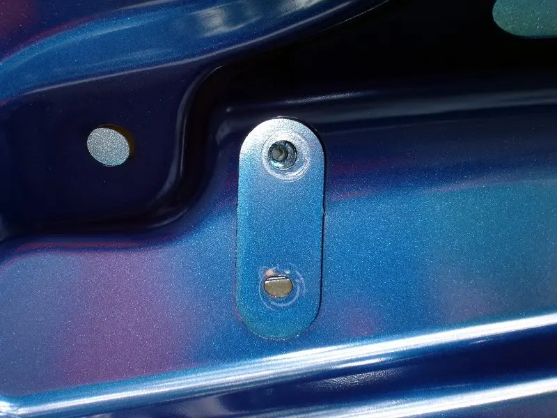

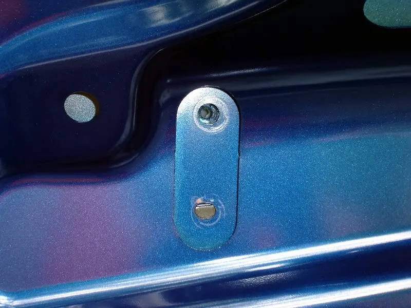

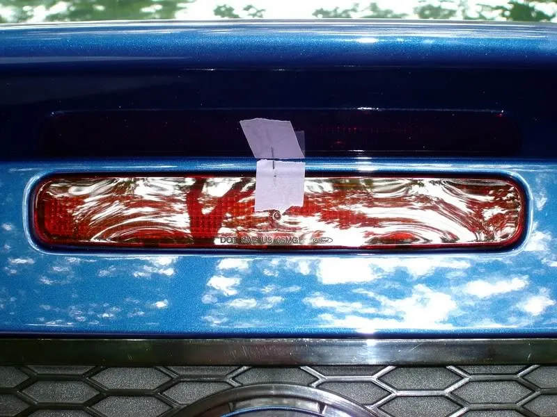

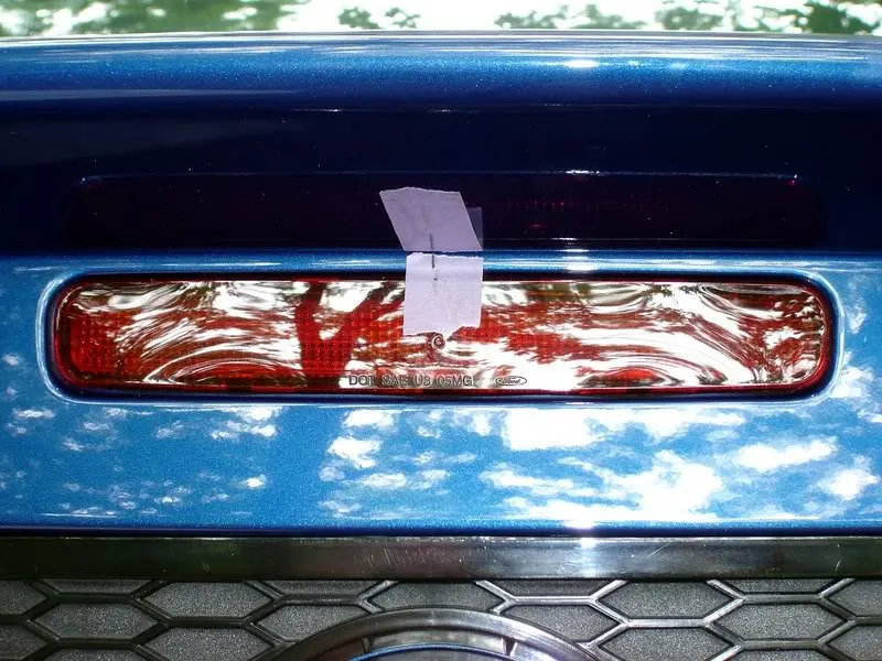

Test fit before even revealing any of the tape. The holes that are used are the ones closest to the back of the trunklid. I had my dad help me for final install. What I did to help align it on the "stick down" is I used purple painters tape to mark the center of the spoiler during the test fit. I used a piece on the trunklid and spoiler. I used a dot in the center of the third brake light for the alignment point. This made it easy to see where to line it up.
