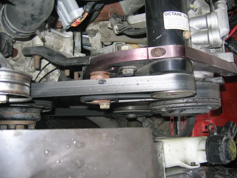

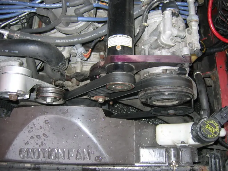

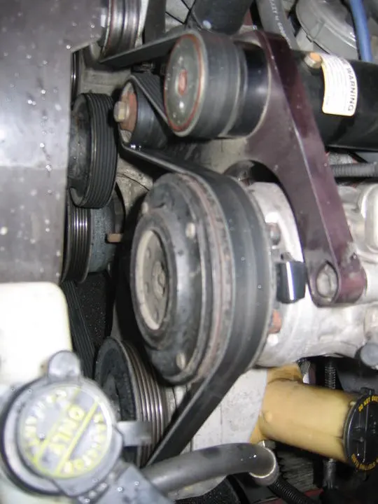

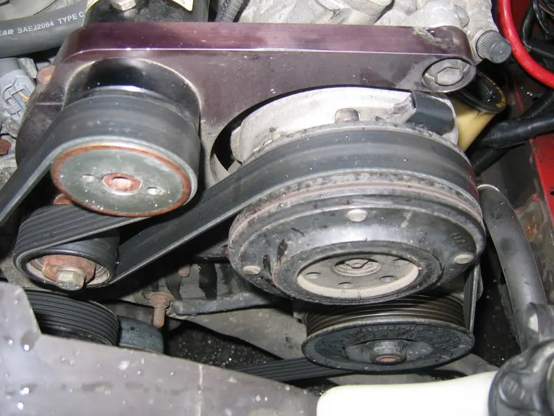

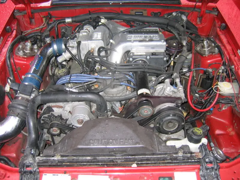

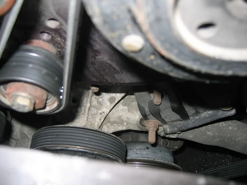

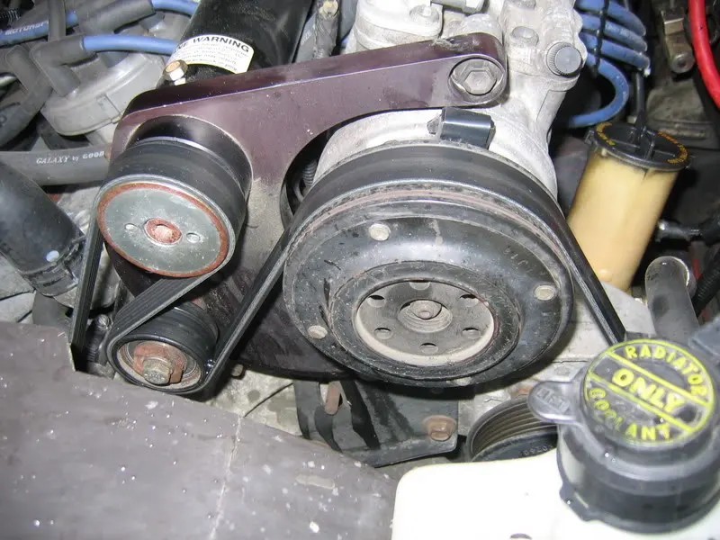

We are trying to install a Kenne Bell on a Lincoln Mark VII and we found out that we have to use the Mustang PS brackets in order for it to work. The problem we have figured out is how to mount the idler pulley to the KB bracket. Does anyone have any pics of their setup so I can see it. Advice would also be helpful. THanks
Are these of any help..?
