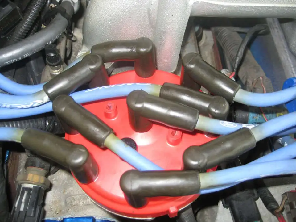

Yeah I can view PID's with it. Tell me exactly what to look for with it. I put the Ford Racing plug wires on it a few years ago, as soon as I get some money i'm going to get another set. I know on top of my wires near the boot that goes into the distributor it's very discolored.

Here's a pic of the wires

I would get it to miss and scan through your engine parameter readings as it's missing. Or if it only does it in bursts or while actually accelerating, drive it on a closed, safe course till it acts up. Then have an assistant do a data capture as it misses. Then go through the data and see if any readings look out of sorts.
The way the scanners do O2 readings, it might not show you if your right O2 is causing an issue, nor will it show you if plug wires are leaking, but it will help you to rule some things out (or might show you something that is acting up, like a bad TPS, etc).
