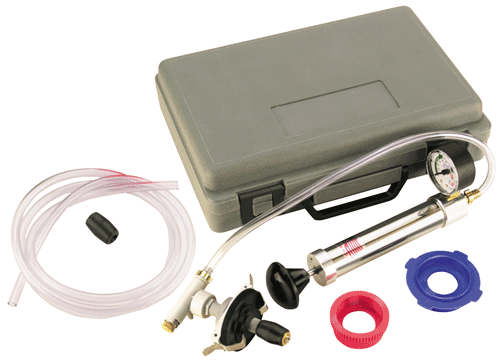

The coolant prssure tester is a hand operated pump with a hose and a radiator cap attached to it. You remove the cap from the radiator, and put on the cap that is connected to the hand pump. Pump it up to 15 PSI and watch for leaks.
This one is a OTC unit, but there are a number of companies that make them. A radiator shop might do test it for you for a few $.
