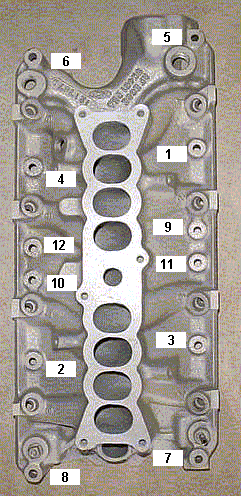

Reactions: Boydster

Big_daddy, I know my Cobra intake bolted right on but now im thinking that the last time I had it off I should have added the heads too.
