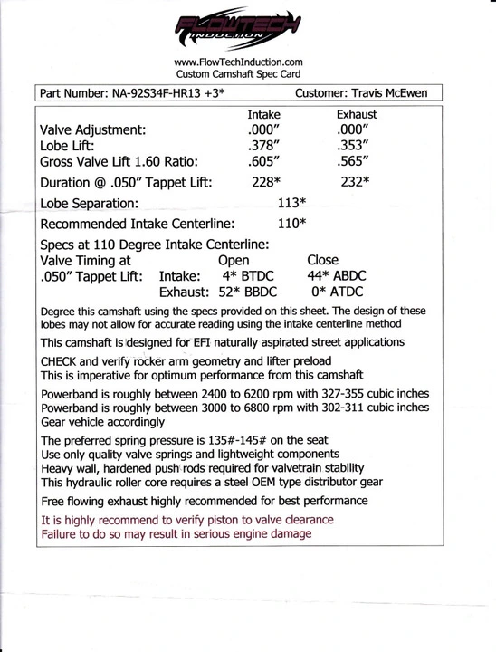

Here is the cam card its an FTI cam. On paper this combo should make a lot of power and I feel as though it does. Weight is just my big issue even though I have removed a lot ( rear seats, AC, have a tubular K member exc..) But I still need front runner wheels to go along w/ my Welds in the rear. 17X9 Cobra's are not the best for weight or ET's. Anyway here is the cam card and the rest of the specs of the engine are in my sig.
