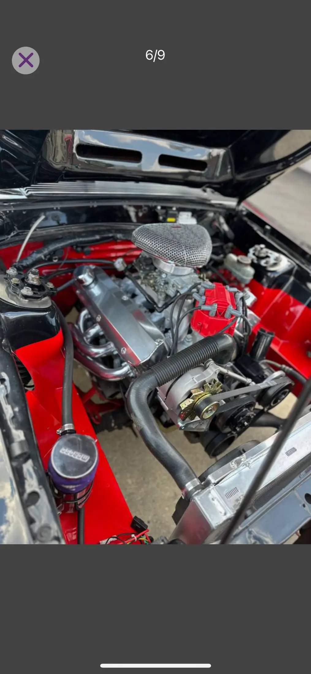

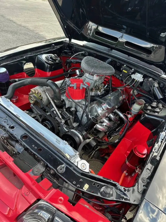

Hey everyone, I’ve got a brand new built 302 but having trouble getting the engine cooling properly. Getting close to 260° if ran long enough
Right now I have a 2 row radiator with 15” mechanical fan and shroud. However I don’t think this is enough. Can’t go any larger with the fan due to how my motor sits in the bay with the k member. I also suspect the water pump or engine timing may be part of the issue. Any advice?

you know. Same basic theory with electric fans.
They made water pumps that rotate different directions. If you use one meant for a v-belt setup with a serpentine belt setup, you'll spin it the wrong way and it wont pump any water.
