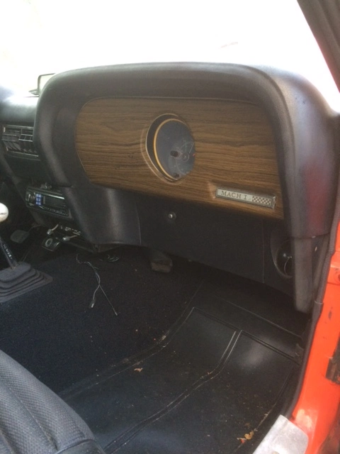

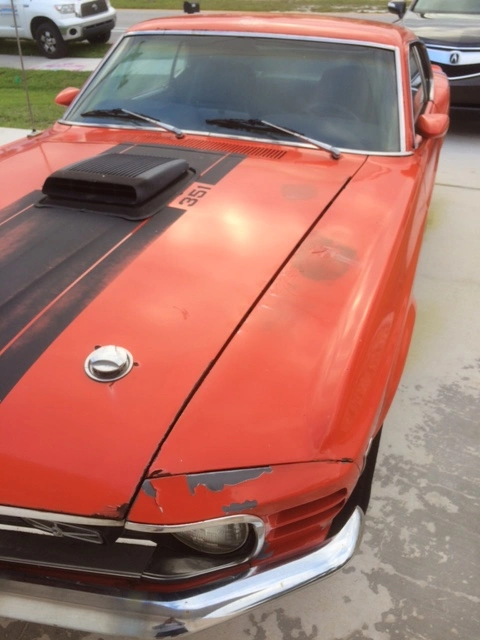

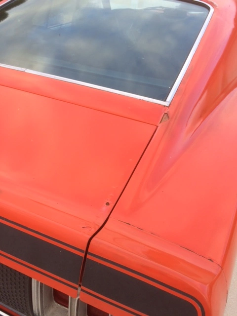

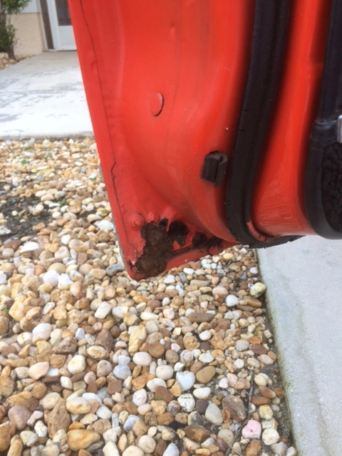

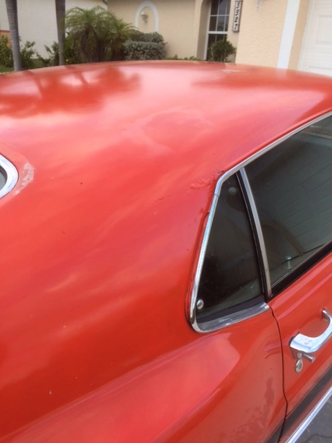

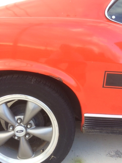

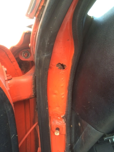

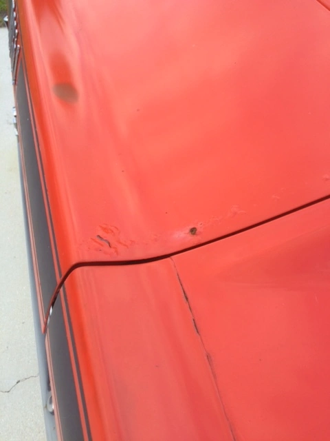

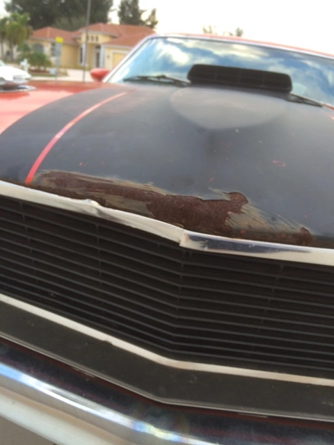

I am completely new to the vintage mustang world. I am an old fox body street and stripper thats been out of the game for about 10 years. Im looking at a 1970 Mustang Mach 1. I have no idea what the value is on this car. It has some rust here and there and the paint is not great. I need an idea of what this car would sell for on average.
Original color I'm told as well as an all matching numbers car.
Car has factory ac, power steering and disc brakes.
351C M code / 4v heads

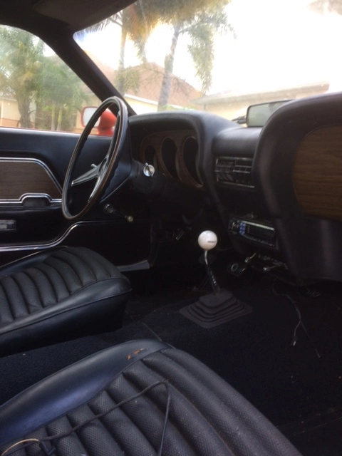

list of upgrades
  • Tremec 5 speed (still has original fmx and comes with the car)
  • wheels and tires
  • new carpet
  • ignition upgrade from points
  • aluminum intake and carb (still has factory intake but not carb)

The rot is in some bad / expensive areas ,i would lift the carpet because i believe the floors will be in bad shape .Look the frame rails over because they will probably be bad as well .Door post will have to be replaced more than likely as will the hood and trunk lid .Front fenders may be able to be patched but i believe there will be a lot of hidden rot in this one
Just from what I am seeing I wouldn't buy it. Unless they are selling it under 5k. Just know its not going to be cheap to fix.
