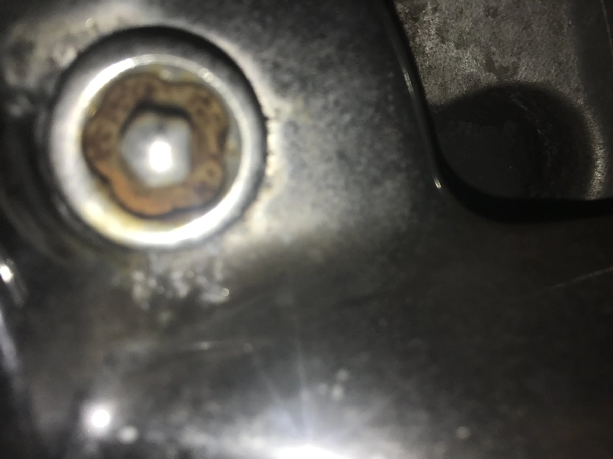

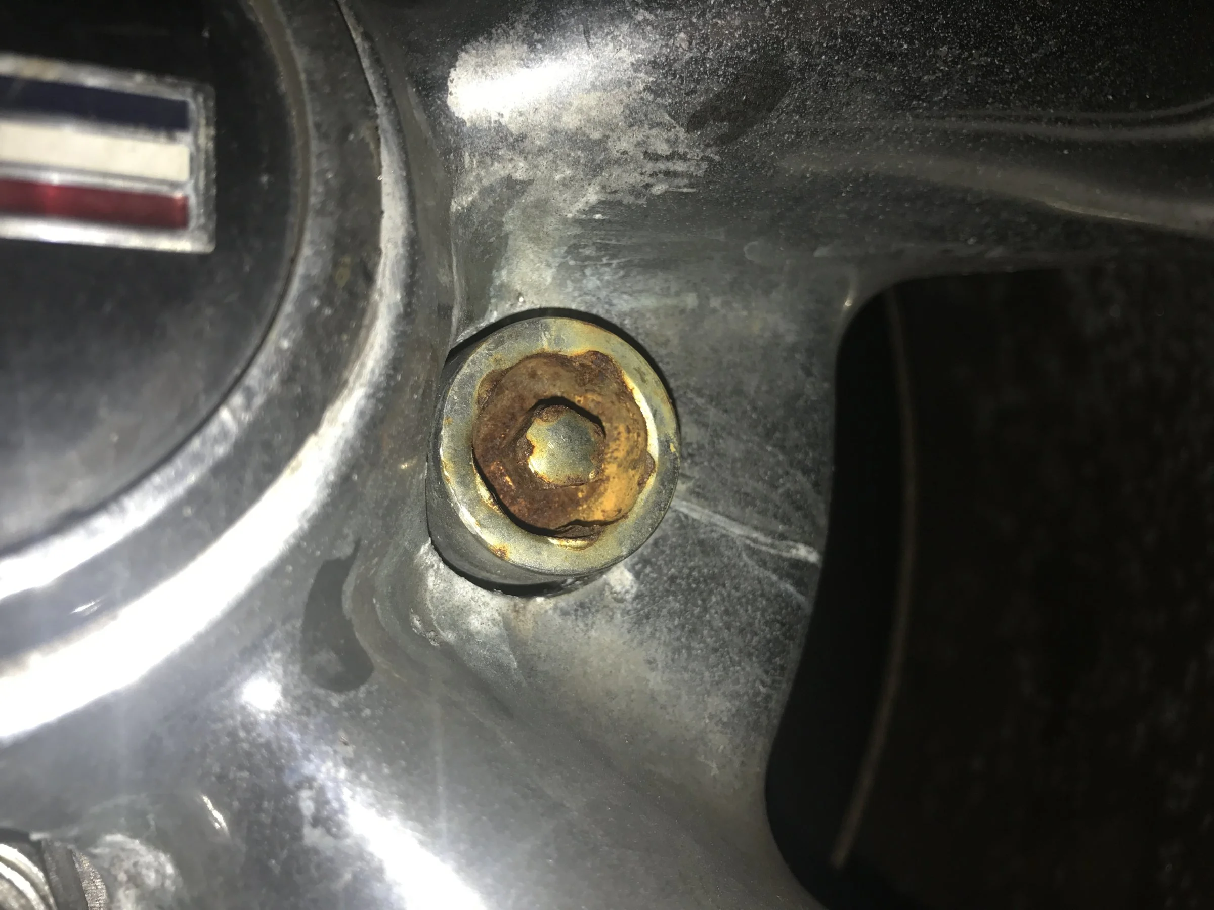

Good evening,
I own a mustang from 2007 , one time I had to bring it to the mechanic and they replace my wheel bold and put and wheel lock on it and of course I lost the key to take of the wheel.
I took a picture to show you guys and to know if you could help me , maybe do you know what kind of key it is ? And if yes where can I buy it?
Thanks
Find a beefy 12 point socket that is just a bit smaller than the wheel lock.
Use a heavy (small sledge) hammer to evenly force the socket of the lock.
Use a breaker bar to release the nut and socket.
Reclaim your socket and throw the useless set of locks in the trash.
This is how secure they are. You're better off using regular ole lug-nuts.
