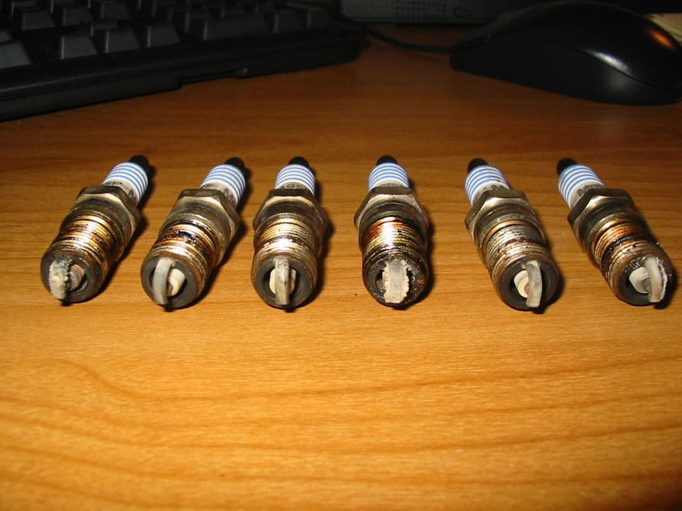

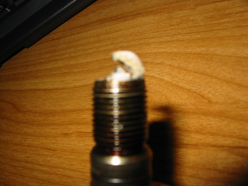

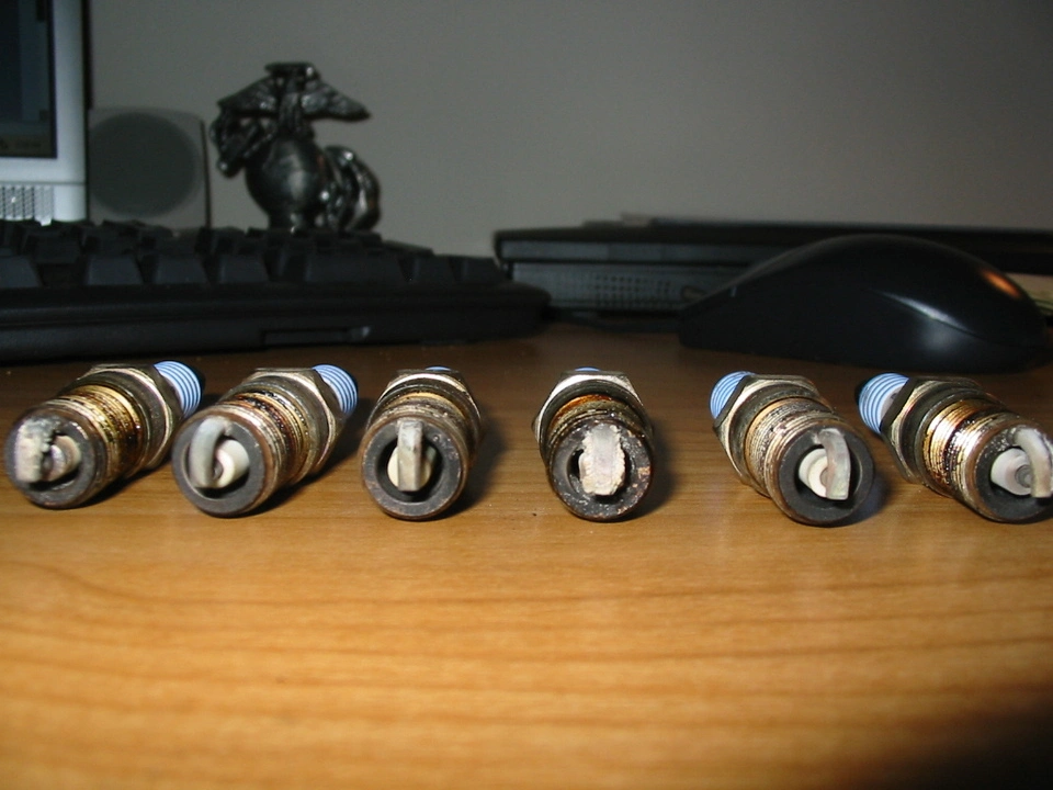

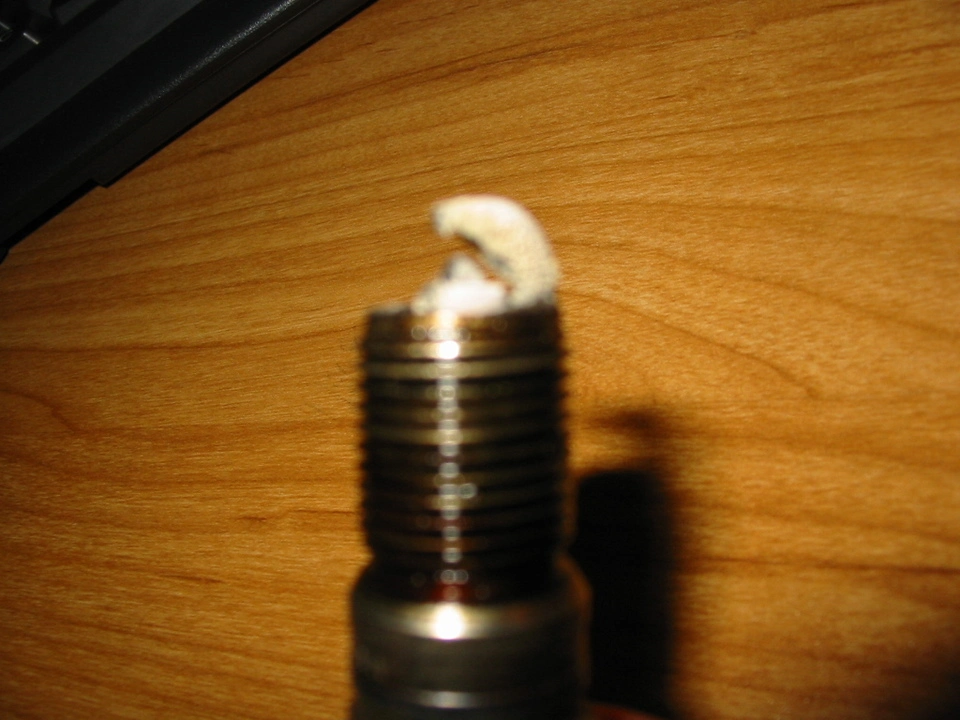

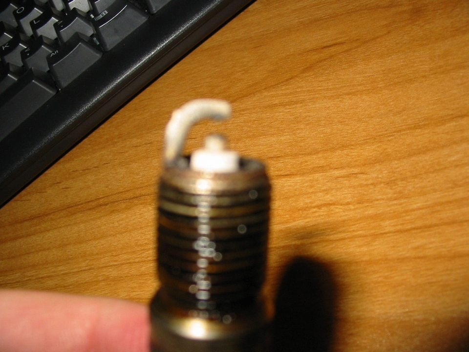

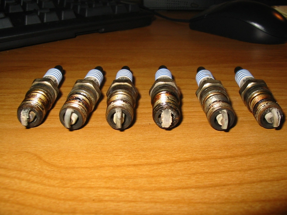

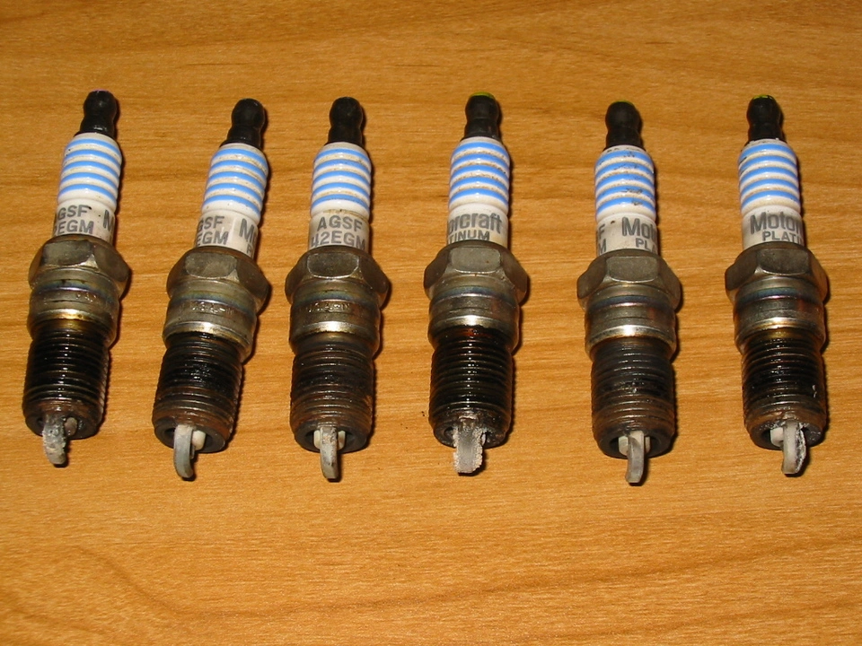

All six plugs from left to right is Cylinder #1 - #6. The most fouled one with light brown ash is #4 cylinder (Front Driver Side Cylinder) and the next most fouled one was the #1 cylinder (Front Passenger Cylinder).

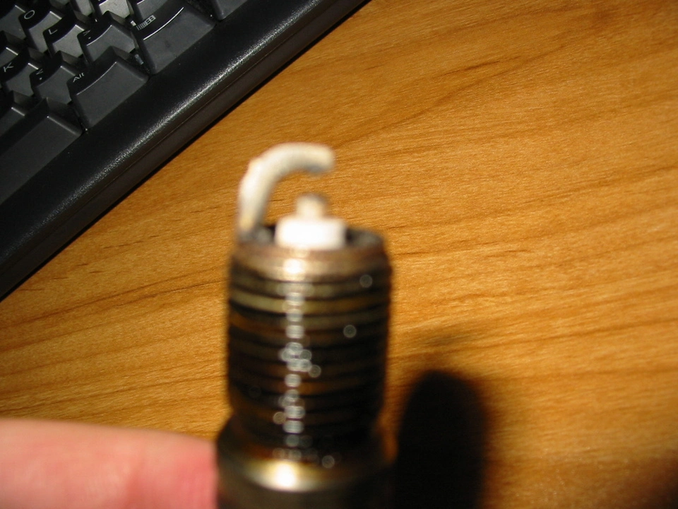

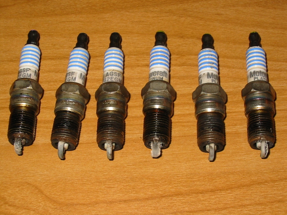

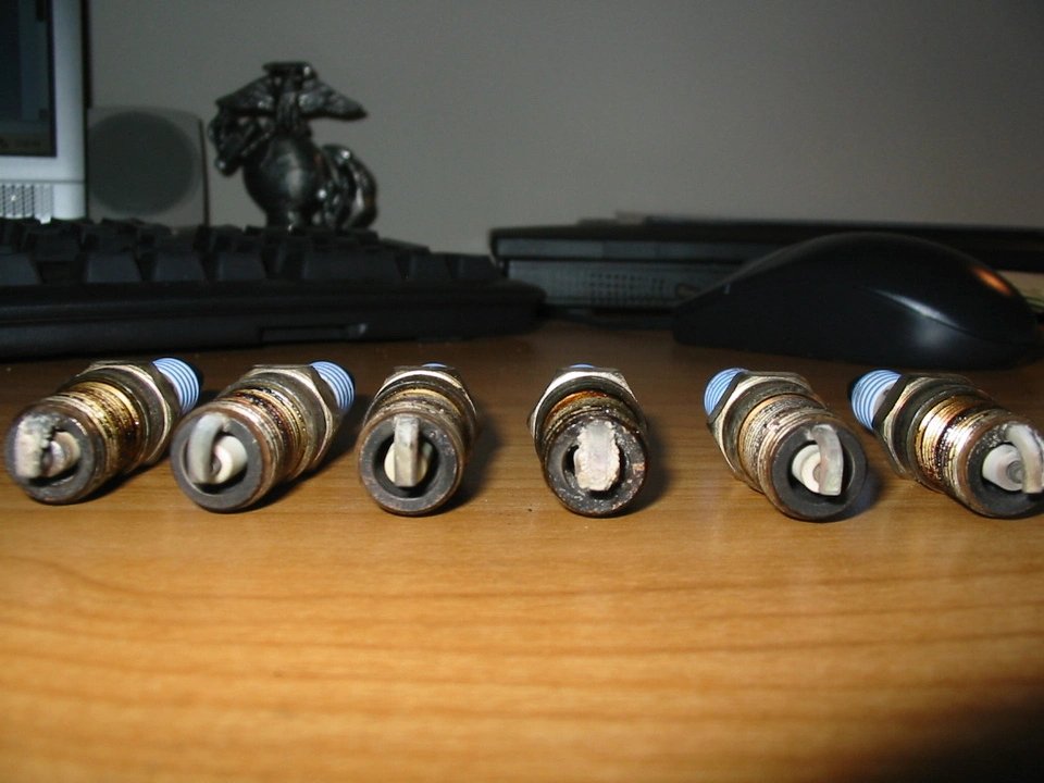

Another shot
And another Shot
Cylinder #1
Cylinder #4

It's possible that something on the intake could be vibrating against the side of the chassis.Different engine speeds create different vibration patterns,and this also depends on the condition of the engine (Gaskets,Seals,PCM sensors,Motor/Tranny mounts,Clutch/Throwout bearing in Manual trans,Mechanical and also vacuum hoses).Now,when my car idles (96-V6),there's not too much vibration going on throughout the entire RPM range.And this is only after it's been running for a few minutes and coolant temp is low.Now,if it's been running for awhile,say 25 minutes and the temp was up a quarter to allmost half way,it had a slightly bit more vibrating to it at idle speed (730 RPM) but it still seemed smooth..At this time,if I throttle the engine up just a notch to about 940 RPM,it shakes quite a bit like it has some sort of running issues.And what is really weird is it only does this at PRECISELY 940 - 950 RPM.The RPM Range after this to Rev limiter is quite smooth.
Don't know if that's typical with 3.8's.What I would try,and this works very well.Wedge a long pole,such as a broom or mop handle between the brake pedel and the drivers seatback or wedged underneath on the back of the seat frame.A short length of 2 X 4 works best.Now you can go under the hood and check out that noise you are hearing.
If you still can't figure it out,maybe record a short clip of it in MP3 and post it here.
As for Cyl. 1 & 4,I would most likely guess that the fuel injectors for these 2 Cyl's are partially clogged with some deposits thus becoming a lean mix.The only other thing I can think of is sticking valves but that would be highly unlikely with the very low mileage you have.Then again,if you never had the injectors cleaned or shot any carb cleaner (Intake spray) through your throttle body,it's possible there may be build-up deposits...then again,this goes right back to the partially clogged (Or sticking) injectors.
