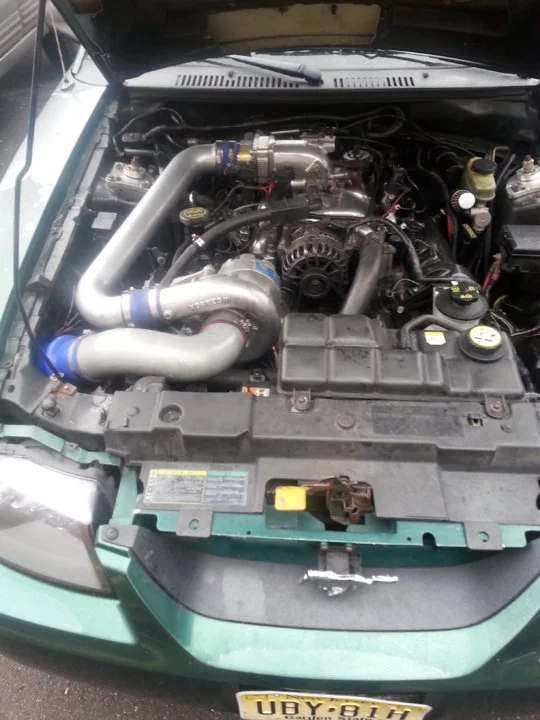

LOL, here is my 03 GT with the Typhoon and supercharger!! Pretty sweet lookin!!
You say you went back and forth between the stock and the Typhoon....was that before, or after the blower? Since you're recommending it to everyone, I've got to believe you ran just this intake alone and saw worthwhile gains for the money....so what were they? I'll be whatever they were, they were placebo. The SOTP meter lies....the dyno doesn't.
It isn't all forced induction or bust with the 2V engines.
Hard to sell that line when you yourself have got a Vortech sitting under your hood. Welcome to the 5% club. :D

When I went back and forth, it was when my car was NA. I was diagnosing some problems and it turned out to be my Accel coils...which ended up in the dumpster. But once it was all figured out and I had the stockers on, I still had the stock intake manifold on. And although this isn't a legit test, a friend and myself did several roll-ons, me against him. With the stock intake manifold, he was slightly pulling on me. Once I put the Typhoon on, it had reversed and I was pulling on him. Mind you, this was in the same day with no changes other than my intake manifold, upper plenum, and TB. Even the cai and tune was the same. Like I said, it isn't a legit test and I consider it to be unofficial but those were my results nonetheless.
And yes my 03 GT has a blower on it. My 02 GT does not. But that does not invalidate what I'm saying. I put the blower on because I wanted it to be fastER. These days 400 to the wheels is entry level for playing around on the streets. And the only way to get that without spending an arm and a leg on older cars whether it is a 2V 4.6 or a 350 LS1 is with forced induction. But these days everyone needs forced induction. And even tho my 03 GT has a blower and my 2010 Camaro SS runs 12s, my 02 GT still has some good pickup. It is fun and pretty quick and sounds really good.
