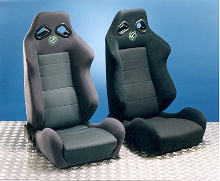

Corbeau TRS seats are approx 25lbs vs 55lbs for stockers. (50lbs savings right there) and are extremely comfortable with excellent thigh & side bolster support and run about $650 per set, plus come in many variations including wide versions for large men. the rear seat delete is worth about 12-15lbs I believe total.

Actually, $650 is pretty cheap when you consider the quality & comfort of the seats. I got mine for $600 :D out the door & shipped for the *Wide* versions which sell for $750+ tax + S&H now.
They are cloth. I'm sure you can find other models of seats for cheaper. There are quite a few people on here who have these seats.
Heres a pic
