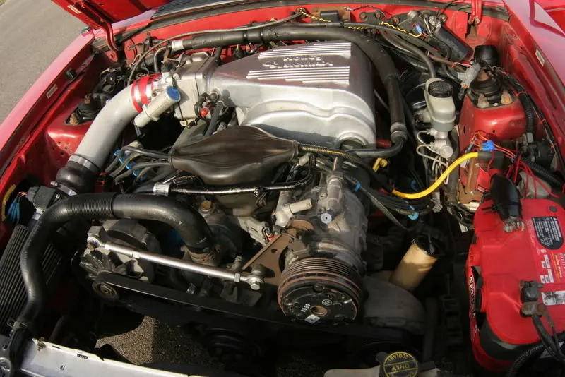

i dont know the exact size but after taking the s/c off i needed a shorter belt and went through 2 differant sizes at auto zone b4 finding the one i needed laying around my own garage.. heres a pic i had to push the Alt; further away to make it work this summer im either taking the A/c out or buying the right belt

I have always used the masking tape method. Same as the string method mentioned above, but i started that when i heard that when using the string, it goes in the grooves of the pulleys and can be about 1/2" off of your measurement.. :shrug:
Yeah that's true....i'd say you're right the tape would probably be a closer measurement. I've even cut the old belt since it was getting trashed and was too long, and then measure the belt itself since it's already in the grooves.
I will say though, unless your car is a show queen or something, get a marker and write the belt size somewhere inconspicuous in your engine bay, that way the next time you need a short belt, you've got the info right there, because the print will wear off the belt.
